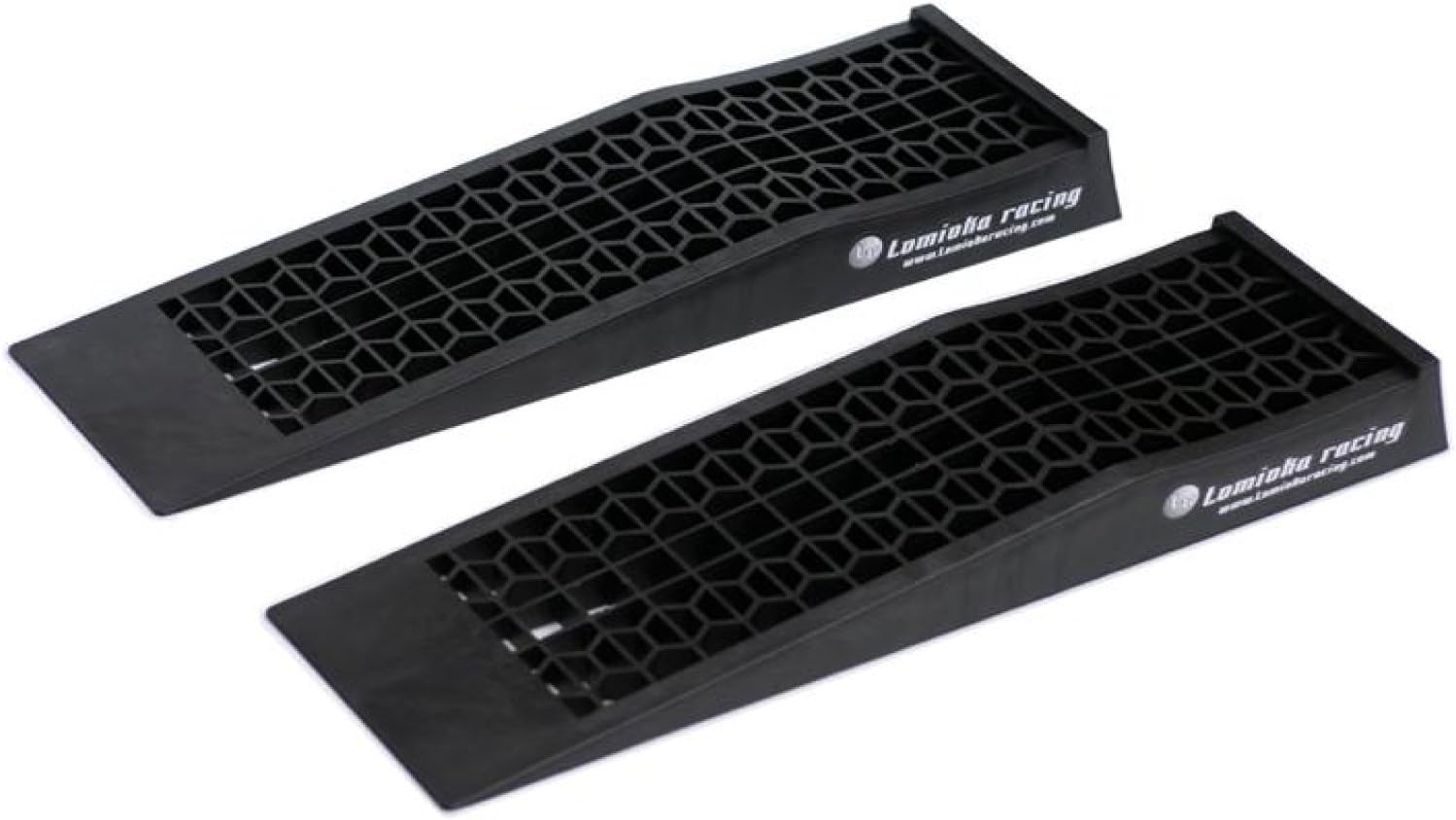

I use four of these low profile ramps to get the car off of the ground enough to do any work. Up on the ramps and then jack the car up to put it on jackstands. You won't need them for stock height but if you lower the car, they're a life saver.
Tomioka Racing Super Slopes - Low Profile Car Ramps ($70/pair)
https://images-na.ssl-images-amazon....AC_SL1500_.jpg
Exhaust is totally doable on jack stands.
https://live.staticflickr.com/65535/...d3c14dc5_b.jpg
