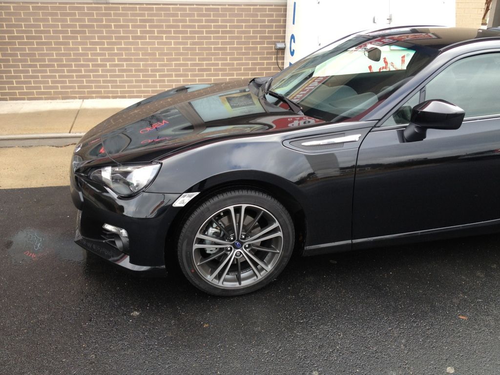

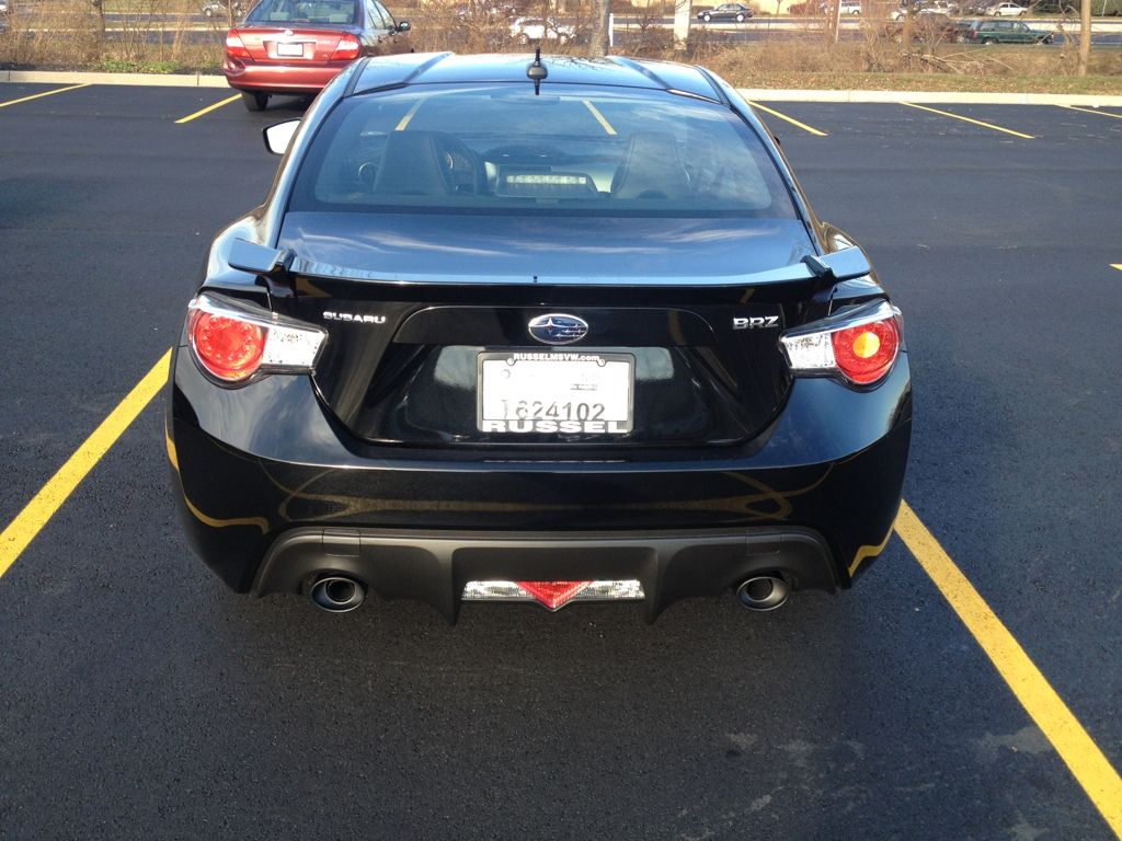

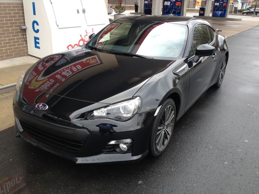

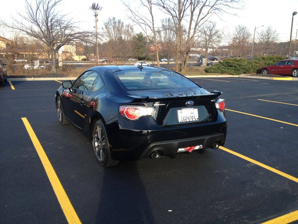

Ok, some shots in the morning:
http://i271.photobucket.com/albums/j...B3A73C2064.jpg
http://i271.photobucket.com/albums/j...B37C86C191.jpg
http://i271.photobucket.com/albums/j...B38E73DE63.jpg
http://i271.photobucket.com/albums/j...F85F4F4558.jpg
http://i271.photobucket.com/albums/j...F86C2DDC25.jpg
http://i271.photobucket.com/albums/j...29265F26FB.jpg

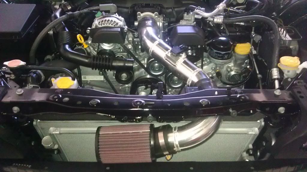

May I recommend against the Injen intake. Lots of problems reported here on the forums related to CEL's and stalling, possibly due to running a bit too lean on the stock tune. The Injen reportedly makes good noise, but the open faced design takes in heat from the header/radiator at idle. I have an Airaid, and the filter is fully shielded, which I think is a good design, but not ideal. The Airaid was a good price, makes a bit of power and good noise, but I'd still go with either
FA20club:
http://i1051.photobucket.com/albums/...b/IMAG1250.jpg
or Perrin's:
http://blog.perrinperformance.com/wp...t1-550x410.jpg
to be released very soon. They both feature a filter outside the engine bay, under the bumper cover. I'll bet they will make more power on a dyno without a tune (with the hood closed) than the others that are out so far. They will both also offer a tune for their intakes that should make the most of them.

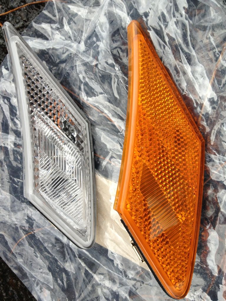

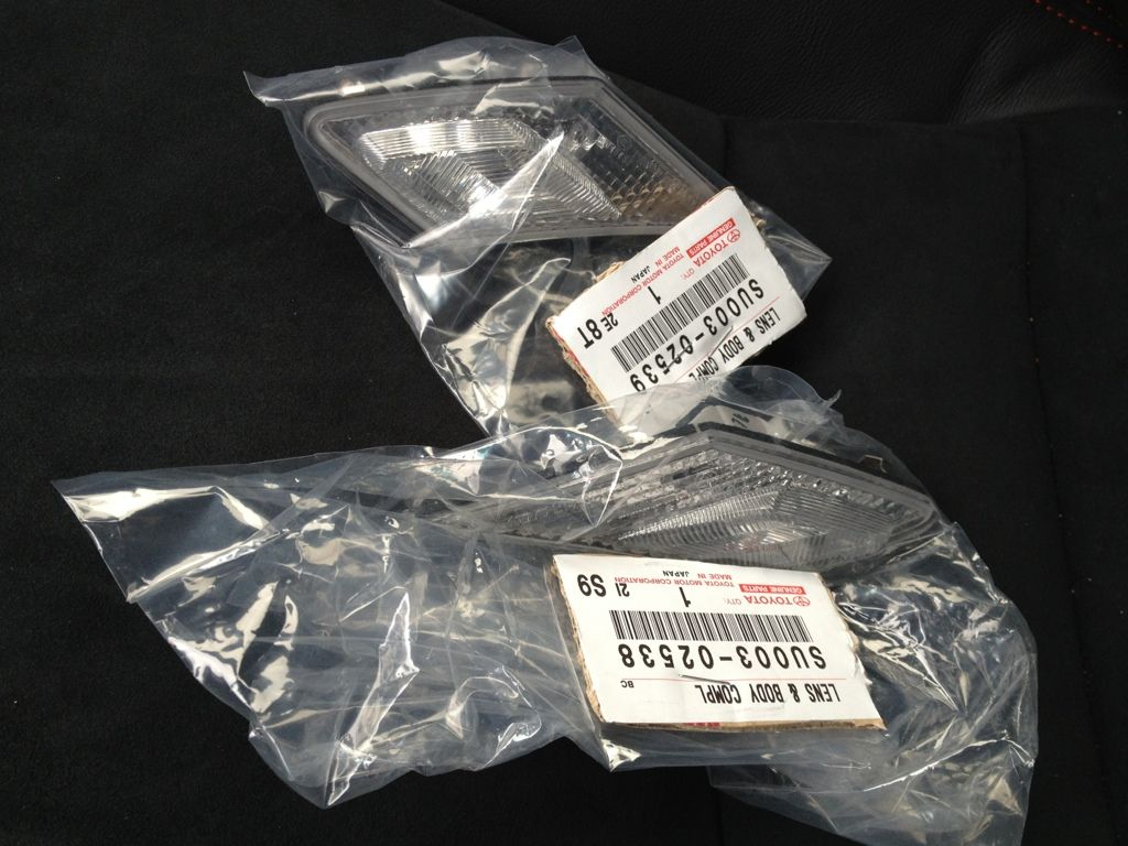

I ran out for a lunch break today and decided to install the OEM JDM Clear Side Markers (in the post office parking lot).
http://i271.photobucket.com/albums/j...23495D00B5.jpg
Comparison vs Stock (Same size, just an odd angle. The clear version has an area that protrudes out, makes it look a little more aggressive I suppose)
http://i271.photobucket.com/albums/j...234FFF34EC.jpg
On the car:
http://i271.photobucket.com/albums/j...2356696291.jpg
http://i271.photobucket.com/albums/j...23628C7D3C.jpg
I'm waiting to receive some LEDs that light up amber. With the stock bulbs it looks similar to how a Christmas light would look. If the surface was more translucent, I'd keep it but it has some transparent aspects so it looks a little like a Christmas light.

the clear markers look great! I'm tempted to get a pair!

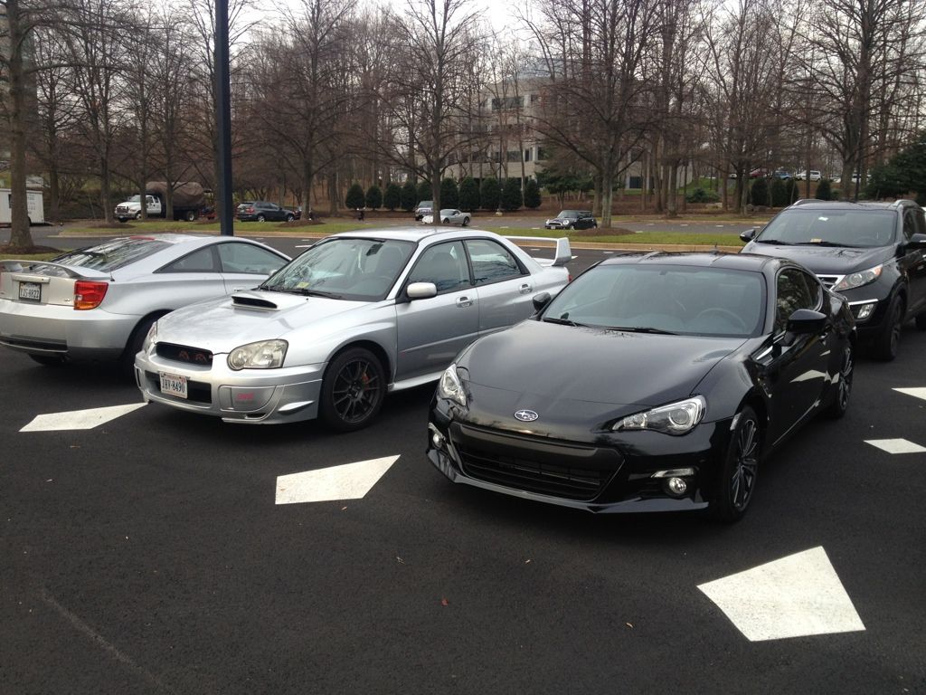

Visiting our sister company's office yesterday and had to park next to this guy:
http://i271.photobucket.com/albums/j...B2C2BA32C7.jpg
I ordered the CS Urethane Front Lip and Side Skirts.

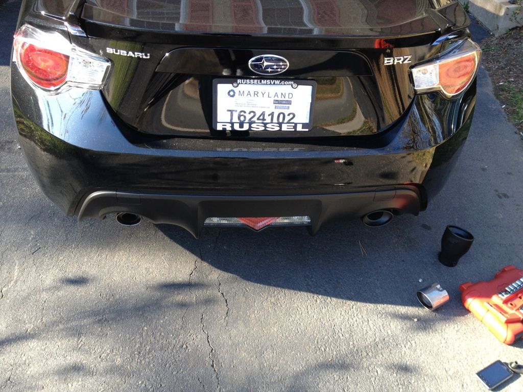

swift996 12-15-2012 02:29 PM

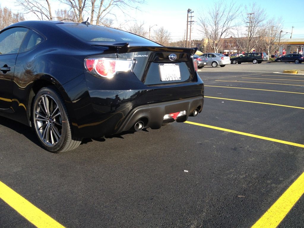

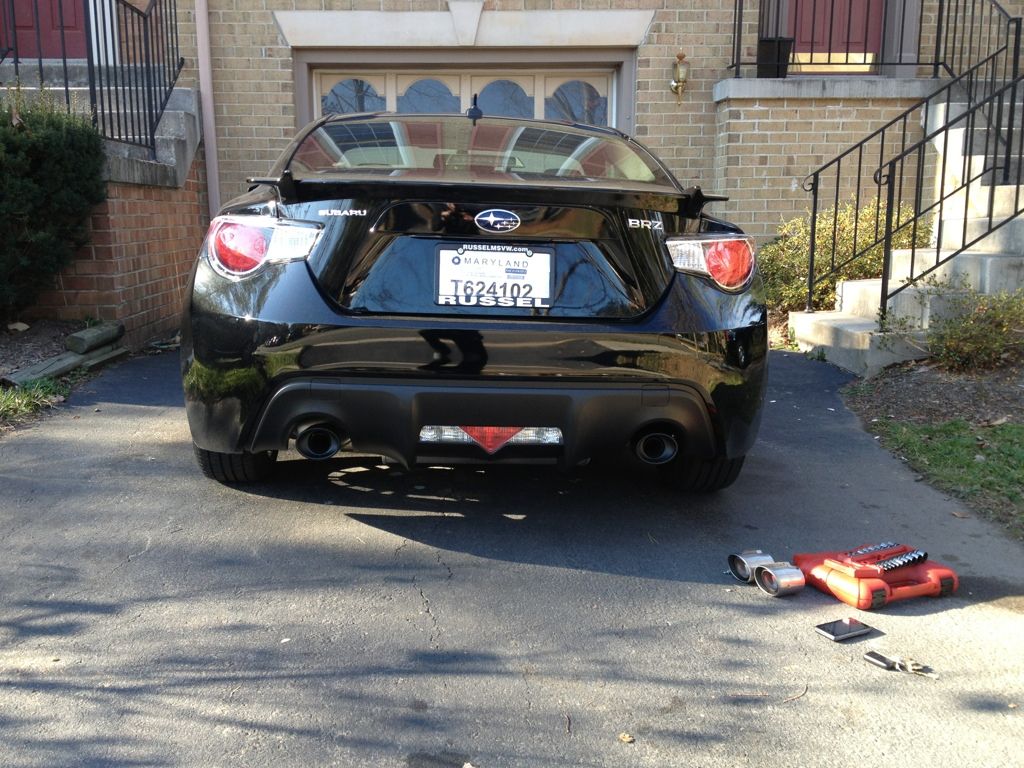

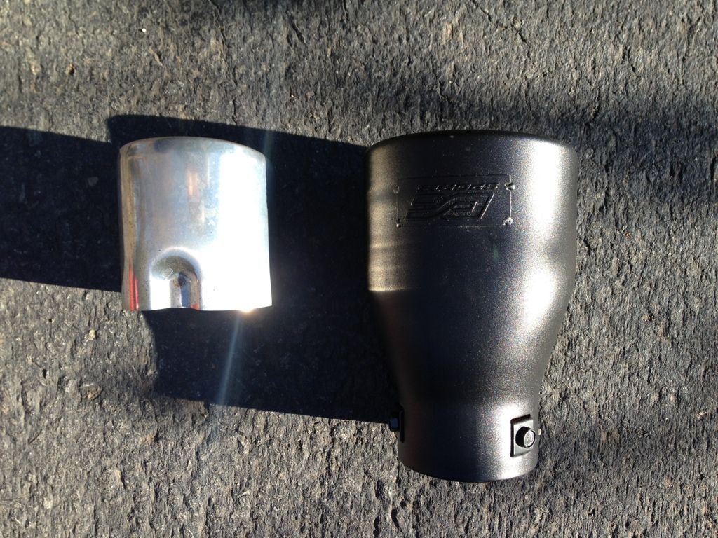

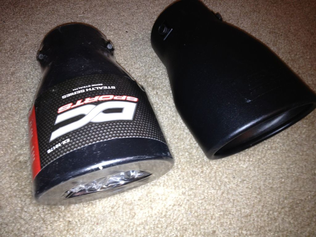

I got this from (Dadhawk) on the forum.

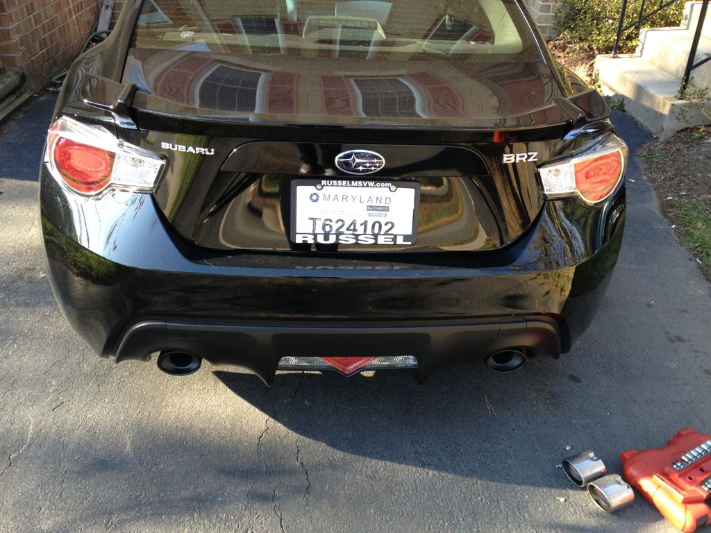

Installed some new black/stealth exhaust tips.
DC Sports Stealth Series EX-1017B. $30 each from Pep Boys (I ordered online)
I figured for $60 what the heck, might as well try it out since I won't be buying an exhaust (maybe one day down the road).
http://i271.photobucket.com/albums/j...52F57BF564.jpg

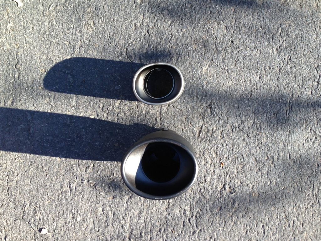

Comparison vs Stock:
http://i271.photobucket.com/albums/j...52FBDF5307.jpg
http://i271.photobucket.com/albums/j...53021DC7B8.jpg
One side done:
http://i271.photobucket.com/albums/j...5307442393.jpg
http://i271.photobucket.com/albums/j...530DECFBC0.jpg
Finished product (took about 10mins) sorry the angle of the sun might make it look a little funny:
http://i271.photobucket.com/albums/j...53133693D8.jpg
http://i271.photobucket.com/albums/j...5318767FD0.jpg

Snapped a few more pics:
http://i271.photobucket.com/albums/j...g?t=1355600786
http://i271.photobucket.com/albums/j...g?t=1355600791
http://i271.photobucket.com/albums/j...g?t=1355600807
L3P47 12-15-2012 04:17 PM
Nice tips. I'm going with the Borla Exhaust myself.
ATL BRZ 12-15-2012 04:21 PM
I really like that front lip. I haven't seen them for sale that cheap yet. Looking forward to seeing it on your car. You'll probably convince me to get one, though I'll probably end up destroying it on some curb... :)
swift996 12-15-2012 05:20 PM
I like the sound of the Borla. If I go with an exhaust, I'll probably go that route. I'm a little too old to be driving around with an exhaust daily. I have a corporate job, so people would judge.
I've seen it on quite a few world rally blue BRZs and it looks great. I think it should look nice and flush with black. $170 shipped isn't bad. I was hoping to install it right before I get some coil-overs but I'm still waiting on the Eibach Multi-Pro R2s. I just hope it doesn't look funny with all that wheel gap and swallowing the tiny stock wheels. I like an aggressive OEM look, so once I lower the car, it's going to look mean.
Justin91M 12-15-2012 05:57 PM
That lip is sexy! Wonder if would it would fit my FR-S?

swift996 12-15-2012 06:32 PM
It should (the BRZ and FR-S) look identical from the bottom of the bumper. I want to say I think I saw someone do it but I can't remember.
FR-S:
http://www.club4ag.com/images/FRS_20...vent-20-47.jpg
BRZ:
http://s.images.boldride.com/subaru/....29.149096.jpg

Install:
It was dark out (cold and windy) but it's an easy job so I decided to do it right away. Total install time is about a 45mins to an hour. You will need a flat head/phillips screw driver set, and a 10mm socket wrench (extension comes in handy). The hardest part of the job was inserting the rubber seal that seals the intake plumbing into the airbox.
The kit itself is good quality, everything is included, it makes it really easy. The intake piping and box are both plastic. They feel a little cheap considering the price tag but oh well.
The OEM unit removed:
http://i271.photobucket.com/albums/j...g?t=1356829372
Installed AEM:
http://i271.photobucket.com/albums/j...g?t=1356829377
Box sealed:
http://i271.photobucket.com/albums/j...g?t=1356829381
http://i271.photobucket.com/albums/j...g?t=1356829389
First run:
As instructed I disconnected the negative line from the battery. The car started right up with no issues, idle was fine, and NO CEL! I let the car idle for a few moments and packed up my tools. I went out for a little spin. The intake feels a little faint down low as I let the clutch out. Almost like the revs drop slightly quicker (but keep in mind I was out of town for a week not driving the BRZ). The intake is quieter than the stock unit w/ sound tube. I was hoping for a little more raw screaming at high RPMs but it just doesn't come. It has the sound of an intake but a pretty mild one. Nothing aggressive or exotic. It reminds me of a K&N drop in filter on other cars that I've owned. The car feels more responsive, the throttle comes alive on demand with no latency. 10HP? I don't know, it doesn't feel any faster but I only went out for one run. It seems to pull a little more efficiently but I don't notice any drastic power increase.
I will update when I get some more miles on it and see if I notice anything different. Overall it feels very OEM so that's good for me. No irattic revs, idle, or anything else odd going on. Is it worth it? I don't know for those on a budget conscious diet, but for me? I got a decent deal and a few hundred bucks is worth playing with for this car IMO.
