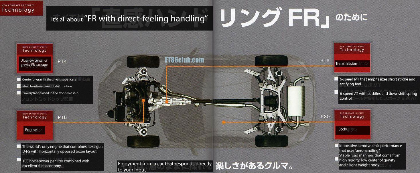

Ryephile 11-17-2011 06:54 PM
Nice post, well thought out.
FWIW, the magazine "specs" are simply guesses that haven't been directly refuted by Toyota or Subaru.
The leaked datasheet reads 1190Kg [2618 Lb] for the stripped out model, 1210Kg [2662 Lb] for the low-spec, and 1230Kg [2706 Lb] for the high-spec. Who knows if this is dry, wet, "unladen", or something else entirely. I wouldn't be surprised if the cars were slightly more than these quoted weights by the time they hit showroom floors.

Kostamojen 11-18-2011 01:46 AM
Originally Posted by serialk11r (Post 77093)
After the catalytic converter can't you switch to (anodized?) aluminum tube? (same with muffler). That would save a crapton of weight over steel (45 pounds says this site http://www.yellowbullet.com/forum/sh...=170195&page=2, although those mufflers might not pass noise regulations lol), and while aluminum is weaker it's cheap as dirt, corrosion resistant, and structural properties don't matter as much for that section of piping.
Getting a little finicky here trying to save ounces... But the big weight savings with the exhaust will be the HEAVY stock muffler. You can see it in this photo:
http://i15.photobucket.com/albums/a3...ojen/wide1.jpg
It looks to be simular to the 2008+ WRX/STI muffler of which I actually had one for kicks and it is HEAVY!!!
Just switching to a smaller can might save 15lbs+ and won't cost much at all.
