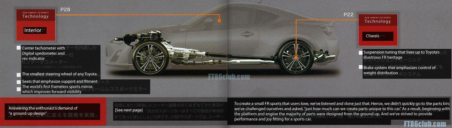

Kostamojen 11-09-2011 08:10 PM
Originally Posted by chulooz (Post 73951)
I will bet dollars to doughnuts that a turbo install will be way easier than any EZ swap, there are only a handful of impreza's running with legit setups. I've talked to Chris at EFI Logics who built one of the greatest track H6 imprezas and he told me that it would be more time, money, and issues; all for less power.
There are only a handful because of how easy it is to swap the turbo motors instead. Plus, nobody has done the work on the H6 ECU's (well some have, but usually winds up being a stand alone setup) and its more complicated to fit the H6 into the Impreza engine bays as it takes a bit of work to get them to fit.
With the Toyobaru's drivetrain location being where it is, I don't see how the EJ turbo setup will fit as it currently exists. There won't be enough room behind the motor, and there won't be enough room under the motor. Its going to require some sort of custom turbo location, which is more difficult than making the H6 fit.
http://i15.photobucket.com/albums/a3...n/img0887t.jpg
coyote 11-09-2011 10:20 PM
There's only a handful because the H6s don't make any power. Tuning them is easy, but they still finish up slow.
I reckon there's a good chance you might have to take back that last statement too ;-)

Kostamojen 11-10-2011 04:48 PM
I'd be perfectly happy with 250-275hp from one of the H6's. I bet with the EZ36, the car would be semi-muscle-car-ish with its power delivery :p
It looks like the header goes a completely different direction than Subaru headers usually go:
http://i15.photobucket.com/albums/a3...ojen/wide1.jpg
http://i15.photobucket.com/albums/a3...ojen/wide2.jpg
Originally Posted by chulooz (Post 74002)
Rotated setup. If you are doubting space for a turbo but think the bay can accommodate an EZ your nuts.
I'm HOPING they left room for the turbo in the usual location, but even a rotated setup might not have room if there is a space problem behind the block.
But if you look at that engine bay photo I posted, there is like a foot of space in front of the motor before you even hit the radiator, so there would be plenty of room for a longer motor (even though EZ's aren't that much bigger as stated).
