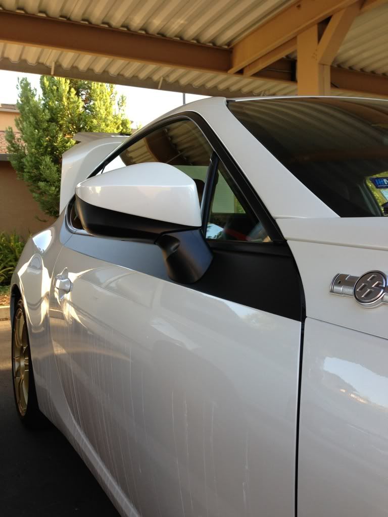

Oilers99 09-22-2012 07:35 PM
Plastidip section
I think it turned out nicely..

cobrabyte 09-22-2012 09:53 PM
Masking .. lots and lots of masking. :D

Oilers99 09-23-2012 01:50 PM
Thanks guys,
It was done with one can of plastidip, one coat of as much as I could get on per side and then quickly removing the masking before the coating hardened up at all to try and get a good solid line..
Its a nice finish up close as well and I think I like the result enough to get that section vinyled if I can find someone very well recommended in Alberta, anyone know of anybody?

Oilers99 10-29-2012 03:13 PM
Hey guys it is the flat black plastidip, and for masking I just used the automotive masking tape in long sections to guess the curve and long straight areas. I sprayed liberally and then peeled the masking almost immediately to get the nice line. If you let it sit too long as I did at first, the edges peel up..
Hope that helps and thanks for the input..
