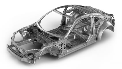

DaJo 09-20-2012 09:06 PM
Alot of the weight in the centre/rear is the frame...then you add the differential, drive shaft, rear axles, driver & rear seats, gas tank, trunk lid, and etc...
http://www.motorward.com/wp-content/...Prologue-2.jpg
http://www.motorward.com/wp-content/...Prologue-3.jpg
http://www.subaru.ca/content/7907/Me..._Eng_Frame.jpg
To give you a better idea of the structural weight...look at the rear...then look at the front; majority of the front are panels...(which also includes the super light-weight aluminum hood)
The front still house all the heavy stuff like the engine, battery, transmission, and etc, but engineers put it as far back as possible...relocating the centre of gravity all the way back...help evening out the weight ratio.

ahausheer 09-21-2012 12:18 AM
Thanks, this is the kind of thing I was looking for, not a debate about 45 this 47 that. That picture of the frame is pretty cool.
