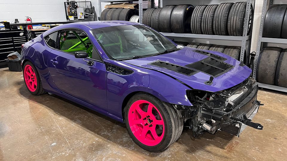

This little blue car has served me well as a TT5/STX autocross car for the last year and a half, including setting a regional track record at our home track Eagles Canyon Raceway & helping me win an autocross national championship, but I've been contemplating taking the next step on building something faster... As much as I wanted to do a Kswap on that car, it was just too nice of a street car to cut up, so this car came back into the picture:
https://hosting.photobucket.com/imag...720&fit=bounds
This is a former TT4 record-holding build in our region has been sitting for a few years as the previous owner kept blowing up FA20's on track (surprise!) and he was over it 5 motors and life getting in the way later. (I don't blame him one bit) But he hadn't let it go just yet as he didn't want it parted out and wanted to see it get driven again. I feel very lucky I was able to pick it up this past weekend and we struck a deal that works out for both of us.
This chassis has had an amazing amount of work and engineering put into it already and just needs a reliable power plant to go after some records again. So a K24 seems like a no-brainer to keep the weight low, a Japanese 4-cyl in the car (sorry LS fans), and make future blown up motor replacements inexpensive cause the chances are with how hard we plan to drive this thing we'll blow up one or two again in the future.
Lots of work to go here and I'm looking forward in sharing the process. :D

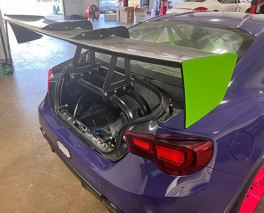

This week with the car we are going to take a few things apart and dig into how the car is built and fabricated so that we can update some items and also get to know better what we have got.

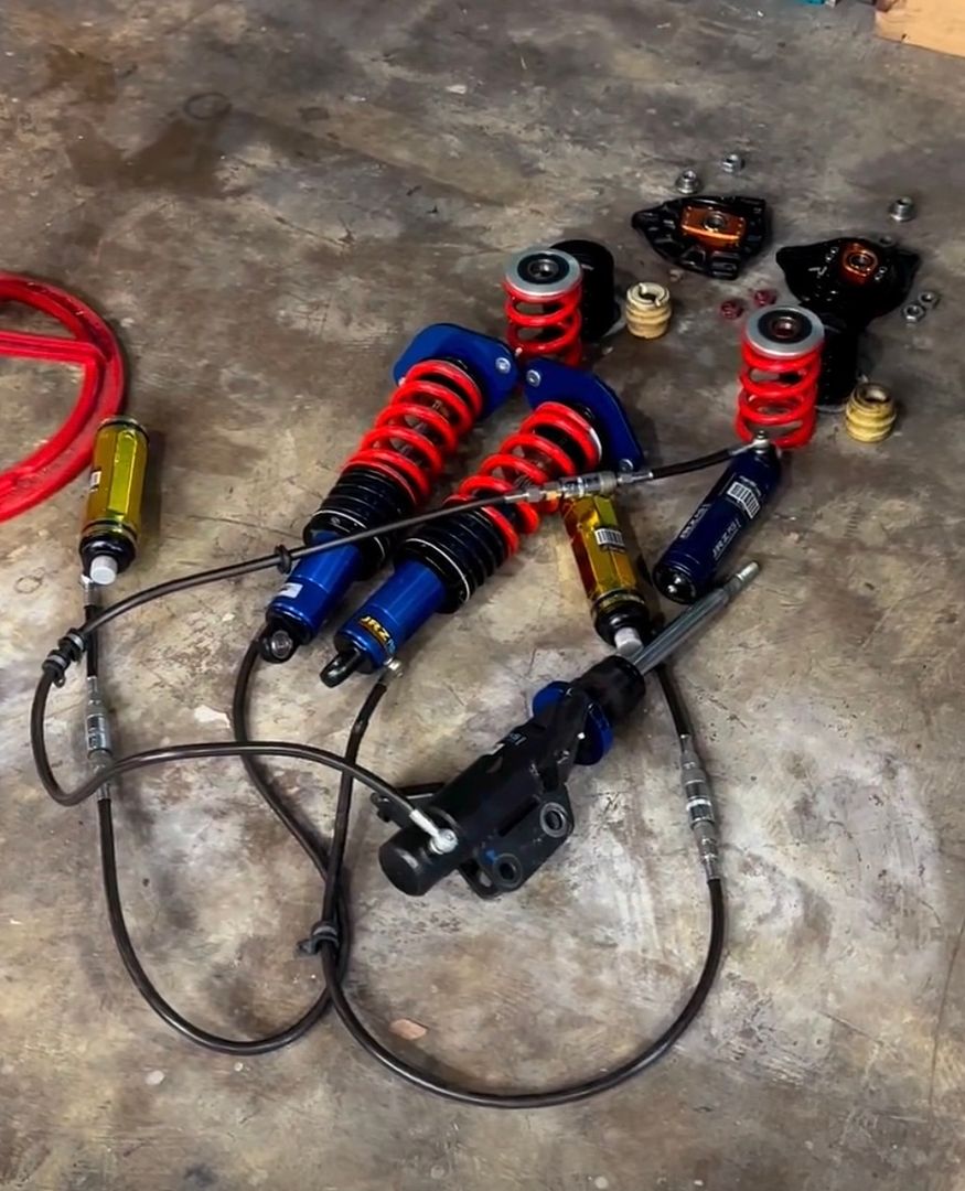

A little list on the basic setup currently:
- JRZ Rs Pro suspension
- Full SPL catalog of suspension arms
- CSG setup OS Giken diff

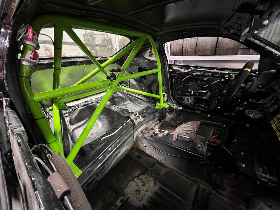

- Half-cage that is SCCA compliant to be able to add onto for a full road-racing cage in the future
- Carbon dash
- Voltex Type 7 wing, chassis mounted
- Formerly supercharged with a Harrop kit, so lots of supporting mods for that as well to go through

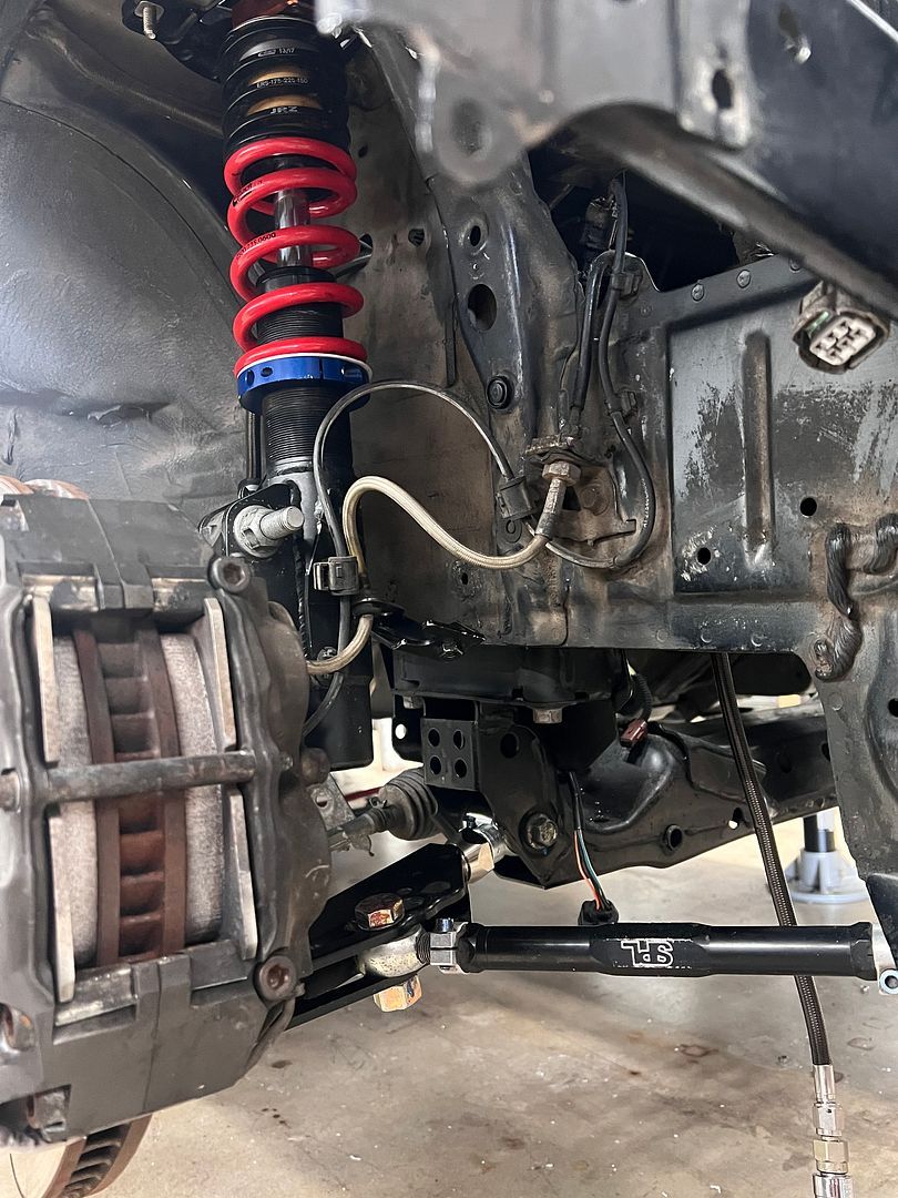

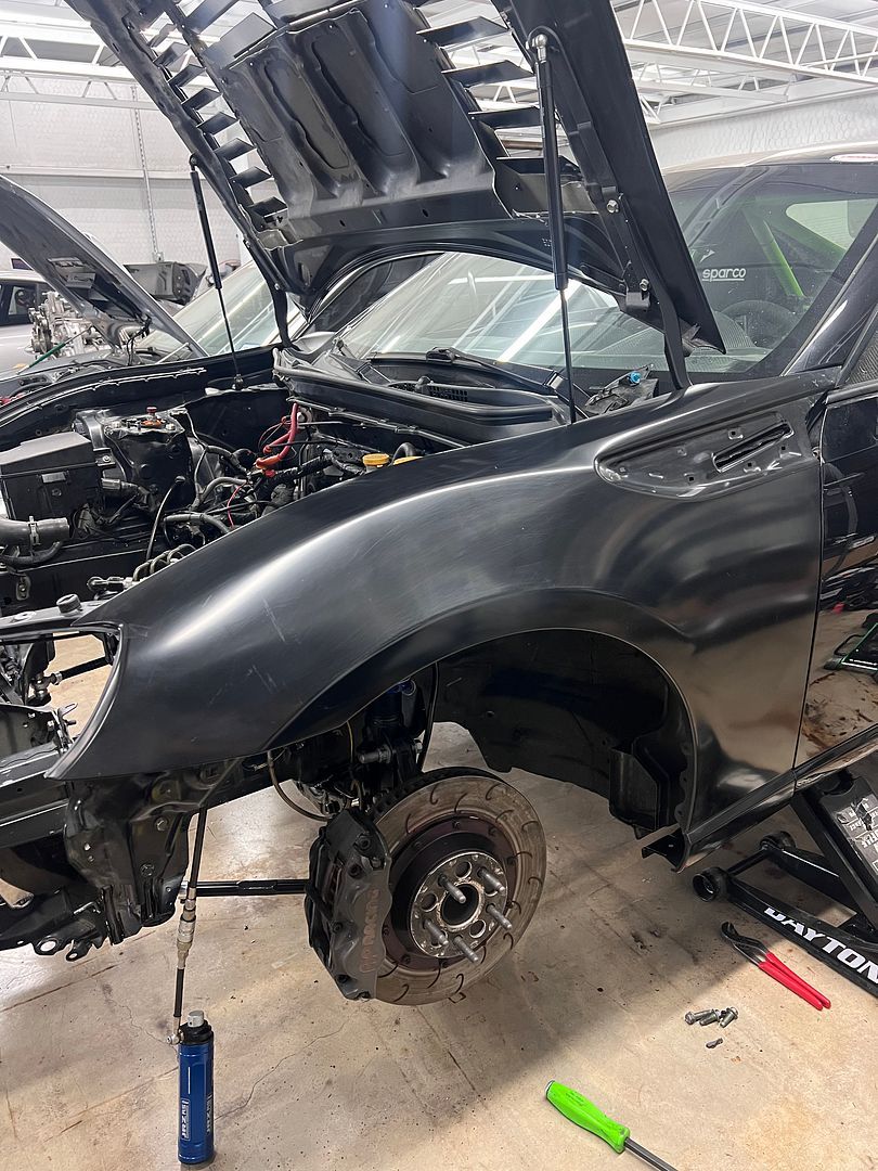

Today we started with a quick pulling of the bumper and seeing how the splitter was mounted and the ducting has been done on all of the coolers. Plan is as we install the K24 to try and reuse as much as we can here in regards to coolers, shrouds, and mounting locations for everything.

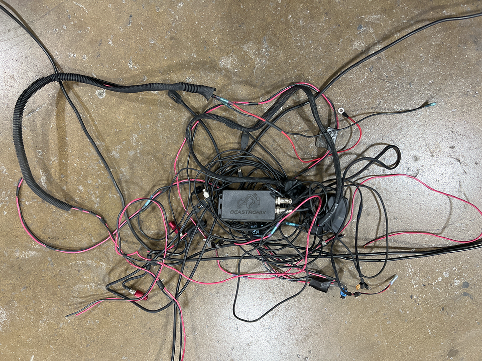

My Big struggle in purchase decisions right now is how to wire/control the swap.
I have very minimal accessories left in the car outside of controlling the engine. The car has no headlights (might add these back), heater core, ac, windows, radio, door locks, etc.
All I really need is ABS (most-important, I'll leave the non-ABS driving to my Miata), brake lights, a reverse light, maybe headlights again, windshield wipers, and a few switches for racecar accessories (coolshirt, transponder, etc.) I would love to do something like a MircoPDM for these. I Love the idea of an AIM PDM/Dash combo, but it's pretty spendy.
I'm also planning on ditching the stock cluster as well and going with an AIM Dash (have an MXL2 to use) so I'm left wondering if something like the Haltech and Kpower wiring harness is really the best option, or if its overkill considering this car is pretty stripped down. I definitely want to go with a motorsport grade engine wiring harness, and it looks like there's several options available so my head's spinning a bit on everything.
If anyone has any suggestions on wiring harness builders and engine management, I'm all ears on being pointed in a few directions beyond just the swap kit to look into.
If I had unlimited funds for this project, of-course Motec would be the way to go, but I'm trying to be a bit budget-conscious here haha :D

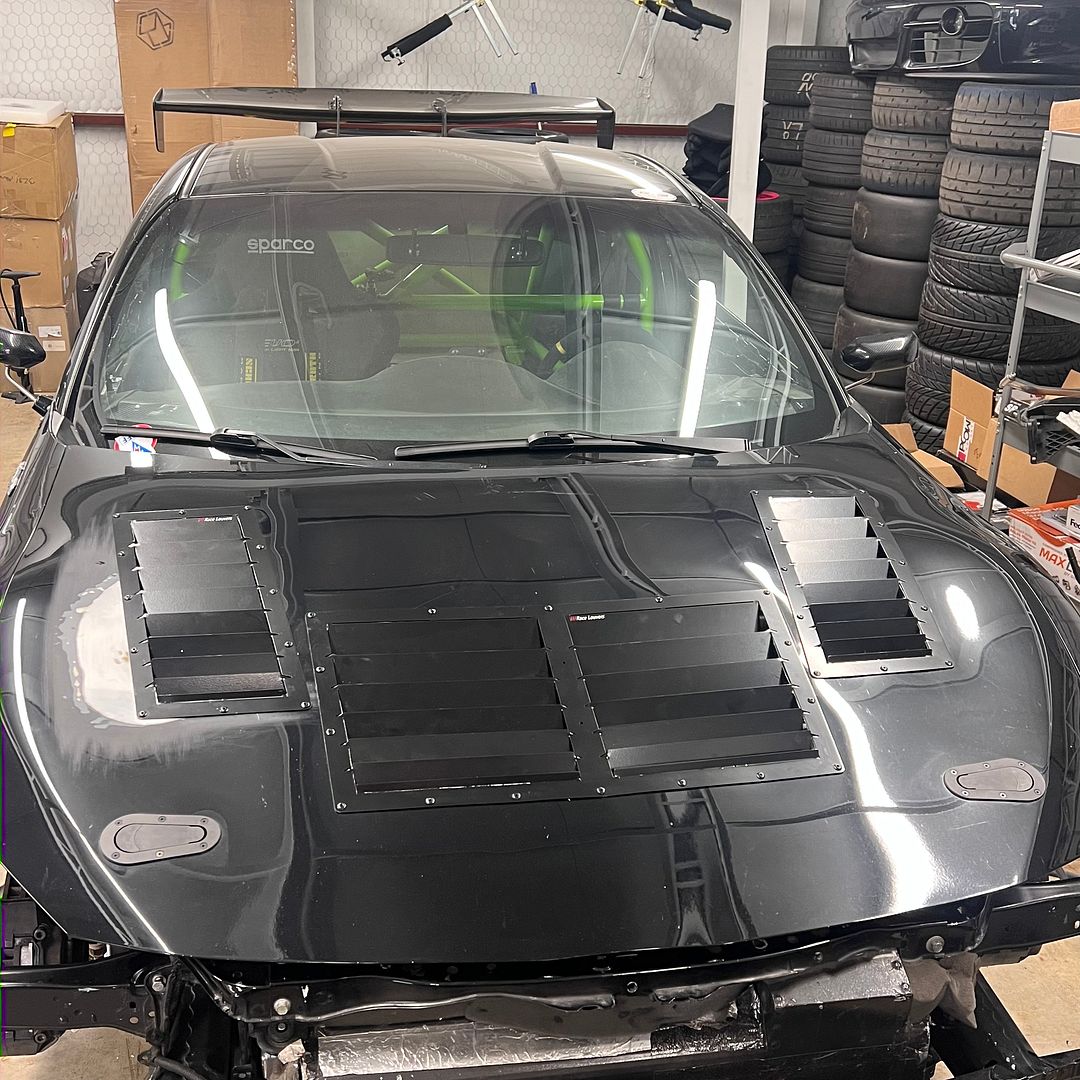

One big project has been the hood vents.
The ones that originally came on the car were once legal for Nasa TT, but the rules have moved on over time and they were no longer legal. Thankfully, there's great companies out there like Race Louvers and they make a set of legal vents that maximize class rules and thankfully were just the right size to fit where my previous vents did with minimal additional cutting. I was really trying to avoid buying a new hood so this keeps us going down the path. I have them all mocked up to fit now, but will not be fully-completing installing them as I plan on getting the car wrapped and it will be easier on the wrap installer to not have to cut around them.
https://hosting.photobucket.com/imag.../IMG_4635.HEIC

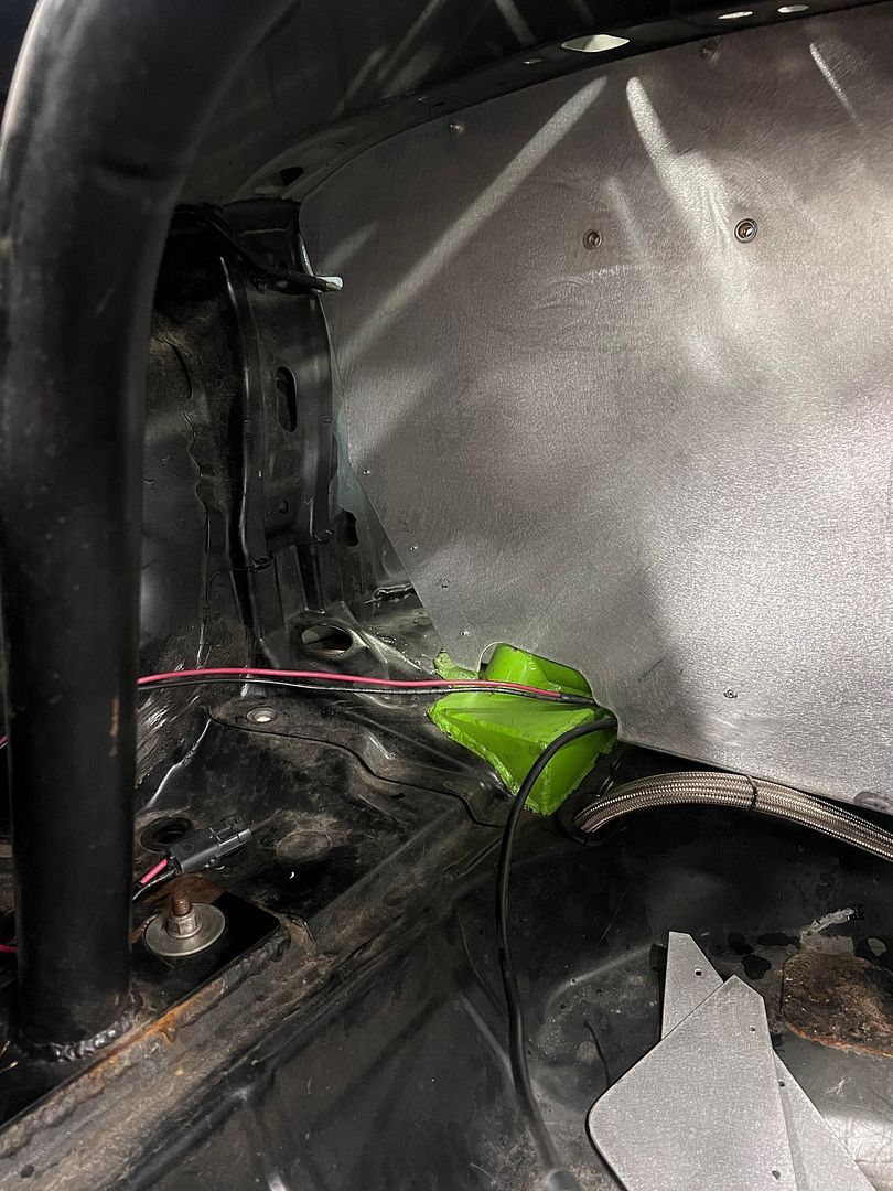

Up next, I have started removing some things from the car that need serviced/replaced.
The Coolshirt box (very much needed for a non-interior, non-heat/ac car on track in TX summers) has been located in the trunk; but is too large to easily remove/refill without partially removing the (Heavy) chassis-mount wing and was also positioned in a way that made it difficult to fill with ice/water.
https://hosting.photobucket.com/imag.../IMG_4671.HEIC
I'm not 100% sure what my next move entirely is on it, but the box needed to come out to start. Plan A is to try and find a smaller cooler box for it that will fit under the chassis-mount. Plan B is to relocate it to the Passenger compartment. (I plan on no longer running a passenger seat in the car). And Plan C is to maybe go with an alternative system that is more compact. There's a couple of options out there I am looking into that accomplish the same goal and at less size/weight, so it really is going to just boil down to what's left in the budget for this later on. I ultimately do want this car to be as light as possible as ballast can always be added back later on where I want it, so this is one of those items where I would like to try and take advantage if possible and not too cost-prohibitive.

I mentioned above the passenger seat is coming out; and the driver seat, while it is a nice composite halo seat is old and expired with quite a bit of wear on it.
I do plan to eventually finish the cage and race this car, so up-to-date safety is a must. Decision on the seat has been a tough one though. I have sat in and like the OMP HTE-R but also recently found the Sabelt X-Pad seat and it is very tempting. But the Sabelt seat is designed to fit really in much smaller cars than this FRS, but at a little more cost so I'm debating on the value add. I fit in and find both very comfortable so it's really just an undecided preference at this point.
Car will also be getting a new set of belts as the current set is expired and showing its age. I found these GForce belts in a competitor's car recently and they have a lot of really nice features that are found on higher-end belts for a great value, so I am likely going that route or to a set of Safecraft's like in my Miata.
Additional cleanup includes ordering a new windshield wiper cowl as the car previously got it bet melty with a small engine bay fire. This is mostly cosmetic, but it's a fairly inexpensive and easy fix, so I'm going to make sure it's done right and make it a bit nicer.

And lastly, the shocks are off getting rebuilt as I'm not sure when they were last serviced and since the car has just been sitting around on jack stands anyway now was the perfect opportunity to get them refreshed.
I spotted them in the rebuilders social-media over the weekend and they are all ready to go except for one of my fronts. You can just barelyy see in this photo that the shaft is bent. The car has had a prior minor contact with a tire wall and I imagine that may have been the cause of this damage or just normal hard hitting of curbs on track. So at this point, we are waiting on JRZ to send a new shaft so they can get reassembled and back to me.
While we are at it with things disassembled, the front lower control arms are also getting an updated set of rod ends as one of them was bent.

We have the shocks back from getting rebuilt and they are going on the car. :D
There was a bent rod end on one of the SPL Lower control arms as well so that has gotten replaced as well as we put the car back together.

The lack of finished hood vents was bothering me and the wrap guy said it is easier for him to do the wrap around them installed, so they are officially bolted on. Really very happy with the customer service and quality of the parts from Racelouvers. Highly recommend.
I was able to send Al the measurements of my old vents and he was able to get me a template to test fit his parts to make sure they fit within that spacing with minimal extra cutting and I get to reuse my same hood which is a nice cost savings. My OCD on looks also loves that he sends black rivets with the kit.
https://hosting.photobucket.com/imag...tRoT2gLdkM.jpg
The car also had a bit of damage on the Left fender that while I'm at it before the car gets wrapped later this year I wanted fixed, so that fender also got replaced.
https://hosting.photobucket.com/imag.../IMG_5180.HEIC
And the newest project is now cleaning up the rest of the trunk.
Removed the coolshirt and old fire bottle, and decided while we're at it to do a little more.
The fire wall annoyingly blocks access to the rear strut chassis-mounting location. So, we have removed those corners of the firewall that were riveted in place and going to nut-sert them for easier future removal.
https://hosting.photobucket.com/imag.../IMG_5175.HEIC
It's a bit messy back here right now as the fuel system likely also needs a refresh, so the plan is to get a fresh fuel pump and then reinstall everything. The coolshirt bracket and fire bottle brackets are out and will plan on painting everything back here in the trunk as well to clean it up.
https://hosting.photobucket.com/imag.../IMG_5176.HEIC
Motor install probably on hold for a while longer, but glad to get some of this ancillary stuff going and I'll pick away at more cleanup in June.
NoHaveMSG 05-19-2023 01:14 PM
That is interesting. I found it easier to wrap the hood with my vent off, then trim it back from the edge a bit and bolt the vent over the top of it.
Kelse92 05-19-2023 02:21 PM
Yeah that's what I thought at first too, and he said the other way around. He's really good at cutting around stuff and that it would be way more difficult to undo if I ever change the color again since the wrap would be underneath the vents and I'd have to drill out all of the rivets.
Kelse92 08-30-2023 11:59 AM
WHEW, It's been a long summer!
We have moved shop locations and had a Ton of other things going on so the FRS has been sitting a lot without much progress. Just haven't had much time to touch it with everything going on...But I'm finally finding some time and making some things happen so figured I'd share where we're at now!
With all the down time and knowing we weren't going to touch the car much, I turned the car over to our neighbor who wraps cars and in keeping with the Porsche color theme of my prior car, I had the car wrapped in Inozetek Ultraviolet. It's a little too much 'drift car' looking right now without the bumper and the hot pink roller wheels but we'll change that at some point. ;)
This is pretty much where the car is going to sit as we begin to install the K Swap, but before that gets really going there's been a few other ancillary projects that needed done.
For starters, the wiring under the dash and around the interior was a MESS.
The car had Lots of track accessories that I plan on changing up to more updated parts, and I also like a clean OEM+ like install when it comes to interior wiring.
So Lots of stuff had come out:
- A Coolshirt box previously mounted in the rear with a switch
- An old fire system that needed all of the tubing and pulls removed
- Old video camera cables and charging cables for them
- Old AIM Solo wiring
- Beastronix box that will get swapped for a TracBox
This was a refreshing pile to remove from the car, and as part of that I finished pulling out the passenger seat and degreasing/cleaning the entire interior. It was pretty dusty/dirty in there.
Looks a whole lot better now and ready to start installing things back in. :D

The other Big change is the car no longer has the Voltex Type 7 wing chassis-mounted. I waffled back and forth on this, because it's a beautiful looking aggressive setup. But in the world of Aero technology, it's a bit outdated. The airfoil is Huge and not very efficient. Weight is also a factor; even with the setup having been built as light as possible, the Voltex wing and chassis mount with all the mounts/hardware and the fiberglass trunk cover weighed in over 35lbs. I had saved the spare stock trunk with TT5 Zebulon wing from my previous car, and the total weight of that setup is only 30lbs, so it's now on the car. I have a few changes in mind to optimize it down the road with a different airfoil, mounting style, and potentially modified endplates but for now this is going to be the base wing setup.
Before:
After:
NoHaveMSG 08-30-2023 12:58 PM
Wrap looks great. Was he able to do the trunk in 1 piece?
Kelse92 08-31-2023 12:35 PM
Thanks! The trunk is surprisingly 1 piece, with the garnish being the only thing separate. When I DIY'ed it previously I had to do a separate section on the top of the trunk and then the back.
NoHaveMSG 08-31-2023 01:02 PM
That is crazy he did that one piece. I wasted a bunch of material trying to do one piece and kept stretching it too much and had to do 2 pieces as you mentioned.
