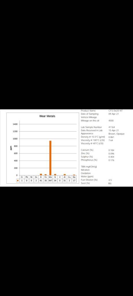

Originally Posted by Tcoat (Post 3542758)
The product called Liquid Moly is 180 and that is considered high.
Assembly lubes can go as high as 400 and should be diluted from there.
The samples posted are well above that.
My point remains that the guys that run home with their new car and drain out all that “crap” initial fill shouldn’t be in such a rush.
https://www.liqui-moly.com/fileadmin...Molygen_EN.pdf
Is this Moly concentration in Engine oil? In UK we have a very popular oil brand called Millers and this is their used oil sample analysis for my car. I have a few more, always Moly around 1000 PPM. Attachment 214655
Sent from my SM-G781B using Tapatalk
