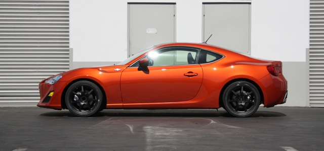

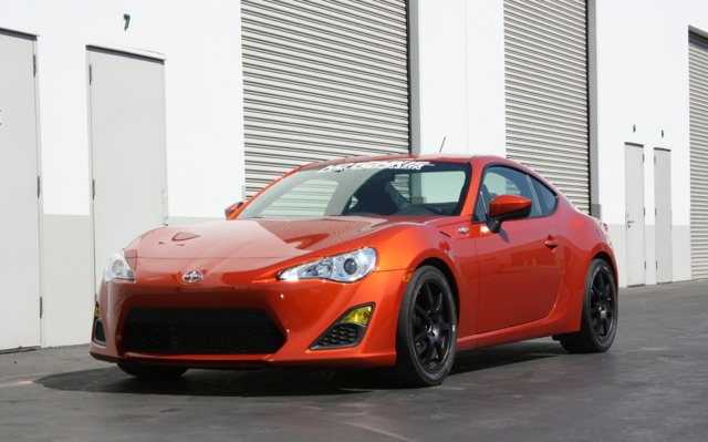

Before:
http://img442.imageshack.us/img442/8948/img2834yt.jpg
After:
http://img825.imageshack.us/img825/846/img7474e.jpg
http://img52.imageshack.us/img52/9760/img7480m.jpg

(Before) Stock:
Front: 14-9/16" (14.563")
Rear: 14-3/4" (14.750")
(After) Hotchkis:
Front: 13-5/8" (13.625")
Rear: 13-3/4" (13.750")
:thumbsup:
