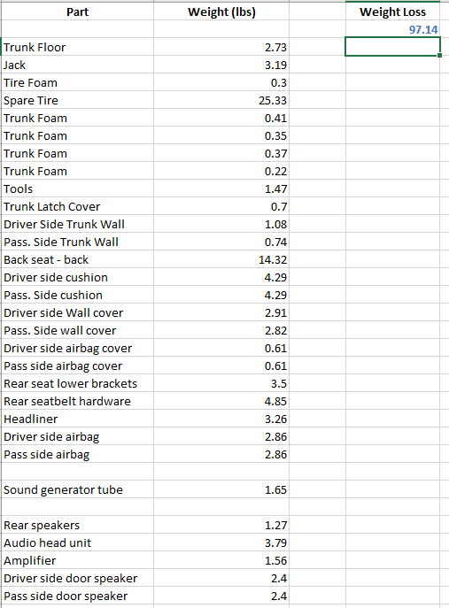

TheBoss77 10-03-2021 01:01 PM
Some parts fell off
5 Attachment(s)
Spent the week detailing the hell our of her and putting her on weight loss. I have to admit, I'm really impressed with the Toyota / Subaru engineers. Stripping most of the interior of the car resulted in weight saving of only about 100 lbs, far less than I anticipated.
Incidentally, the interior for this car is for sale if anyone is looking.
Breakdown of interior part weights below:
Attachment 205778

Finished installing the head unit and the Polk Audio speakers. Nice to have Android Auto. The sound quality is "good enough", the interior is almost completely bare so not worth investing in good quality sound.
Added Weight:
Head unit weight: 2.27lbs
Speakers weight: 1.71lbs x2
Removed Weight:
dash speakers and tweeter: 1.47lbs
