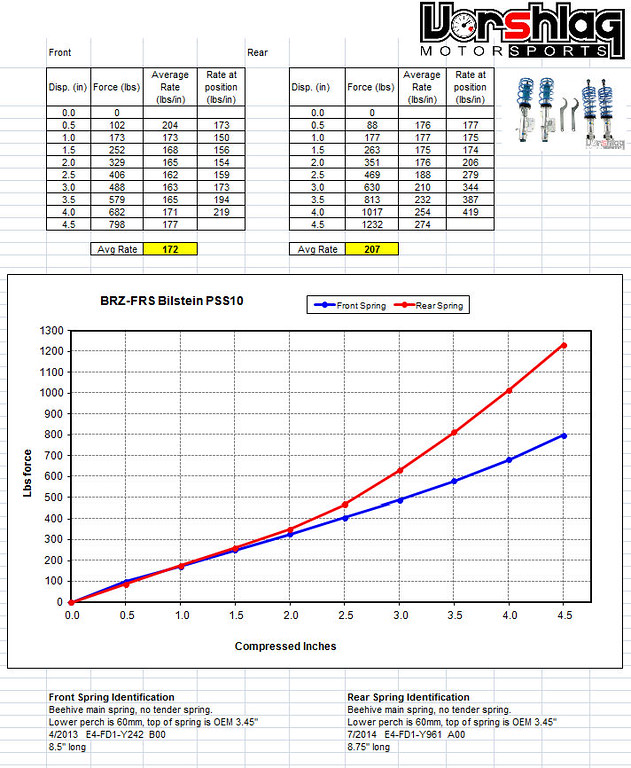

FWIW, the Spec R spring rates are extremely close to the springs rates at ride height on the B14 kit, which has identical valving to the B6/8. The Spec R is 4.4f/5.3r vs the B14's 4.2f/5.5r. The damping should be well matched.
ZDan 11-24-2020 09:36 PM
I think B14/B16 springs are progressive and start out with much softer rates than Spec R. Main reason I went with Swift Spec R/B8. Also no height adjustability saves me 42 lb. for car classification for time trials!

Yes, they start very soft but that's at full droop. With the car's weight, the effective rate is stiffer. Here is a spring dyno by Vorshlag. Take the sprung weights at each corner, and then calculate the corresponding displacement and rate at that displacement. You should get pretty close to the 4.2f/5.5r I quoted. Quoting the 2.5/3.0 rates is a bit like quoting helper rates on other coilovers.
Attachment 195139

ZDan 11-25-2020 04:52 PM
Great info! Yeah, looks exactly like the soft initial rate is just a built-in "helper". I had some bad info on these, someone reported negatively on the "soft initial rate"!
My math says there's ~825 lb. on front springs and ~855 lb. on the rears (2850 lb. car+driver, 55F/45R, 0.95 front 0.75 rear motion ratios). That's out of the range measured for the fronts, going by the last half inch of travel measured I get 232 lb/in or 4.14 kg/mm, close enough to 4.2! For rears in the range of static load I get 404 lb/in or 7.3 kg/mm.
Anyway, glad to confirm the *actual* real-world stiffness for these! Still glad I went with the Swift RSpec, these rates seem very rear-stiffness biased...
itschris 11-25-2020 05:58 PM
Originally Posted by ZDan (Post 3387752)
Great info! Yeah, looks exactly like the sof initial rate is just a built-in "helper". I had some bad info on these, someone reported negatively on the "soft initial rate"!
Ahhh good catch with the motion ratios! I think when I measured the springs myself I got a slightly higher rate in the front than Vorshlag, so I managed to get the same answer there with the wrong methodology.
Don't those weights include unsprung mass? I had used ~685 lbs front/~560 lbs rear for just the sprung mass. Corresponding force on the springs would be (685/.95) and (560/.75) or ~720 lbs and ~745 lbs, leading to ~4.1-4.2 kg/mm front and ~6.4 kg/mm rear. About halfway between our two numbers :lol:
ZDan 11-25-2020 06:04 PM
Oh yeah, good catch yerself!
I def would have given these more consideration if I'd had a better idea what the *real* spring rates are. But I saves 42 lb. with no ride-height adjustability, and not gonna lie, I like the idea of competing against "serious" coilover setups with "just lowering springs and struts/shocks" :P
