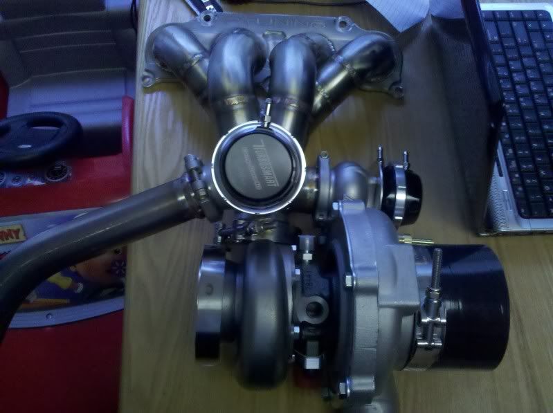

Dragonitti 05-31-2011 10:55 PM
http://i119.photobucket.com/albums/o...e/DSC04954.jpg
Dimman 05-31-2011 11:01 PM
TiAl stainless exhaust housing?
Dragonitti 05-31-2011 11:49 PM
Yes sir 100% V-banded. From the manifold to the turbine, from the turbine all the way out the back...

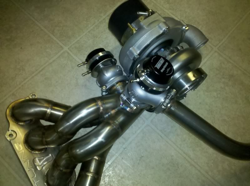

Dragonitti 06-01-2011 01:48 AM
Game Changer...
http://i119.photobucket.com/albums/o...531_190346.jpg
http://i119.photobucket.com/albums/o...531_190338.jpg
http://i119.photobucket.com/albums/o...531_190318.jpg

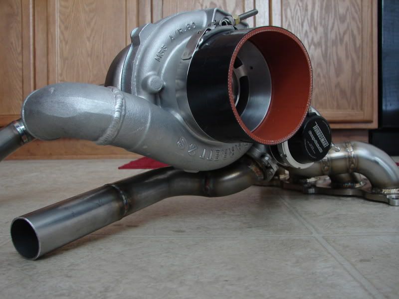

So, I was bored last night and did a little mock up with the WGs mounted.
http://i119.photobucket.com/albums/o...601_064853.jpg
http://i119.photobucket.com/albums/o...601_064801.jpg
blur 06-01-2011 06:52 PM
She's purty. How much you planning on putting down?
Dragonitti 06-01-2011 09:27 PM
About 330-350whp for now. Setup is good for 600whp once I'm on a built block.

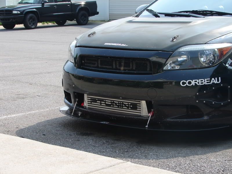

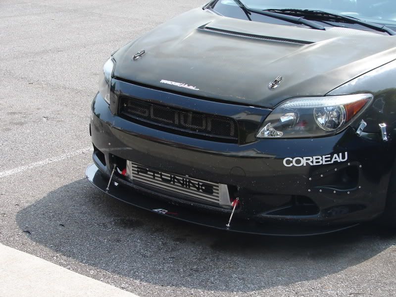

Dragonitti 06-05-2011 12:26 PM
http://i119.photobucket.com/albums/o...e/DSC04967.jpg
Dragonitti 06-05-2011 12:27 PM
FMIC Mock up. Car is a little dirty...
http://i119.photobucket.com/albums/o...e/DSC04969.jpg
http://i119.photobucket.com/albums/o...e/DSC04968.jpg
Random_Art 06-05-2011 12:53 PM
I'm a bit of a noob when it comes to turbo setups as most of the vehicles I've had an opportunity to poke around under the hood with have either been NA or supercharged. Does the tube coming off the waste gate connect back in with the rest of the exhaust after the turbo or just dump the gas into the atmosphere?
Dragonitti 06-05-2011 09:00 PM
You can do both. I prefer to vent to atm though, as it sounds like a Demon! People want to move out of the way when you here open gates coming toward you. But some prefer the quietness and want the sound of the turbo more pronounced, so they plumb it back into the exhaust. The downside to plumbing back in though is that you potentially lose HP. In some cases I've read up to 40hp re-routing back into the exhaust stream. That's a worst case scenario though, you might only lose a few hp.
