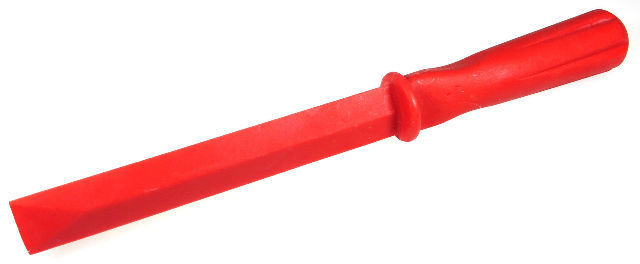

maslin 06-21-2019 11:47 AM
I've been playing with stick on weights for 15 years. We have the pliers, they don't work well and actually ding the wheels worse.
Something like this, ours came with the Hunter machines and have lasted a long time. Some pushing, twisting, hitting, and brake clean and you're done.
http://assets.suredone.com/2138/medi...pe-scraper.jpg

Yep, these plastic wedges is what I always used and I've never seen them scratch the finish like what was done on his wheels. It looks like someone used a nail puller or small pry bar to get them off, and since it was steel it scraped right through the paint and gouged the aluminum of the wheels. The plastic wedges like you are using don't do this.
That tire shop was doing a shitty job, straight up.
