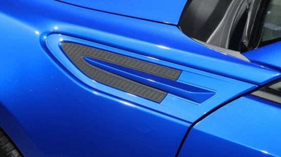

Hi guys I am thinking to start making the BRZ fender trim fake vents to real ones and start selling them is anyone interested in buying them ?
Attachment 171459
If I start selling them the kit will include .
1- FRP unpainted vent trim right and left .
2- template for the cut line on the actual fender .
3- 3M .
let me see your thoughts :popcorn:
