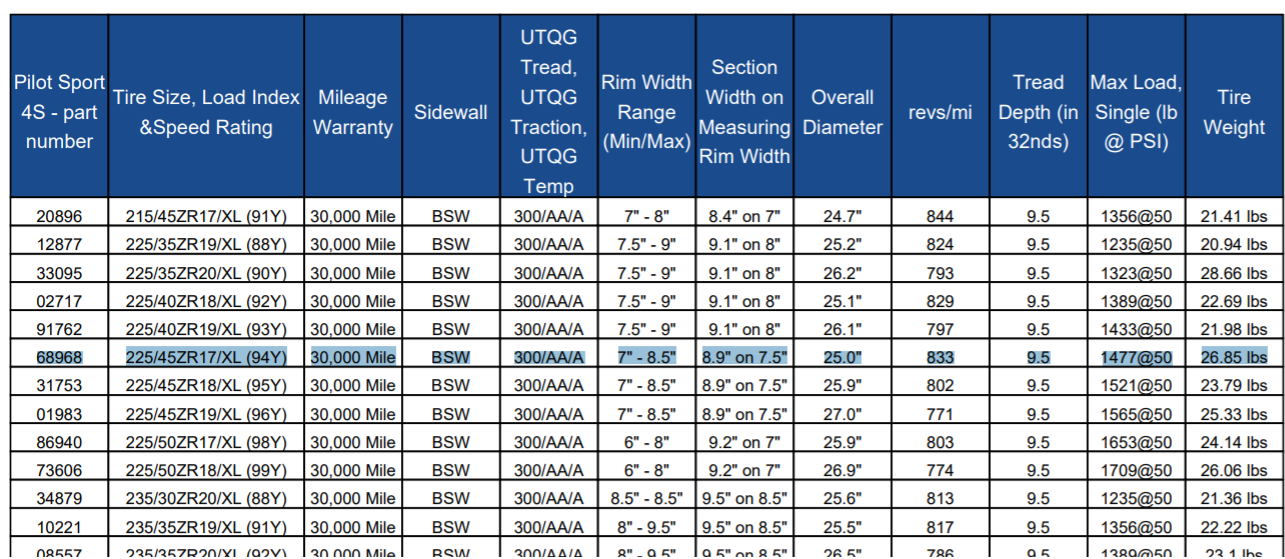

r3myx626 03-11-2018 04:13 PM
If you look up the specs the 225/45R17 PS4S are pretty heavy compared to stock. Just in tire alone he's adding a bit over 6lbs in weight to each corner. Add in spacers and you're really going in the other direction as far as adding performance....if you care for those sort of small improvements.

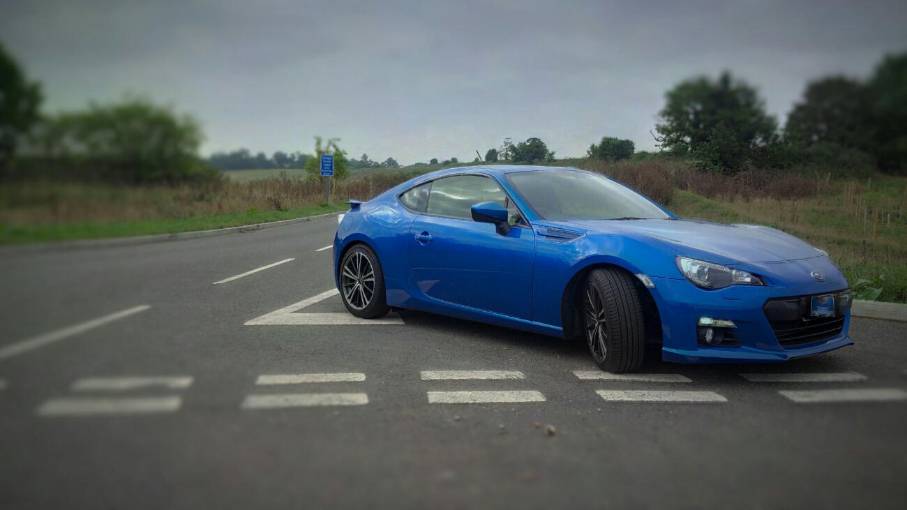

JD001 03-12-2018 05:27 AM
[QUOTE=Kushkaki;3056884]stock wheels and stock height, so thank you! I may go 20/25 F/R...[/QUOTE
My car with 20f and 25r.

Leonardo 03-12-2018 04:03 PM
IDK what you are talking about. Tirerack.com has the 225/45/17 PS4S listed at 21lbs; a one pound increase over the stock primacys.
r3myx626 03-20-2018 10:11 PM
Straight From Michelin's website:
Attachment 164426
Source:https://www.michelinman.com/upload/michelin_us/specifications/specs-pilot-sport-4s.pdf
JimmyMac 03-24-2018 08:11 PM
Wonder if that's a misprint considering that the 225/50 is almost 3 lbs lighter than the 225/45.
nico_rsx 03-25-2018 02:01 AM
This michelin table make no sense it's a mistake for sure.
The 225/45/17 can't be heavier thant the 225/50/17. It got the same width, but less height.
This can be confirmed by looking at the same size in 18", in that case the 225/50/18 is heavier than th 225/45/18
chree 06-01-2018 06:00 PM
Called Michelin re: 225/45ZR17 Pilot Sport 4S at 26.85 pounds, they say "It's 26.85", then online chat with Michelin: "It's 26.85". Call Tire Rack, Felix, extension 4497, goes the extra mile and has one weighed... correct weight is 21.0. I purchased and confirm:
http://sites.google.com/site/grabano...r/IMG_2384.jpg
Next to an original 215/45R17 Primacy HP:
http://sites.google.com/site/grabano...r/IMG_2386.jpg
rvoll 06-01-2018 06:52 PM
I just replaced my new Primacy 215 HP's with the 225 PS4S, and the weight increase was only 2 lbs per tire. The weight on the Michelin spec sheet was wrong. If you compare that weight with other tires, you'll see what I mean.
r3myx626 06-04-2018 06:24 PM
2lbs is way better than 6 and about on par with other options. Thanks for the feedback.
