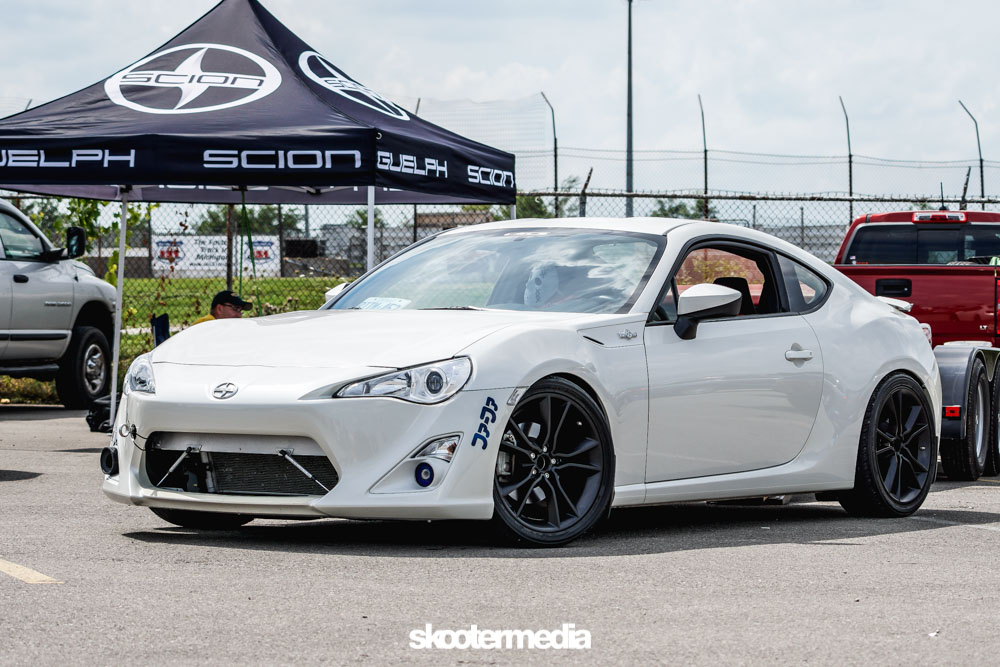

erikfallout 12-12-2016 02:32 PM
No grill front bumper
OK I want to take my grill off my OEM front bumper so I can show my radiator but that bar of styrofoam still shows. How can I get it the way I want without buying a drift bar? Like Birdys below?
https://scontent.cdninstagram.com/t5...MjQ4OQ%3D%3D.2
zeal86 12-12-2016 02:43 PM
Lose the styrofoam then prep and paint the beam brace matte black.

erikfallout 12-12-2016 02:51 PM

That easy? Thank you! Washing it wouldn't damage it correct?

zeal86 12-14-2016 09:27 AM
Originally Posted by stevemp5 (Post 2814389)
For those who have already made this change, can you remove the grill without removing the bumper?
I didn't do it this way but I'm thinking you can if you lift the front end high enough to comfortably work and remove the under panels. I think that would allow enough room to get in there to remove the screws and pop out the snaps.
http://i41.photobucket.com/albums/e2...%20Removal.png
I dremeled the tabs down even on the bumper since I had no plans of reinstalling the grille. Looks a lot cleaner this way.
http://i41.photobucket.com/albums/e2...ed_coolers.jpg

danny_d19 12-17-2016 10:30 PM
I took the grill and styrofoam out, painted beam flat black. Instead of shaving off the grill tabs left over, I masked and painted them black so you can't even see them. That way the grill can go back on in the future.
http://i18.photobucket.com/albums/b1...pspmwkd14w.jpg
