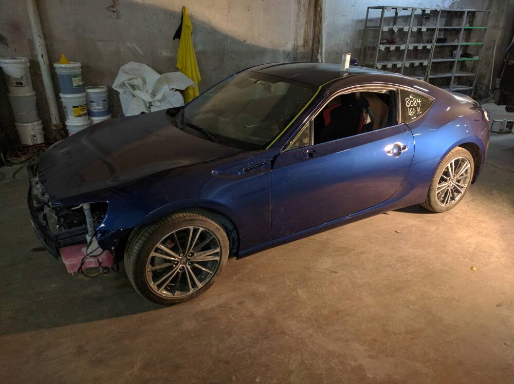

Hey everyone. My names Kunal, I'm 20 years old and I'm from Toronto. Little background on me: ive been doing auto body (bodywork and pepper, now apprentice painter) for almost 6 years now and I'm a certified machinist and now I'm in school for automotive design/industrial design.
The car: it's a 2016 Fr-s with 1035km. It was damaged in some accident and because I work in this trade I know how to fix this easily and properly.
This is going to a be a rebuild to original condition and then build into street/occasional track car. I eventually want to go all out with this car and enter more serious races and cage the car but till then it will remain my street car and weekend grassroots track car.

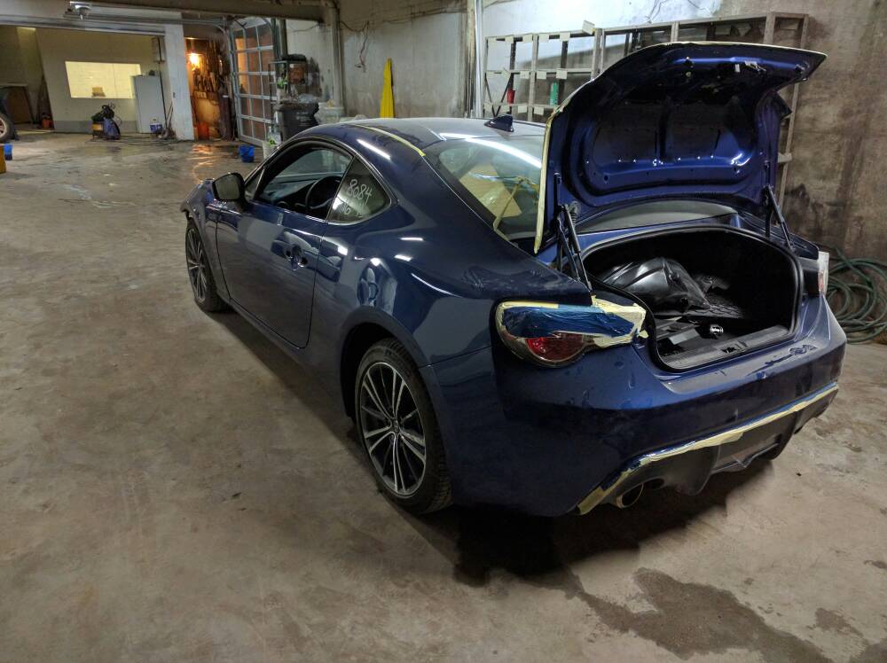

So the cars at my work place now. Boss is a real nice guy and is letting me keep it here and do all the work.
Got the complete suspension in from another crashed frs. Got my fender from the Subaru dealer locally. For anyone looking to buy replacement OEM fenders, call both Toyota and Subaru. Toyota quoted me $390 shop price and Subaru gave me the same thing at $270 shop price. Just waiting on my airbag and front bumper and I'll have this on the frame machine to be pulled.

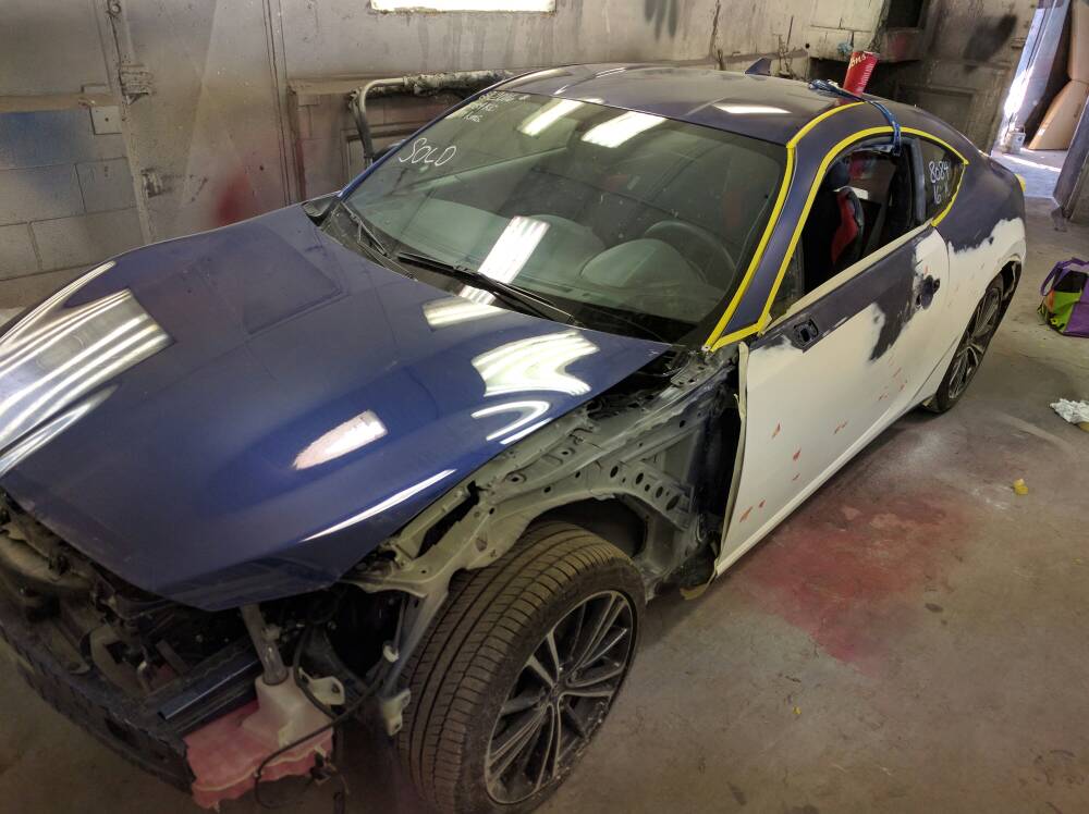

Got the car on the frame machine and all panels are lined up and everything is in OEM spec. Now it's my job to do bodywork and paint
