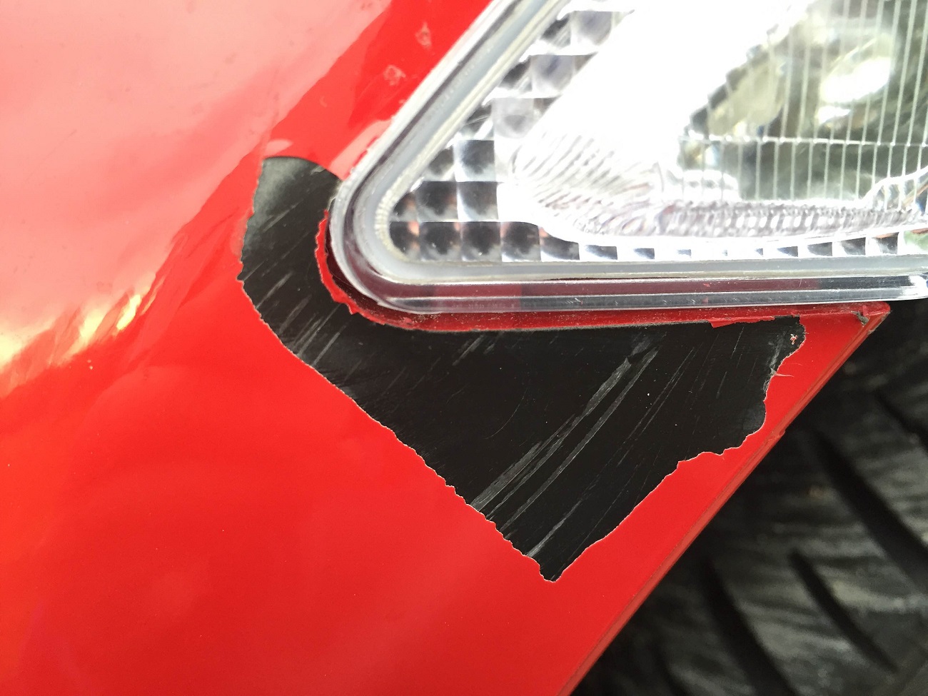

Any easy way to fix this?
Recently I got my car back from the body shop and they lost my left sidemarker. I put tape over the opening(dumb idea I know) until I could buy a replacement. Today when I went to install the sidemarker, I peeled off the tape and the paint ended up coming off with it.
Would there be any simple way to fix this by myself? If I have to, I'll take it to a body shop to get it professionally repaired but I really don't want to spend a lot for something this small.

spitfire481 05-02-2016 08:45 PM
They didn't use the proper prep for a raw plastic bumper. I'm assuming it was replaced either by them, or previously. This is really common. There are very particular procedures and materials that need to be used to guarantee proper adhesion on raw plastic parts

humfrz 05-03-2016 01:18 AM
Did that body shop work on the part of the car where the paint peeled off .. ??
If so, I'd take it back to them and ask them to fix it (make it right).

Tcoat 05-03-2016 08:35 AM
They lost the marker and you bought a replacement? They screwed up the paint prep and you are going to pay for repairs?
Hold them responsible. If they will not make it good talk to your local Better Business Bureau. All of these issues are on them.

to be honest most body shops will have the sidemarker fall off after they fix it, once you pull them they do not sit back in the bumper. Insurance companies will not pay you for new ones because you say they will fall out, you have to wait until they fall out to then charge them for the side markers. the smart move is to just break a tab off them if you're the shop.

Yeah this was a new bumper that they painted. Colorwise the paint was good but I'm a bit disappointed the paint peeled off just from some tape
i means the rest is gonna come off shortly that bumper is not sanded.
Yep, I agree ...... if tape will pull the paint off ...... sooner or later the rest of the paint will come off.
I'd suggest that you have them strip the paint off the bumper, prep it proper and repaint it.

They didn't scuff the bumper, at all..
RichardsFRS 05-05-2016 07:08 AM
Any body shop that just throws paint on without prep is a moron body shop. You can't paint bare plastic like that and it looks like what they did
Don't know how I missed this before but "new bumper" my ass!
To the best of my knowledge new bumpers do not come with huge scrapes pre applied.

If the paint wasn't heat cured in their oven (costs to run the oven) they may risk it and let it dry naturally. Looks like there may not be any plastic primer or no flex additive in the paint. Either way they should guarantee their work. If they don't re do it ask the owner the name of his lawyer so your lawyer can contact his. If you paid by credit card contact them and cancel payment.

it looks like the paint job wasn't very good for tape to take it right off.
you can try to have someone spot painted than sand down once paint settles 100%. than gloss coat the whole bumper to make it less noticeable, but it's recommend by almost all bl paint shop to repaint the whole thing for a solid paint job
