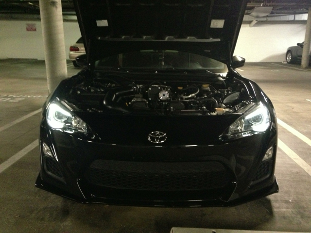

I followed Moto-Ps writeup (link in post 79, previous page); the wiring between the JDM GT86 lights and BRZ lights are very similar. There were two wires I needed to flip though (I can look at the pics later to see which two). I swapped the 8-pin connector on the BRZ housing to the 6-pin connector from the FR-S headlights. I used the BRZ turn signals, so I took the flying leads from the BRZ housing and soldered on a connector to connect to the FR-S chassis harness. My setup is essentially plug and play now. I have been running them for about six months now and absolutely love them. The only thing that doesn't work is the leveling motor, though I may look into utilizing it.
The turn signal housings in the bumper are still in place, but I plan on using them for fog housings (and the typical fog housings will be brake ducts).
I'd post pics now, but I don't have access to Flickr at work. There should be a pic or two in my build thread if you want to see what they look on the car, though I'm sure we know what it looks like all buttoned up.
