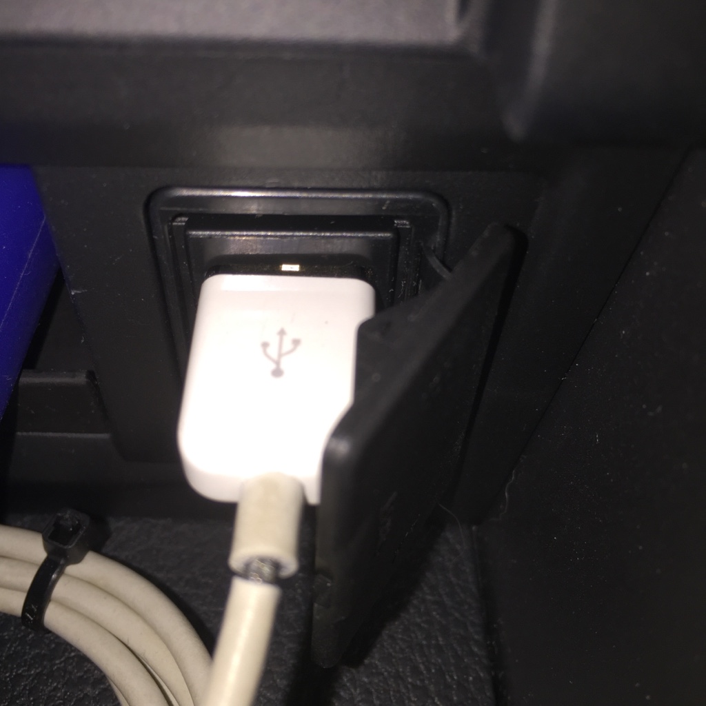

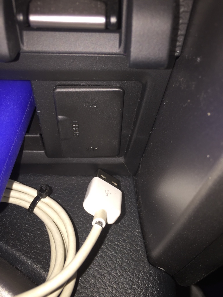

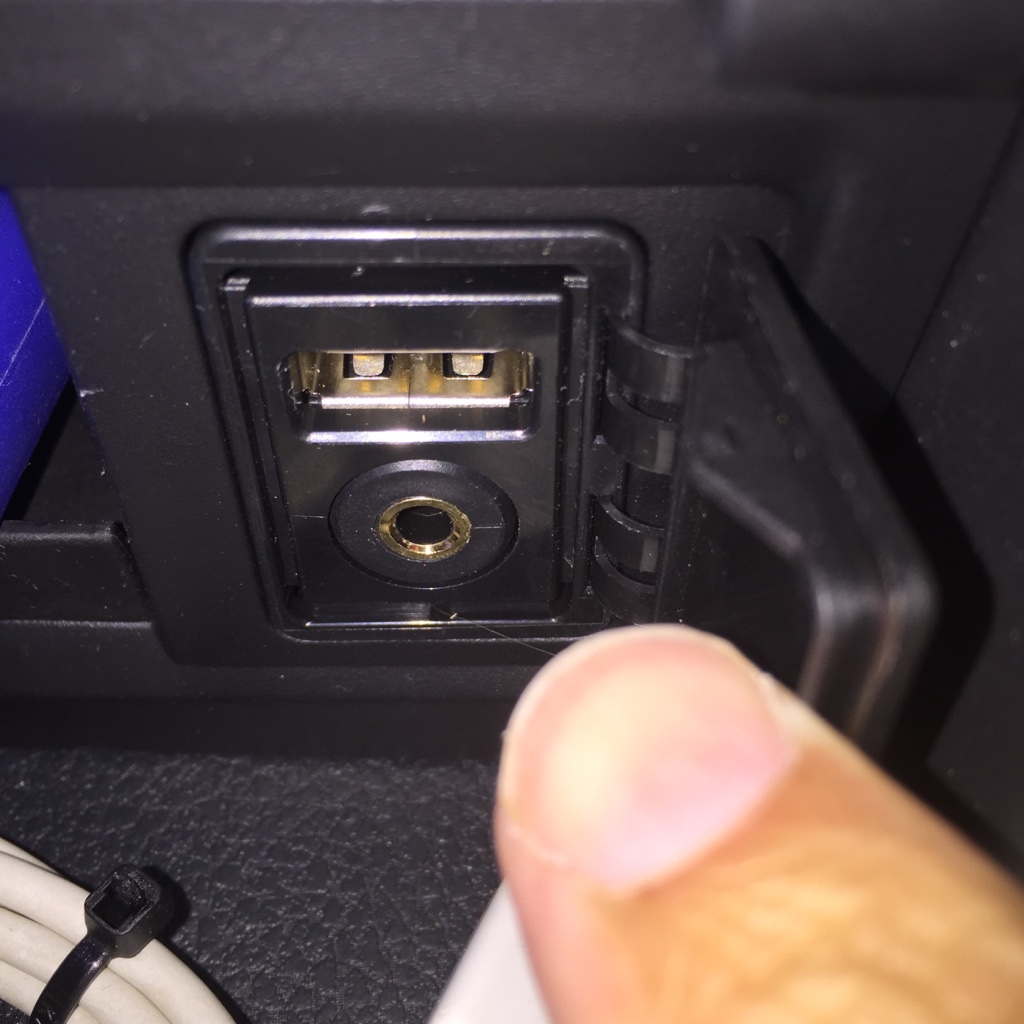

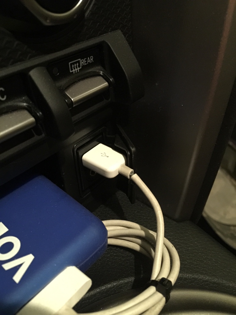

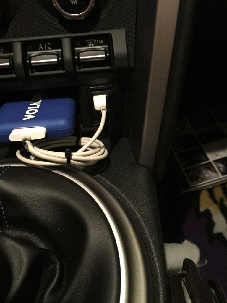

quality_sound 11-13-2014 09:47 PM
5 Attachment(s)
Attachment 95745Attachment 95746Attachment 95747Attachment 95748Attachment 95749
It really does sit exactly like OEM.
