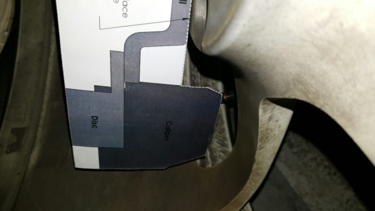

Checked the Sprint kit template against OZ superreggera knockoff wheel of 16x7j +38. It passed.
I am sure that my SSR Type C 16x7.5j +35 should pass also.
Did you ever happen to have a chance to confirm if the SSR Type-C 16x7.5 +35 cleared the Sprint kit template?
makinen 04-14-2016 05:09 AM
No.
But after looking into the inside of wheels, I thought Type C has more room than the other.
When I have a chance to get Type C's off, I'll let you know.

makinen 05-21-2016 07:58 AM
I have time to get a picture finally.
Attachment 137340
Enough room to clear Essex Sprint Kit.

driggity 05-25-2016 06:44 PM
Awesome. Thank you very much.
