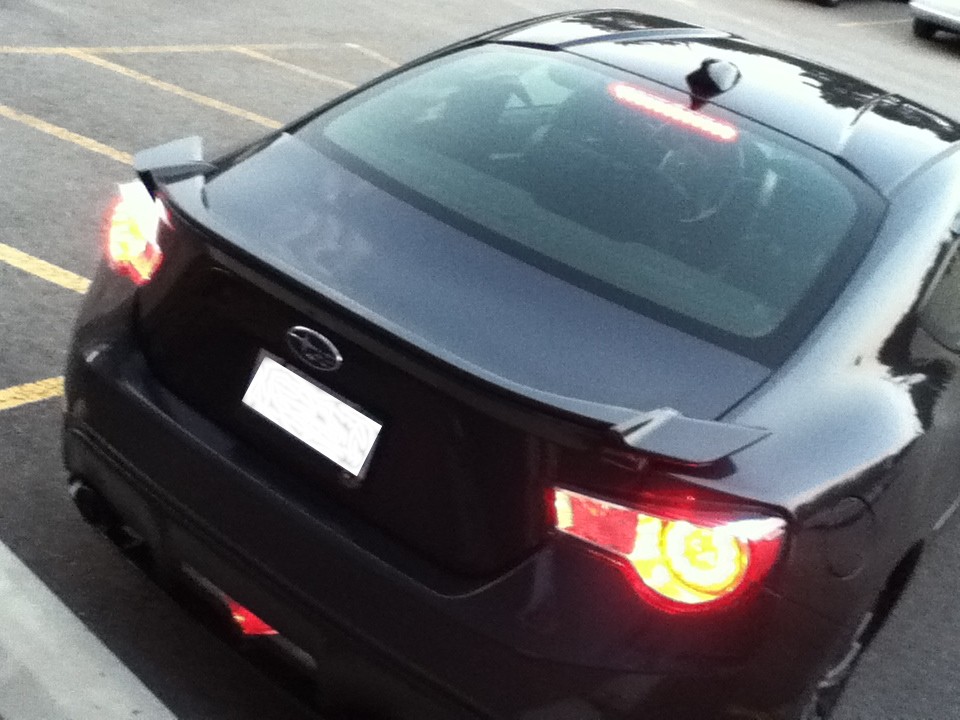

FLYFISHR 09-10-2014 02:02 AM
finally done
Followed OP's example and got it finished and and installed yesterday.
Attachment 90431
MemphisR 04-23-2015 04:17 PM
I don't suppose you would be willing to send me the templates you used for that, or sned me a rough diagram?
FLYFISHR 04-23-2015 04:59 PM
I will take measurements and pictures of mine in a couple of weeks when I drop the headliner to add some soundproofing.
FLYFISHR 04-27-2015 02:11 AM
hope this helps
15 Attachment(s)
I did everything as I went along with out any plans. hope there is enough info in the pictures to help.
