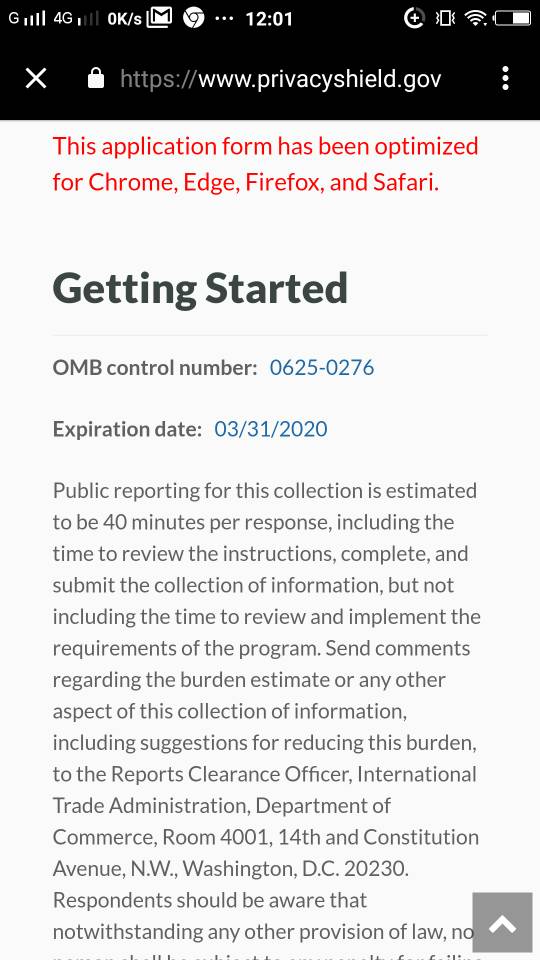

Solenwin2 05-05-2018 03:02 AM
Attachment 165987
Sent from my vivo Xplay6 using Tapatalk
