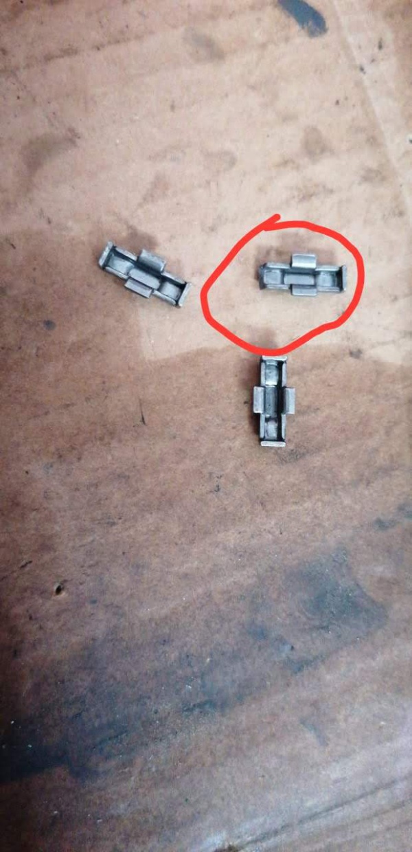

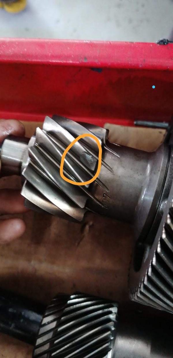

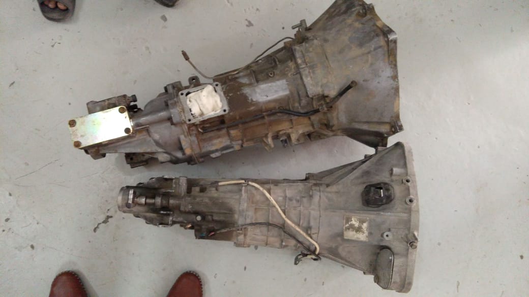

A few months after posting my last update I got a used f-body T56 that was installed in a 2nd gen GMC Sierra. I dropped off the transmission at the shop. On my way to the shop the next day in the 86 the stock transmission finally blew up lol. I lost 3rd and 4th.
Attachment 203550
Attachment 203551

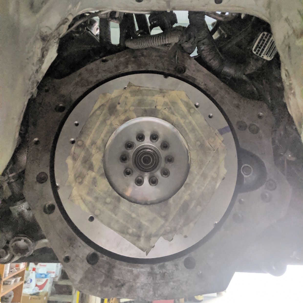

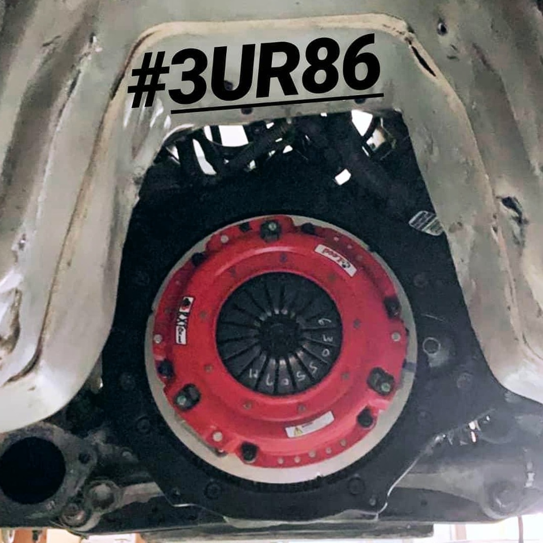

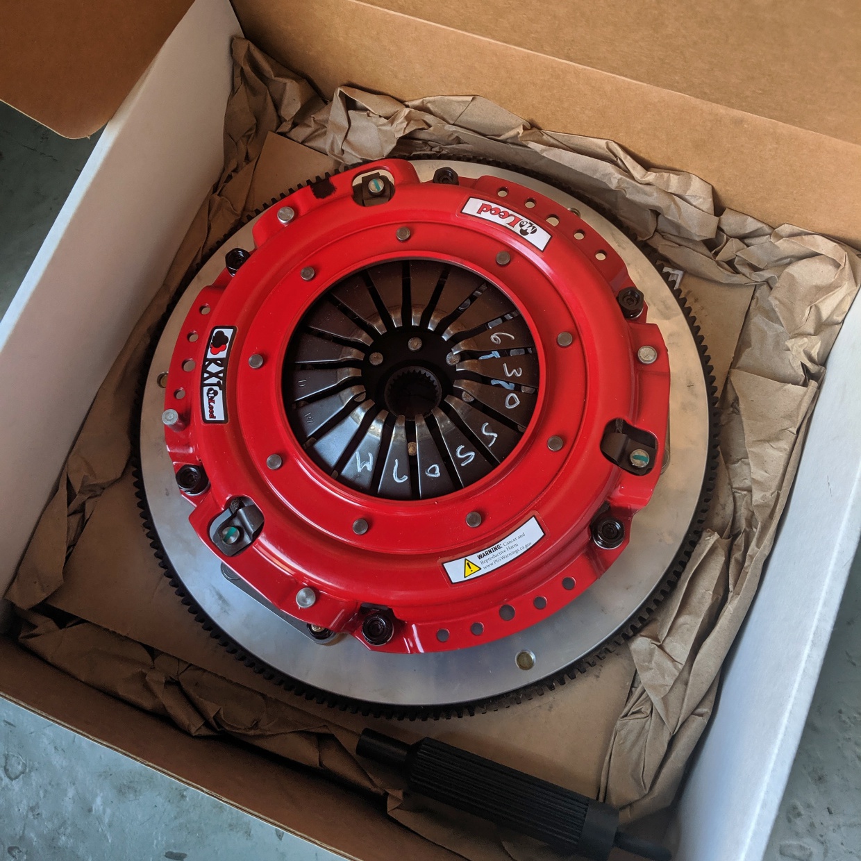

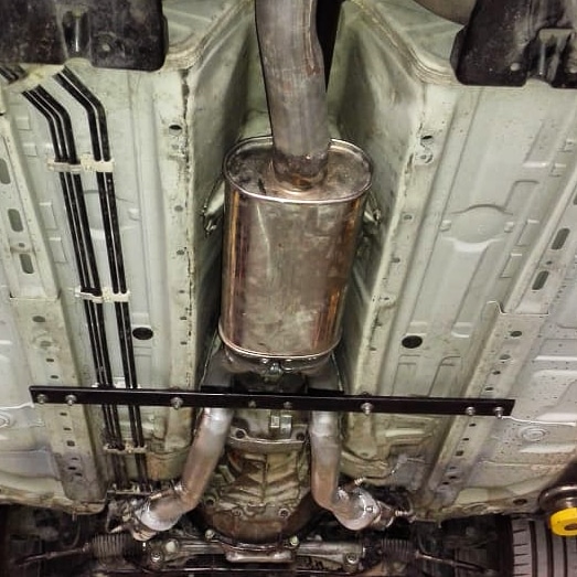

Due to the 3UR bellhousing being smaller than a chevy V8, we had to go with a clutch that is smaller in diameter. Ended up going with a McLeod RXT 1000. We had to remove the starter gear teeth from the included flywheel and trim it down. The bolt holes were filled and then redrilled to match the 3UR crank bolt pattern.
Attachment 203552
Attachment 203553
Attachment 203554

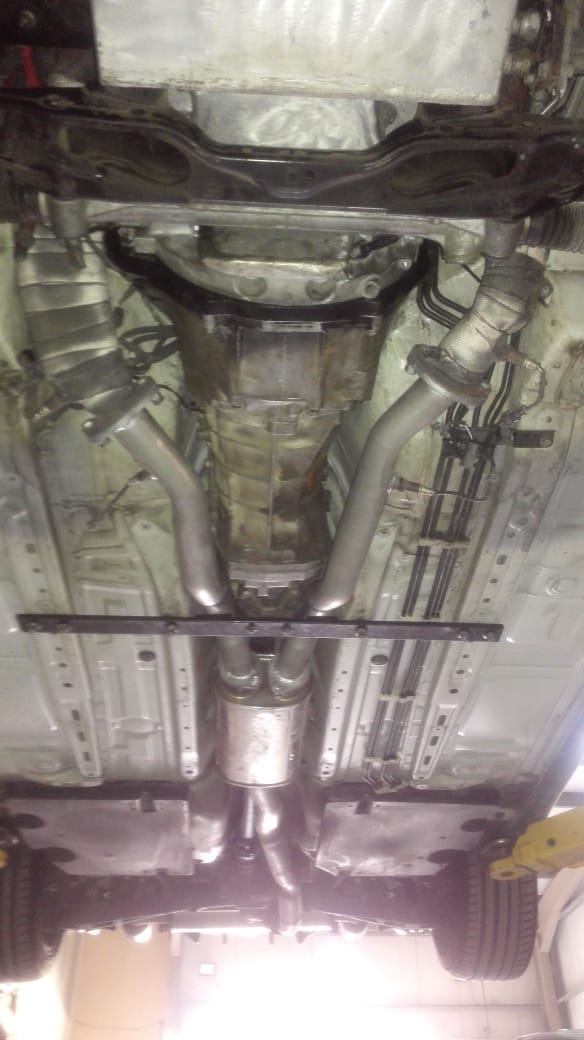

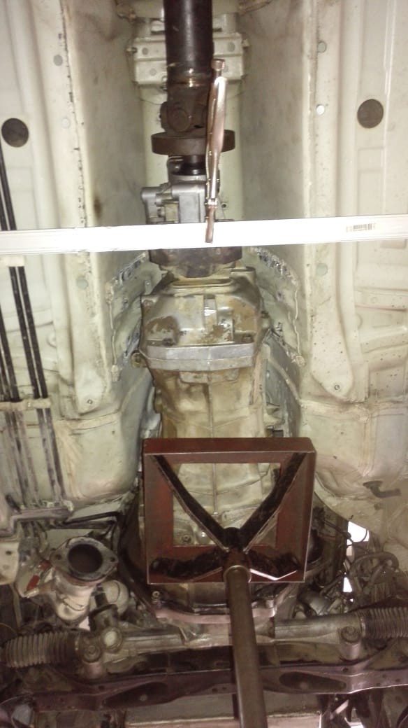

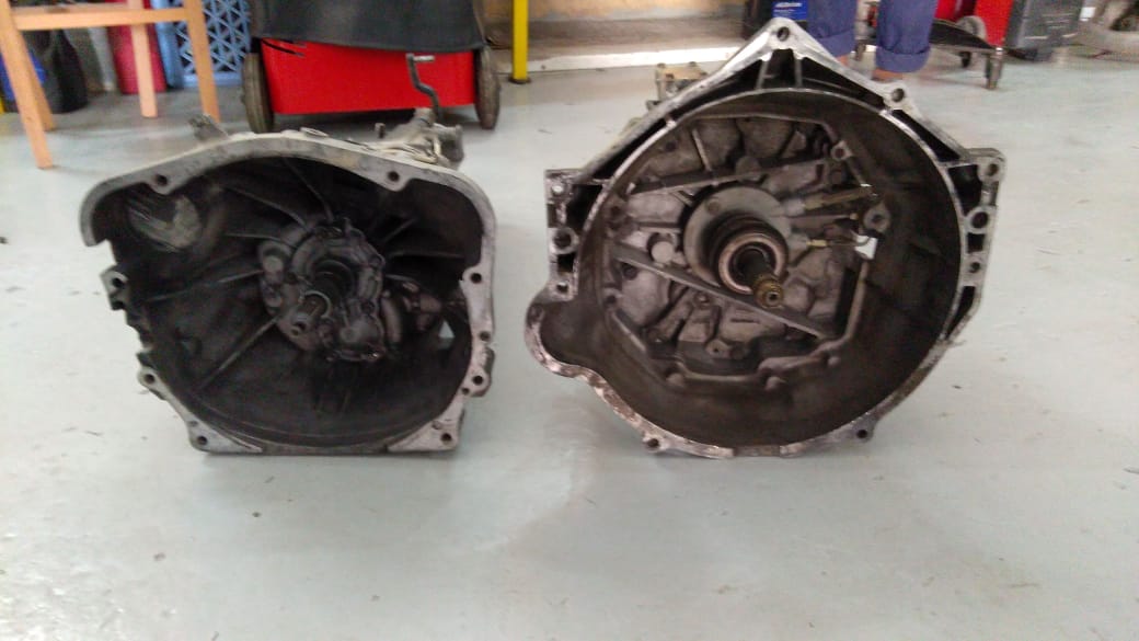

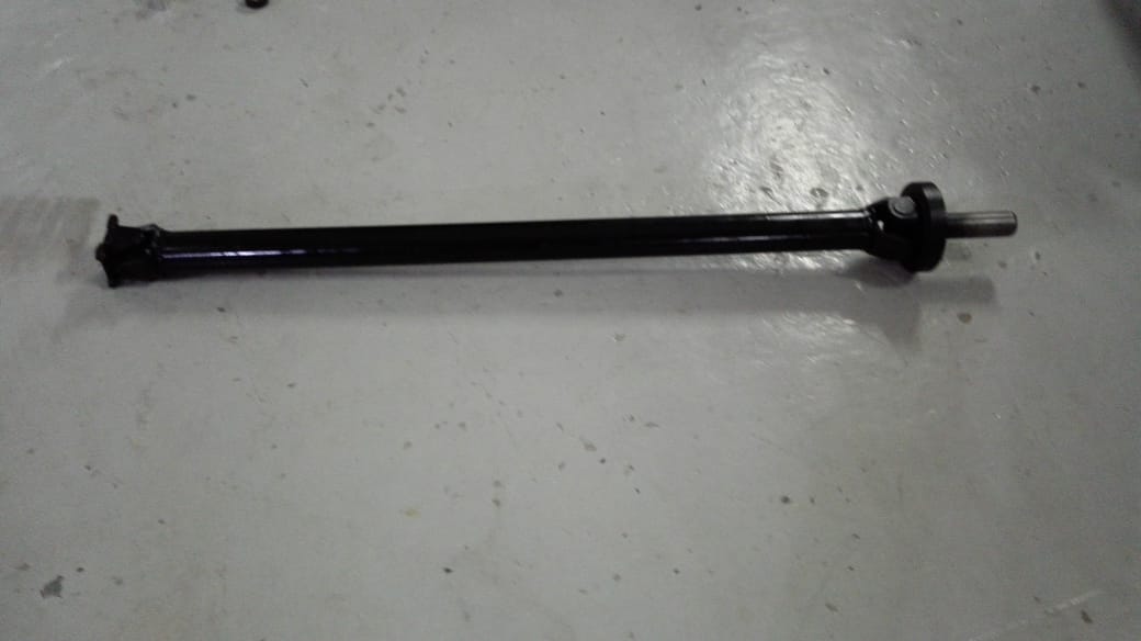

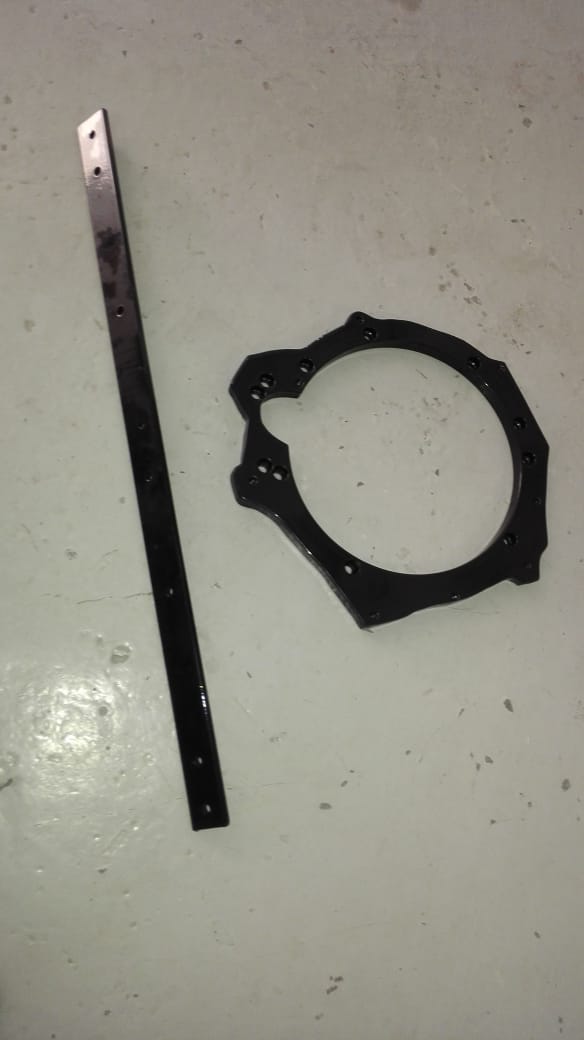

Here is the adapter between the chevy bellhousing and the 3UR along with a very simple "crossmember" for the transmission. It was literally an 8mm steel plate with holes lol. We also welded the u joint/slip yoke to the driveshaft and balanced it. The clutch master cylinder was recently installed in the GMC truck so we retro fitted it to work with the stock pedal.
Attachment 203555
Attachment 203556
Attachment 203557
Attachment 203558
Attachment 203559

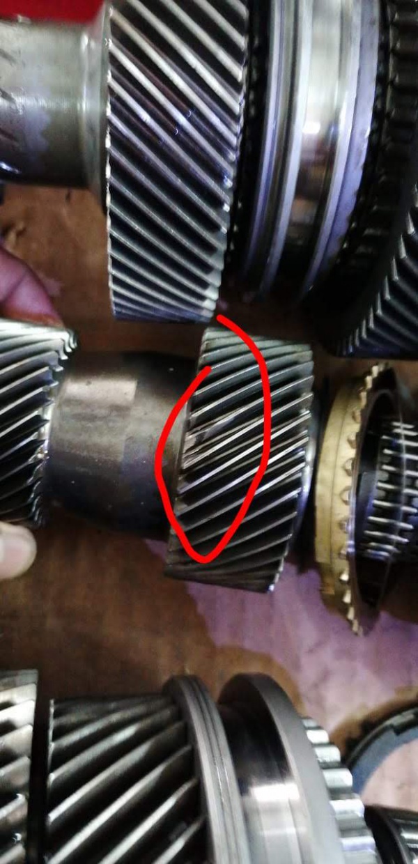

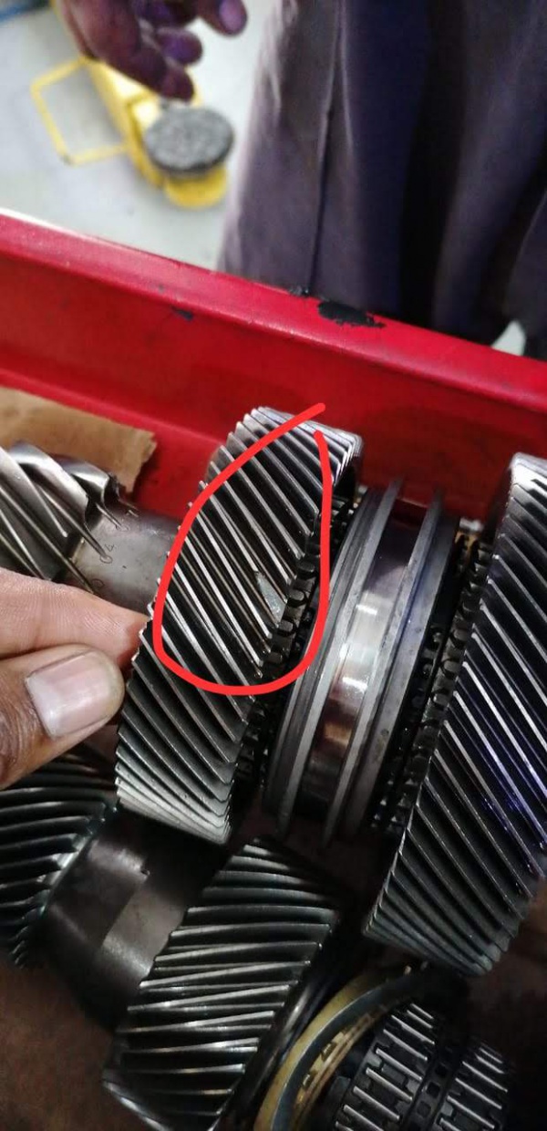

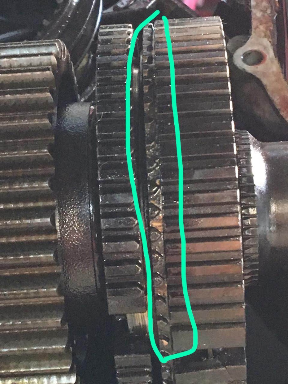

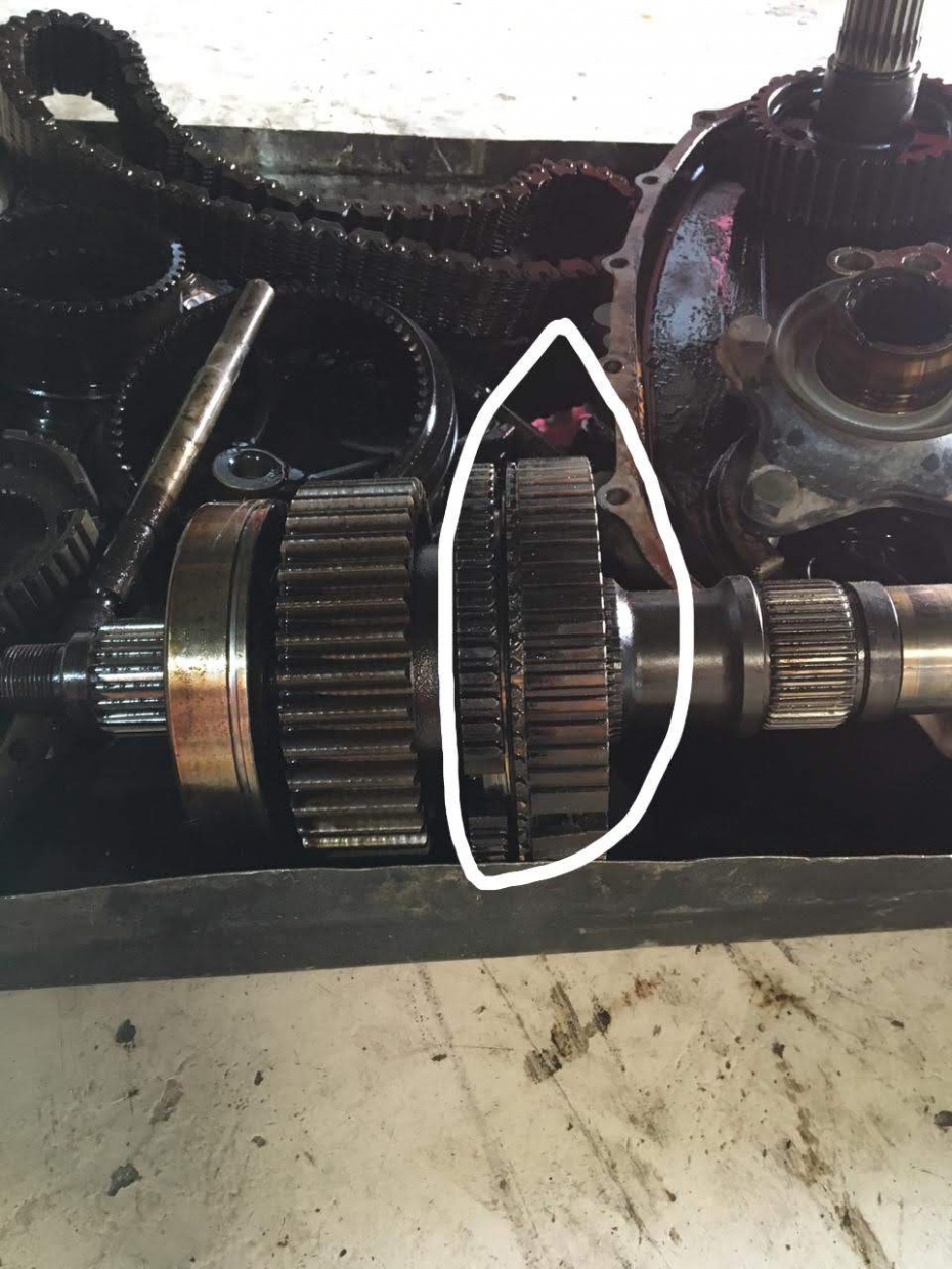

We had to adjust the shims behind the TOB a few times to get proper clutch pedal engagement and all seemed fine but it kept popping out of 4th gear and sometimes 3rd. We initially thought it was the old transmission acting up so we took it apart and found a few pieces missing here and there. I kept reading about the aluminum fork bending in old T56s so I got upgraded parts for it from tick performance hoping it would solve the issue with no luck.
Attachment 203560
Attachment 203561
Attachment 203562
Attachment 203563
Attachment 203564
Attachment 203565

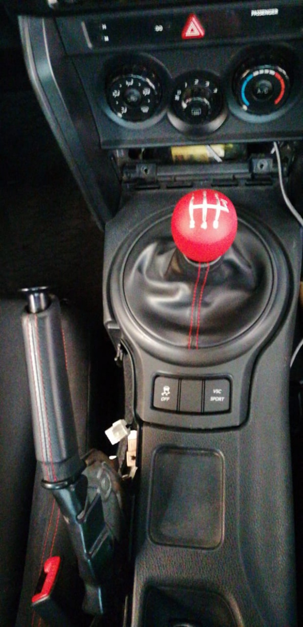

Anyway, I got an MGW shifter and modified it to sit in the right location along with a new Raceseng shifter and a reverse lock-out delete kit from RDE.

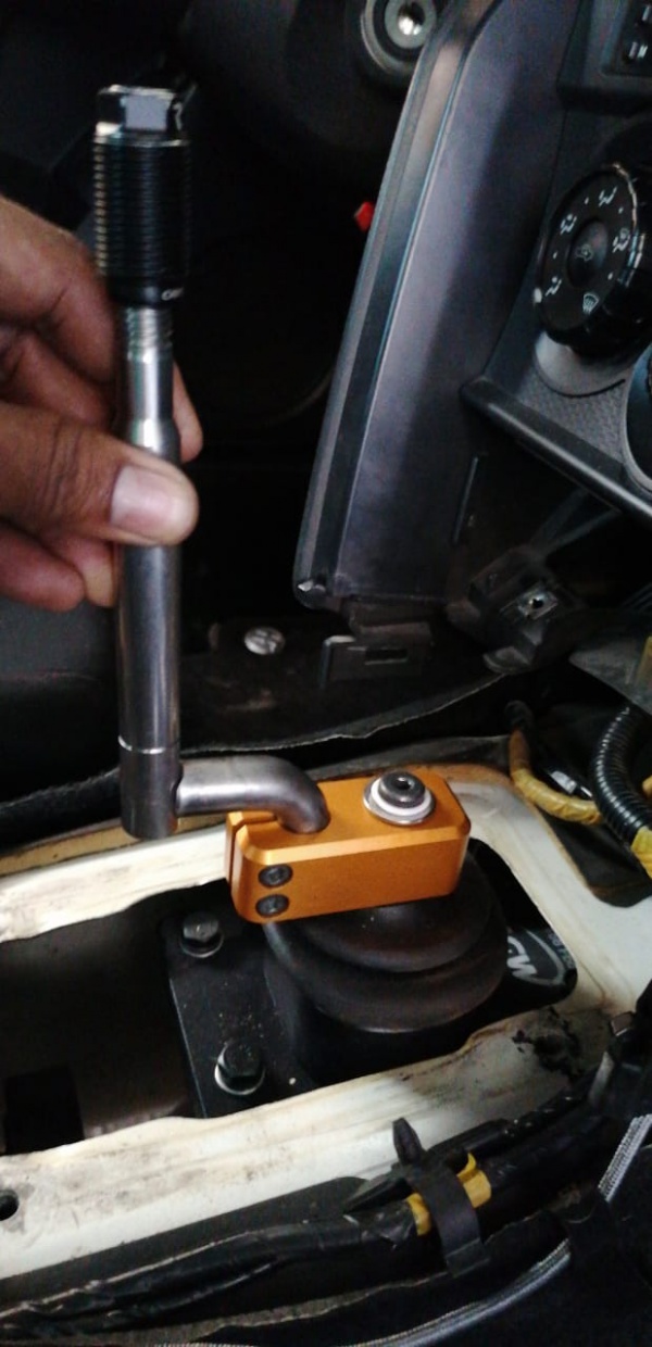

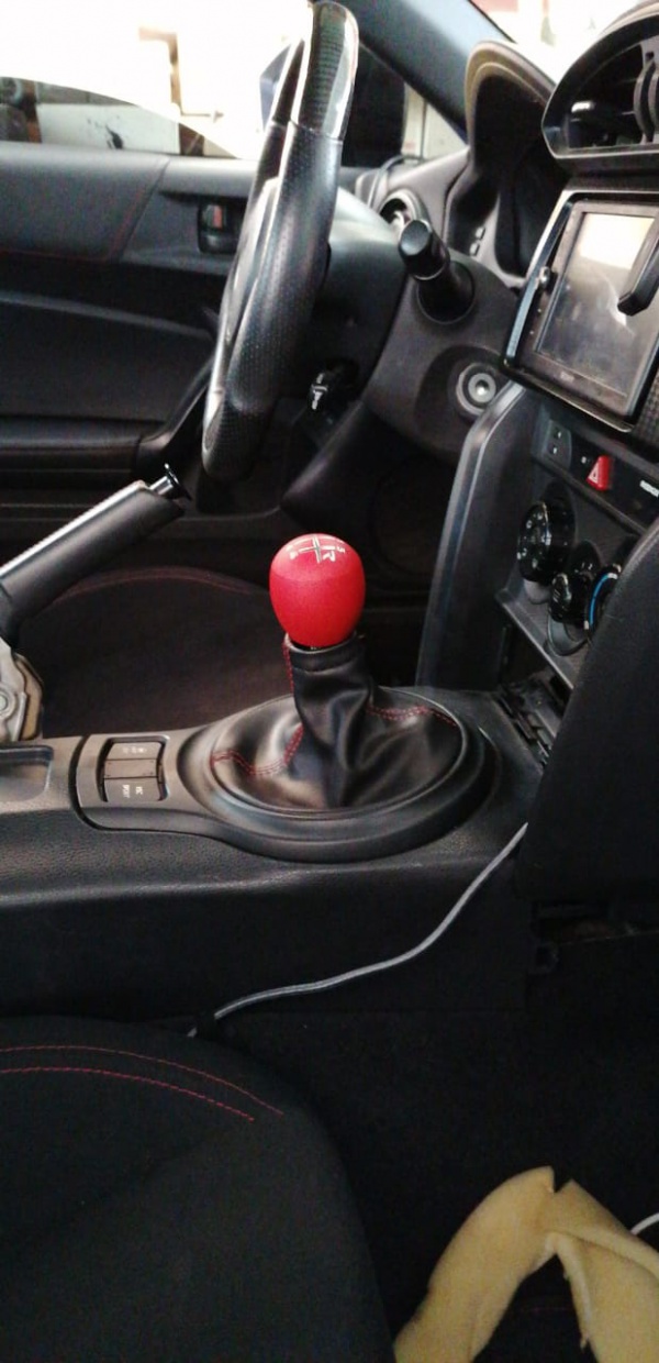

Attachment 203566
Attachment 203567
Attachment 203568

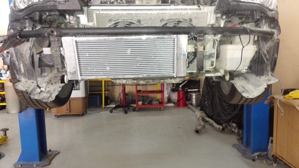

Meanwhile it was summer and I was struggling with coolant temps again. I already had a bigger radiator with 4 fans total but it still kept overheating when it's over 40c degrees outside. We all thought it was simply a capacity issue so I installed another radiator where an intercooler usually is. Not the greatest idea but wth. It made a huge differnce as it no longer overheated while driving but as soon as I was stationary for 5 minutes it would heat soak. It's not my daily driver so I just kept driving it at night and waited until winter. I don't have final pics of the radiator, you guys have to trust me that mount with the jank welding wasn't finalized lol.
