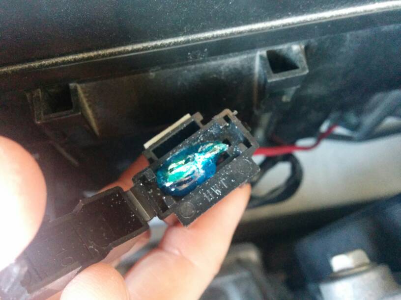

@nigel-jdmparts or anyone else who has had their fuse melt, how did you get the melted fuse out? It's completely stuck in there. This is after less than 2 month of being installed and only being turned on a handful of times.
Attachment 89267
outlaw121 08-28-2014 05:53 PM
Attachment 89267
I cut the old fuse holder out and solder a new one in its place with the same amp fuse
