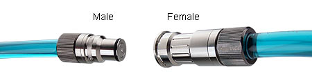

How do you get the oil removed from the cooler when you do an oil change? I'm planning on doing 0W-20 for streets and 0W-30 for track so I don't really want to mix them up.
CSG Mike 06-24-2013 01:29 PM
Pull off a line and drain it... or just mix the old with the new.
RAWR BRZ 06-24-2013 01:32 PM
I believe it will be a pita so just use 0w30. It will be much easier. Why 0w20 for street? Better fuel economy? Then remember that if you use 0w30 once then swapping it out for 0w20 youre wasting an oil change... You can use the same oil for at least 3 track days granted that its quality oil.
robispec 06-24-2013 01:33 PM
I take off a line at the take off plate add my custom an blowpipe adaptor and us air to push the fluids back into the engine gets about 90% of the oil out...depends on the coolers height and orientation..or if the fittings are on the bottom just drain the cooler directly (messy...usually)
Hanakuso 06-24-2013 01:37 PM
Yeah I would probably want to pull the line but it might get messy. I know with computer watercooling they have quick disconnects that make draining simple, but not sure if it's a safe idea in a car.
http://koolance.com/image/content_pa...sconnected.jpg
I just want to use 0W-20 for the street because a lot of times I only drive short distances and I probably don't get it warmed up enough. Then again maybe it doesn't matter because I rarely go over 4-5k
CSG Mike 06-24-2013 02:02 PM
Water cooling? Like... computer water cooling?
Just use whatever you'd use on track. The MPG hit will cost you less than the oil change cost.
