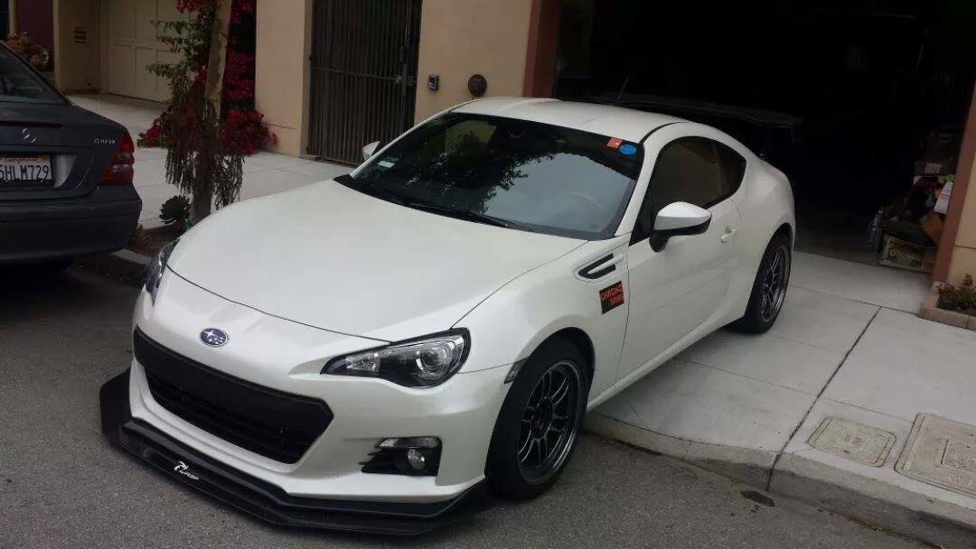

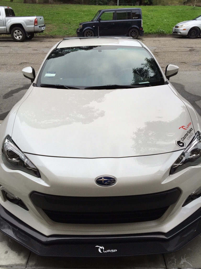

Had this splitter installed a couple months back. Works well with my Voltex S1 wing. Use to have just the wing and it had a lot of understeer. The car is a lot more balanced now. Looks great! I have it installed under my STi rep lip.
I have more pictures of install. I'll post later

What size splitter is that?

This is the 5" track splitter. It looks smaller in the picture because of the extra lip I have on.
