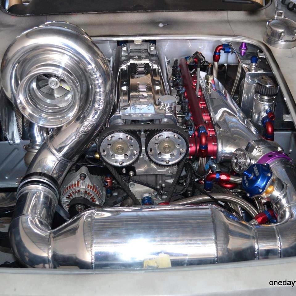

Have any of the overheat issue twins tried a air-water cooling option? Would open up the radiator to more air... Not sure what the downside is, im sure theres other up sides though
Air to water means terrible heat soak or trying to keep 25+ pounds of ice cold for a day.
It's a worse option than doing air to air and getting a proper radiator and a good oil cooler.
jshadeck 05-14-2013 10:48 AM
The only time i saw ice used was for drag racing. I didnt realize the second radiator/coolant system heat soaked that badly... Was just an idea, prob stuck in my head cause i saw this the other day..
