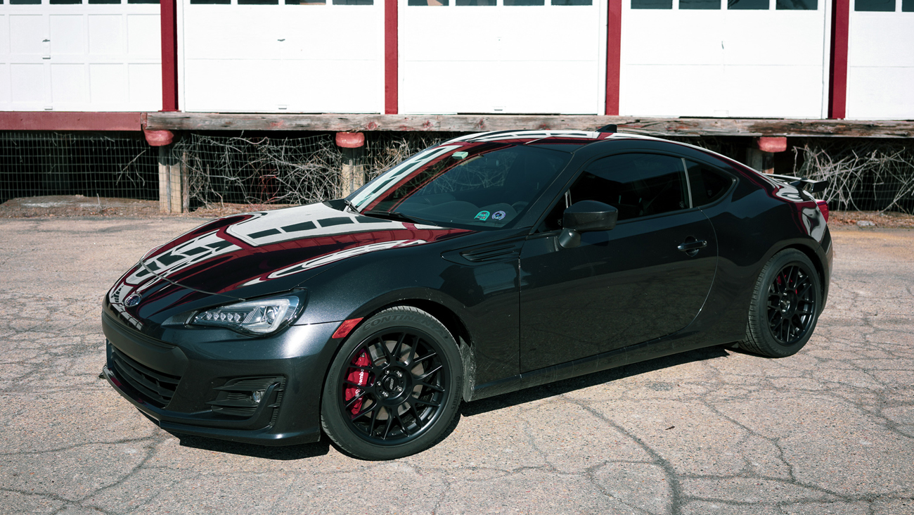

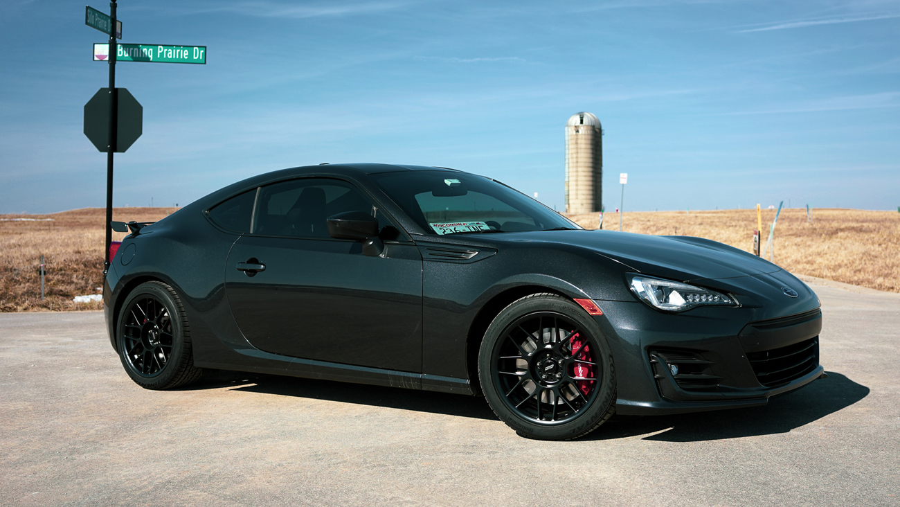

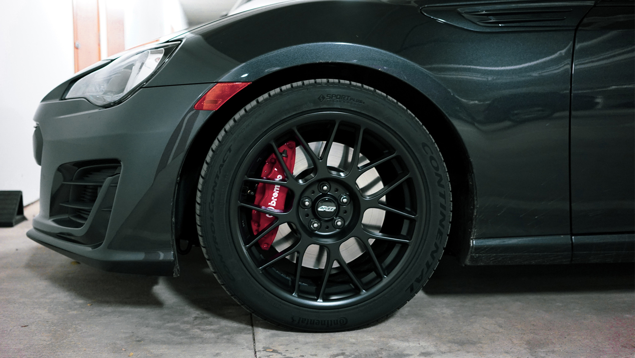

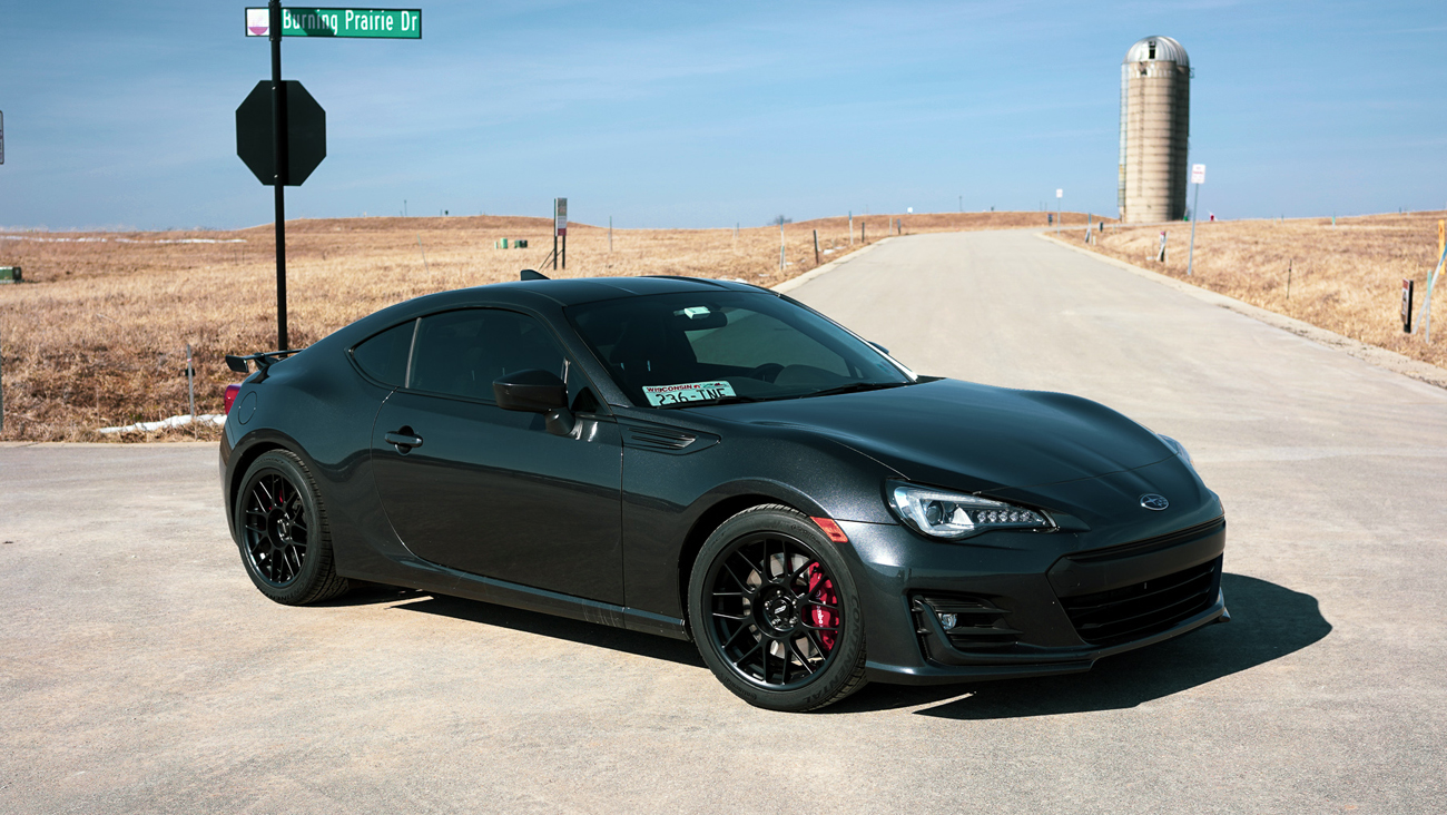

Satin Black Apex ARC-8s - Dark Gray BRZ PP
5 Attachment(s)
Satin black ARC-8s on my Dark Gray PP BRZ. I participated in the most recent group buy to get my hands on these, and I couldn't be happier. This is exactly the look I was gunning for! Getting $150 off and free shipping was a cherry on top.
Attachment 185371
Attachment 185372
Attachment 185373
Attachment 185374
Attachment 185375
Satin Black ARC-8 17x9
245/40/r17 Continental Control Contact Sport SRS tires
Eibach Pro Kit springs - otherwise stock suspension
Factory performance package Brembos & Sachs Dampers

Your car looks great! What are your alignment specs? Did you use camber plates or bolts?
