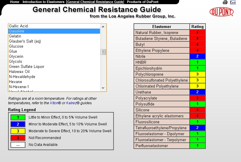

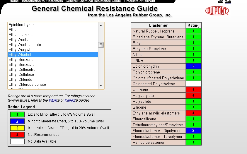

Allch Chcar 08-03-2013 05:47 PM
2 Attachment(s)
Originally Posted by robispec (Post 968495)
.. It's interesting how using 100 octane race fuel gets twisted to "fuel aditives" ...
I don't care about who's right and wrong here. But what you used before E85 could very well explain why you had filter degradation while other people running E85 for thousands of miles aren't having this problem.
All it would take is some Toulene to eat through a paper filter.
Originally Posted by DYOLF26 (Post 1057395)
Filters
Since alcohol-based fuels tend to carry more water than gasoline, the filters can't be water-soluble. Paper is more sensitive to exposure to water than other materials, so they should be avoided unless the manufacturer states it is alcohol friendly. Most of the top-shelf filters use a metal or plastic screen to catch debris. Another issue with the filters can be the O-ring style fittings. Some O-rings not designed to work with alcohol will dry out.
You can believe a bunch of grease monkeys using conventional wisdom. Or you can believe chemists who know what they're doing. :iono:
Attachment 46648
Attachment 46647
