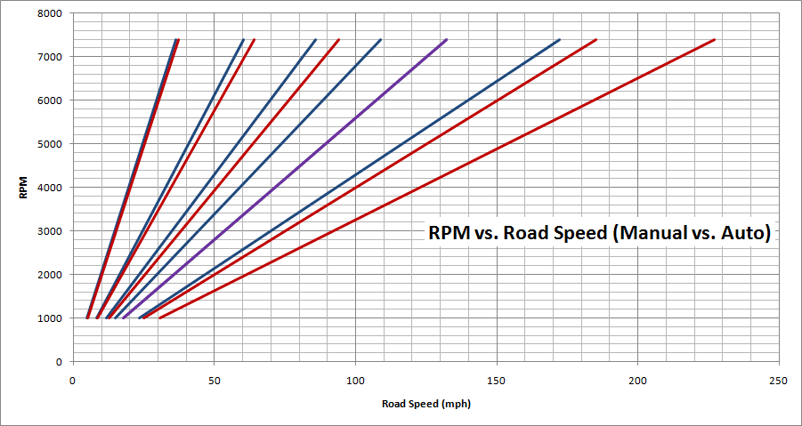

Given that you are losing maybe 2/10ths per shift by shifting manually vs the auto, the 1/10th slower time for the auto on the 5-60 means the auto's "real" time for the run is slower by about 1/2 second (assuming 2 gear shifts to 60) - that seems in line with the 10whp loss figure claimed.
Torque trough lies between 3-4.4K (see below):
Attachment 25680
To correct my earlier comment, you actually never really get into the torque trough with either tranny on a redline upshift except for the 1-2 shift on the auto, but you do always lose more power on upshifts with the auto (see relative speed vs rpms for the auto vs the manual below). And you get closer to the torque trough on the 2-3 auto upshift (at 4900 rpm) than on the higher-speed 3-4 or 4-5 shifts (5200 rpm for both). The manual drops down to only 5800 on the 3-4 upshift - less loss of power. It's also 300 rpm better on the 2-3 upshift, and 900 rpm better on the 4-5 upshift.
Attachment 25681
Captain Insano 01-18-2013 02:50 PM
Good data, but we can agree to disagree. The "real" difference of a 1/2 second you mention is in fact not real. The real measured difference is a tenth of a second as measured. You and I do not know how fast the motortrend driver shifted the MT. Not a safe assumption you are making!!
You could also argue the longer gears in AT the car wont be shifting as much which might help on certain autox or road courses. Ironically, power isnt the point of this car. Balance is. In a straight line if you can get a 1.7 or 1.8 60' in a MT during a 1/4 mile run and a 2.2 - 2.5 60' in a AT... Thats over a second on the end of the run. Right about the diff between both in many of the tests. Thats why I think it is mainly the launch.

When a launch is factored out, the difference in acceleration times to 60 are minimal. The auto's taller gears do put it at a disadvantage at the car's upper speed limit.
The disparity between the 0-100 times is a bit surprising given what they recorded for the quarter miles. *shrug* Then again the auto runs out of energy 11 miles per hour earlier.

The top speed for the auto was in "auto mode", I wonder if it was kept in 5th gear in manual mode if you could get a higher top speed. Maybe have to do a "personal" test.

I'm not convinced there is much if any difference between sport and normal auto when you're in kickdown. As far as in manual, if you time your shifts spot on there is probably little difference, however in manual mode there is of course the possibility of short shifting it or banging into the rev limiter depending on what mode you are in.
My guess is they left it into auto mode for all tests. For example, where I put the 30-50 and 50-70 times for the auto, C&D actually still called it "Top gear" as if they manually stuck it in 6th and put the pedal down. Obviously based on the times that is NOT what happened so I took the liberty of modifing the title. I figure if they ran it in full auto there, I would tend to guess they'd do it in the other sprints as well.
I am curious to see what would happen between the MT and AT if they both went at it from say, 80mph. Makes me wonder if the auto truly does run out of steam at 125. That top end performance definitely seems lacking, but then again I rarely see triple digits, don't street race, and a good percentage of my driving is highway where a few extra mpg's and less noise never killed anyone.
Aside from my sneaking suspicion the toque converter allows for some slippage at lower rpm's, I am still very happy with my AT thus far. I am wondering if Visconti or any other ecu tuners can access status info for the transmission. Anyone know?
