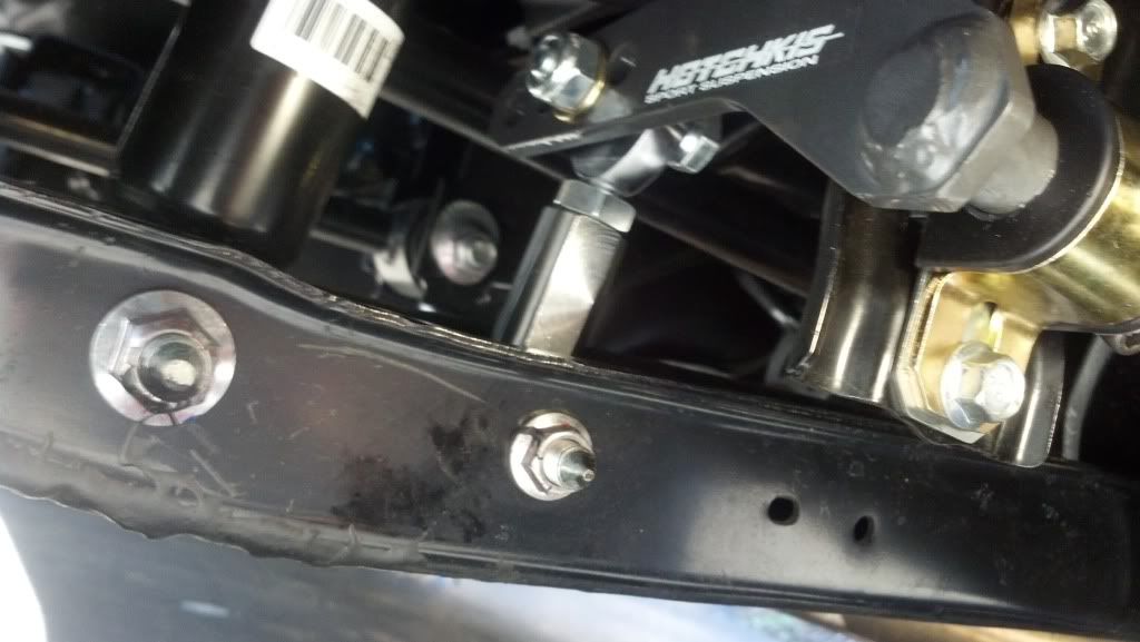

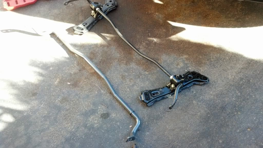

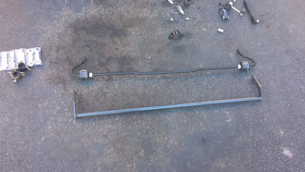

I woke up early and got to work on installing the Hotchkis Sway Bars.
http://i271.photobucket.com/albums/j...g?t=1358627845
The kit comes with everything you need unless you wanted to buy new front end-links (rears are included).
The sway bars are high quality and so are the components. My only knock is the instructions are for the most part pretty awful. It's an 8x11 folded in half and the photos are in black and white in horrible resolution (and since many of the parts are dark, you can't see anything). They should have done a better job with describing things or offer a .pdf on the website with higher quality photos. One of the photos are incorrect, I lost about an hour of time having to figure out how things were suppose to go together up front. The job is probably a 3-3.5hr job. I had jackstands and a basic socket set, so nothing special.
Front: 25.4mm (I set it to 630 lbs/in - 245 % Stiffer than Stock)
Rear: 19mm (I set it to 520 lbs/in - 385 % Stiffer than Stock)
Driving, the car is very direct. All-body roll is gone. The turn-in is phenomenal. I suppose I could soften up the rear but it rotates a lot more than stock. I think with a better tire set-up it would match very well. The one thing you will realize right away is how bad these tires are.
Rear Comparison vs OEM:
http://i271.photobucket.com/albums/j...g?t=1358630328
Front Comparison vs OEM:
http://i271.photobucket.com/albums/j...g?t=1358630342
Finished product (rear):
http://i271.photobucket.com/albums/j...g?t=1358630350

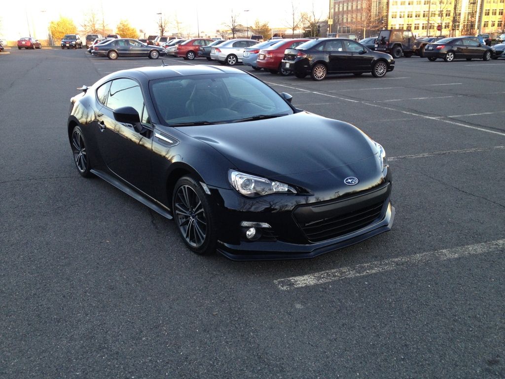

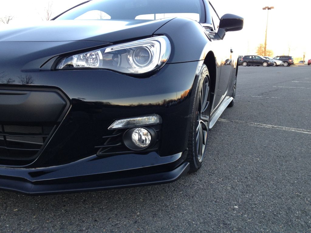

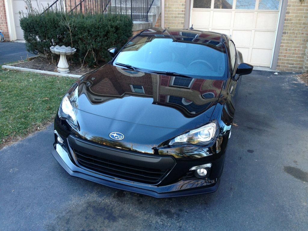

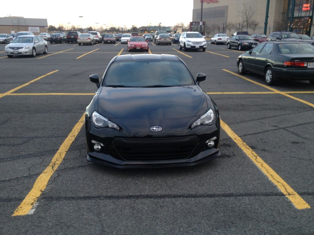

I also had time to install my front lip. I just drilled holes and I love it looks good. My drill wasn't strong enough for the side-skirts so I need to figure something out there.
http://i271.photobucket.com/albums/j...g?t=1358627851
http://i271.photobucket.com/albums/j...g?t=1358627867
http://i271.photobucket.com/albums/j...g?t=1358627857

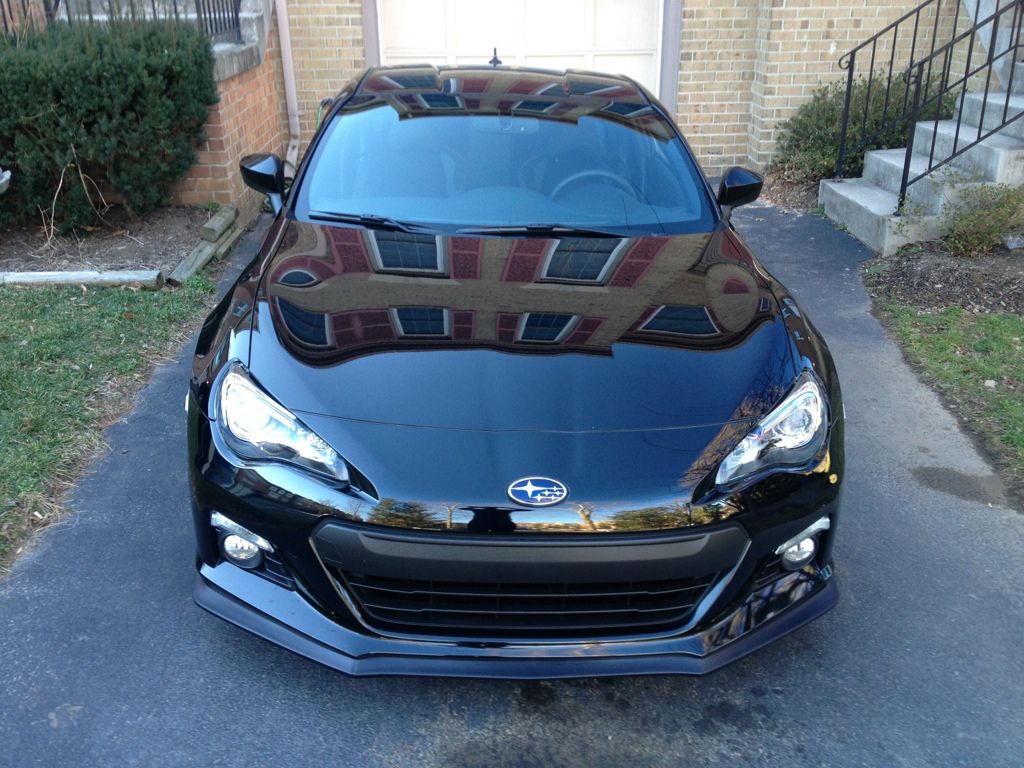

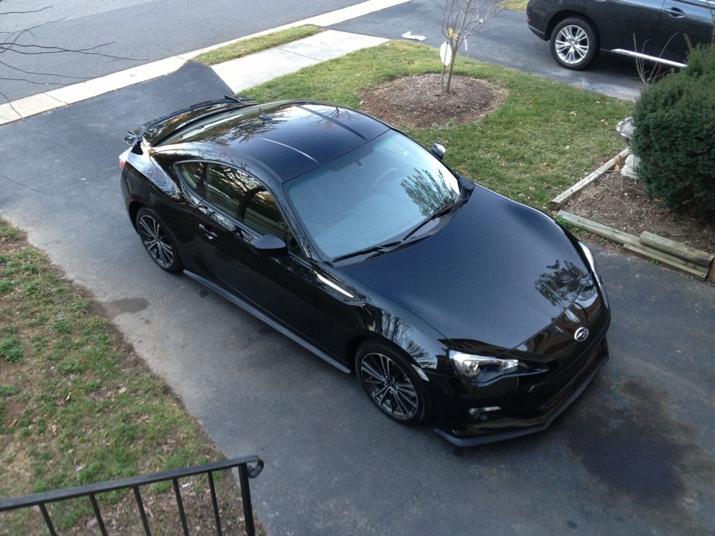

For those interested I took a bunch of pics as the sun was starting to set. I swear this lip really changes the look in person. I'm use to getting a head turn here and there. I went out twice with it on and people are stopping and taking pictures and looking at it like it's a Ferrari.
http://www.ft86club.com/forums/showt...975#post675975
IloveBaldEagles 01-19-2013 11:48 PM
Looks great! Simple mods make the car better. I'm definitely going to steal ideas from you without your permission!

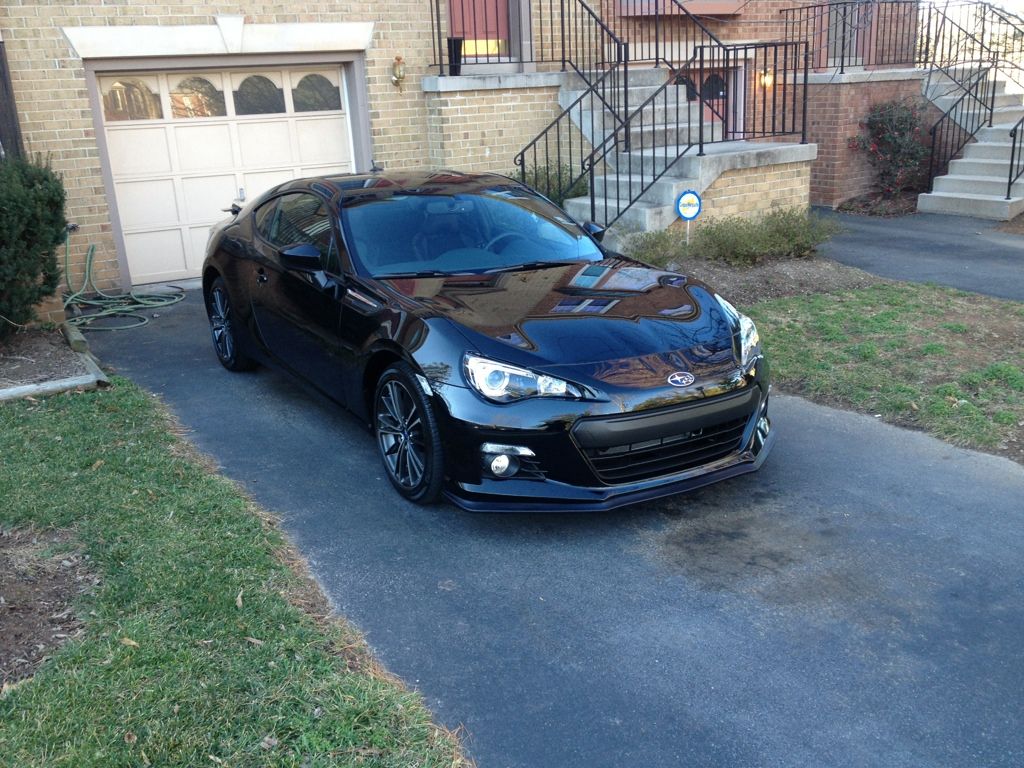

I ended up installing the side skirts today. I love the look, it really is smooth. The car is going to look super aggressive but clean once I lower the ride height and swap out the wheels.
For others who are worried about drilling holes, once you do it, you feel fine about it. I was a little hesitant at first but did a real clean job and if you ever had to patch them up it would be super easy.
http://i271.photobucket.com/albums/j...g?t=1358719284
http://i271.photobucket.com/albums/j...g?t=1358719295
http://i271.photobucket.com/albums/j...g?t=1358719304
http://i271.photobucket.com/albums/j...g?t=1358719461

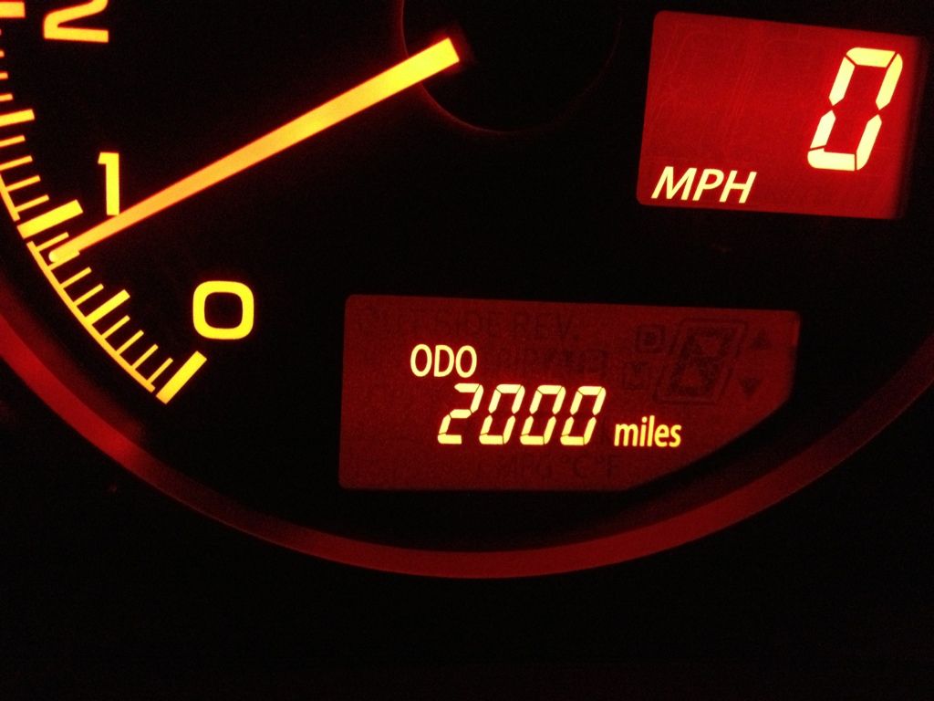

I broke 2K miles last night:
http://i271.photobucket.com/albums/j...g?t=1359552352

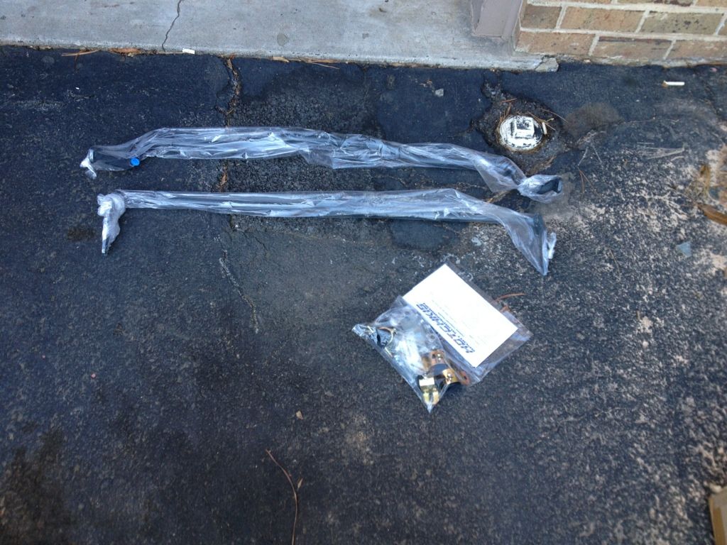

My Password JDM Strut Tower Brace came and I installed it (took about 10 minutes).

Unboxed:
http://i271.photobucket.com/albums/j...g?t=1360016492
One side down (comparison):
http://i271.photobucket.com/albums/j...g?t=1360016493
Finished product:
http://i271.photobucket.com/albums/j...g?t=1360016498

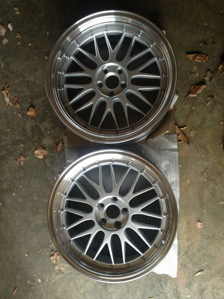

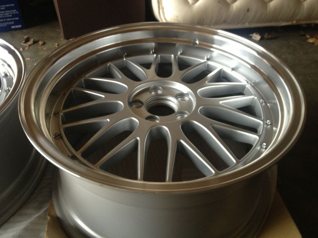

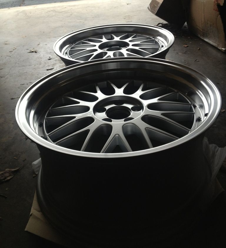

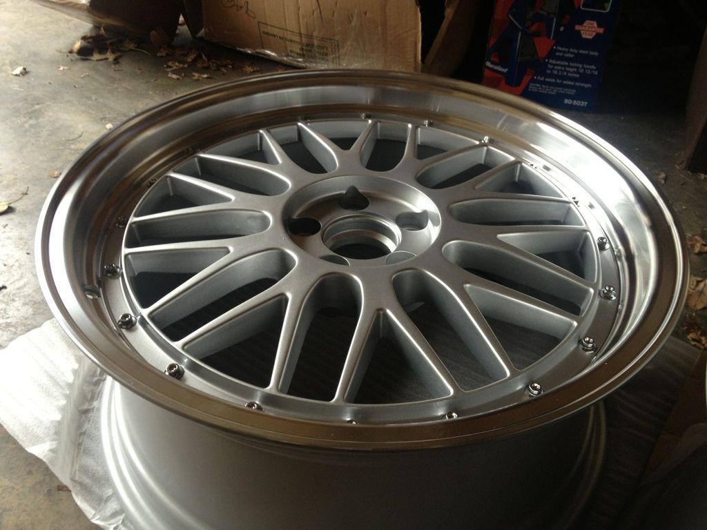

- Ordered a set of ESM004s (quality BBS LM replicas) in 18x8F and 18x9R. The front has a 1.5" lip and the rear has a 3" stepped lip. I'm excited to get these but they will likely sit in my garage for a little while. I want to get the Eibach R2s in and on the car and run a little more rubber off. I'm hoping to get a set of discounted Direzza 1s with the new 2s coming out.
