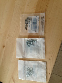

I'm preparing to do the hella install today on my FRS.

i went to a Home Depot and picked up a Bolt, washer and nut. I brought one of the wires with me and got a bolt that fit.
mit_peid 02-23-2013 01:10 PM
Yeah just came back from Lowe's and picked these up. M5-.80 x 16's with wave washers and hex nuts. Going to try to use these for grounding of both the high and low. They're 8mm hex not 10mm. Hopefully they'll work just as well. Forgoing the Hella-provided relay too for my install. Attachment 28940
