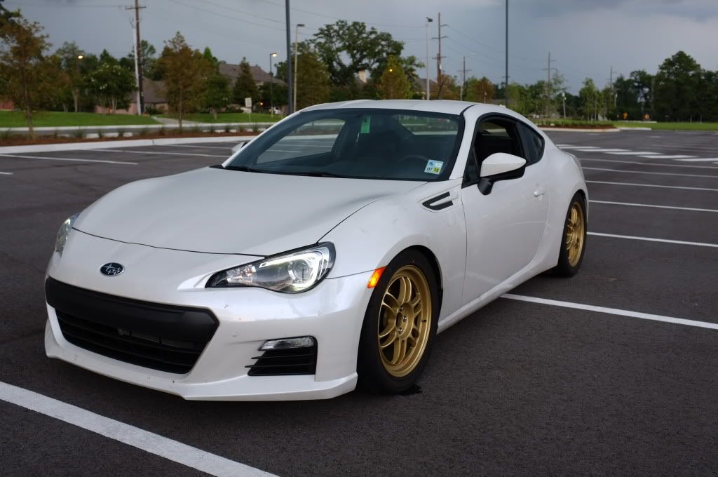

Originally Posted by -max- (Post 362338)
Get them done Mitch?
I'm down to 3/2 on compression and 2/1 rebound fr/rr for daily driving and the ride is pretty awesome.
Still playing with settings. Min rec ride height front and back. No rubbing. I'll start playing with shock settings when it dries out a bit.
http://i865.photobucket.com/albums/a...z/DSCF2128.jpg
http://i865.photobucket.com/albums/a...z/DSCF2103.jpg
-max- 08-06-2012 10:20 PM
You plan on raising it up? 1-1.2 inches is what I'm seeing people drop it.

I might raise it up for events. The M3 is lower and did well enough at events, so my perspective on "too low" is skewed.
-max- 08-07-2012 06:06 AM
It varies from car to car, but the main thing is to make sure the control arms are at least parallel to the ground. If you go past, you run into bump steer issues. Which is kind of hard to tell without a lift.
