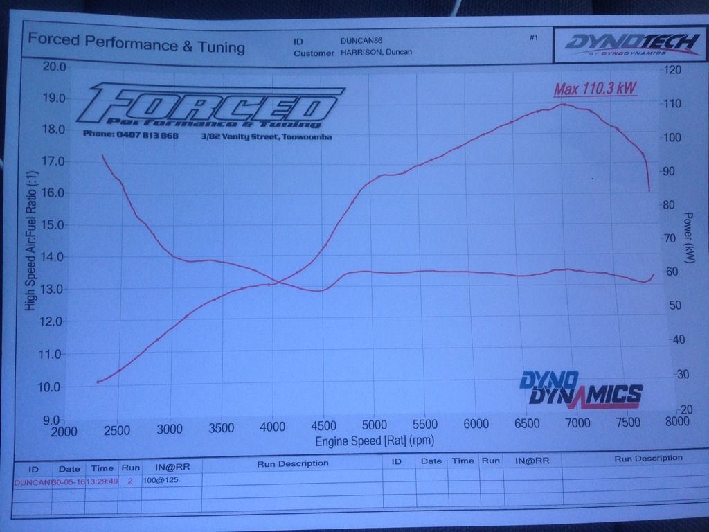

yes my motec is locked. only headers, no cat, big pipes.
No i can't unlock it.
did a dyno run and it appears to run lean.
I am trying to ascertain why and if there is anything i can do about it.
I see people run anywhere from 11.5-12.5:1.
Mine is 13.5ish!
Crunk81us is offline   Reply With Quote

Their is no reason an NA car should run lean due to maxing out fueling even on E85 their is plenty of headroom.you jist nned to get the tune fixed, i assume the motec should be able to run both pi\di fueling systems.
why do you need a motec for an NA car seems way overkill ?
