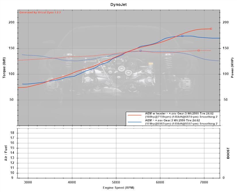

I did a few data logging sessions before and after the header install. Take this with a grain of salt, it's a virtual dyno with values loaded from a ebay blueooth OBD II reader to my android. (Real dyno coming next Sat)
Red line w/ header, blue line w/o header...you can see the torque flatten, first time it's looked like that:

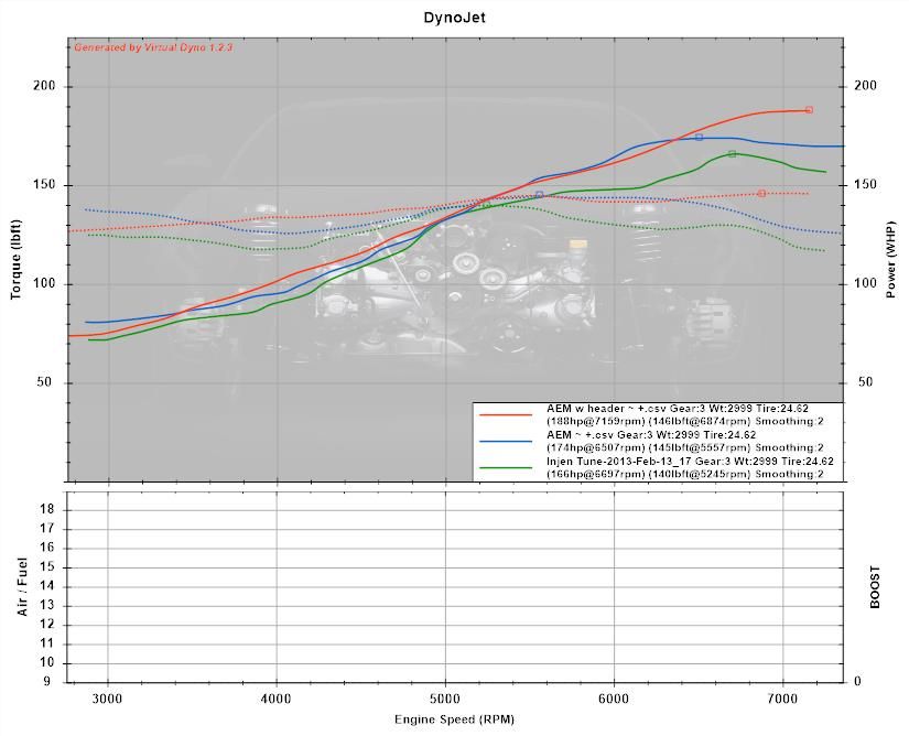

Here is a comparisson with those and the green line which was just the AEM intake running a injen unichip map:

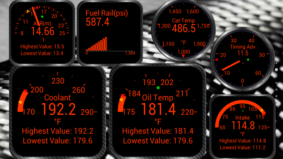

Here's my Torque layout. I just figured out how to add oil temp, so I'll be putting that on there!
Oil Temp working!:
