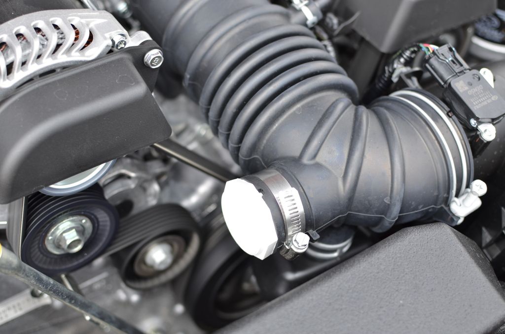

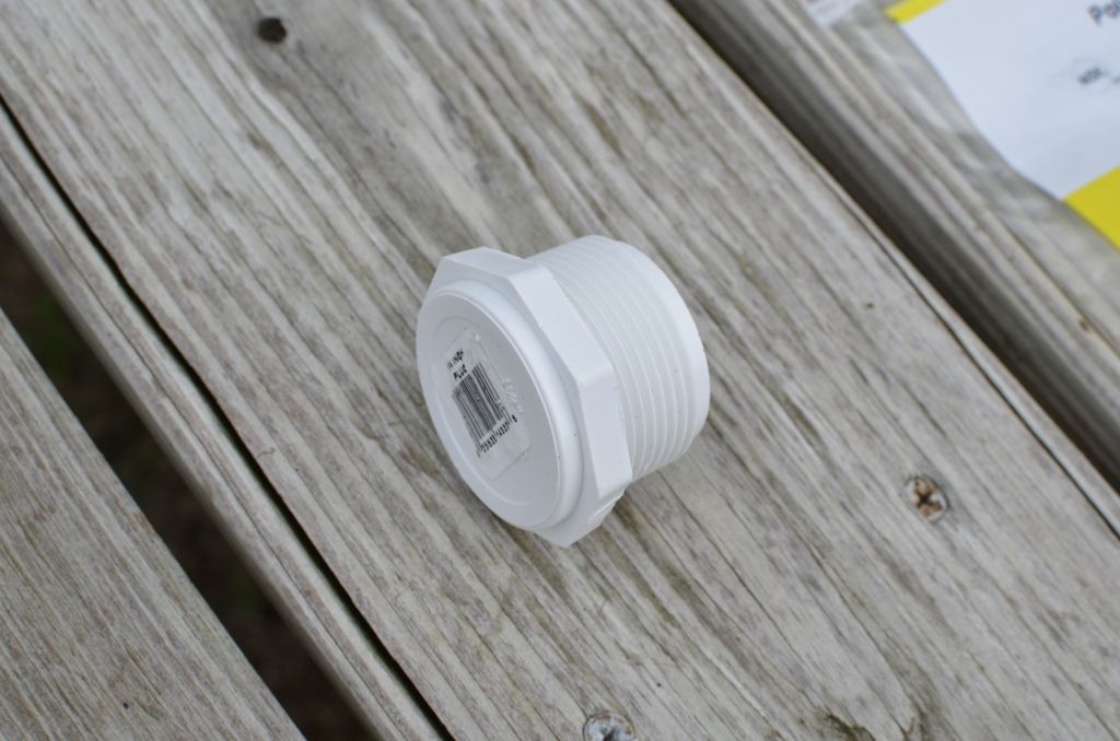

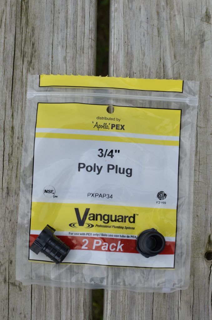

I recently did this delete. Went to Lowes and spent a few bucks. One is a 1.25 inch PVC cap. Use this to delete the sound tube from the main intake. The next is a 3/4" plastic cap. I found this a few aisles down from the PVC aisle with some brass fittings and what not. I just shoved this in from the engine bay through foot-well hole. It may seem a little big, but it fits right in. All together it's cheap, less than $4 and works. Sorry for the over exposed white cap.
