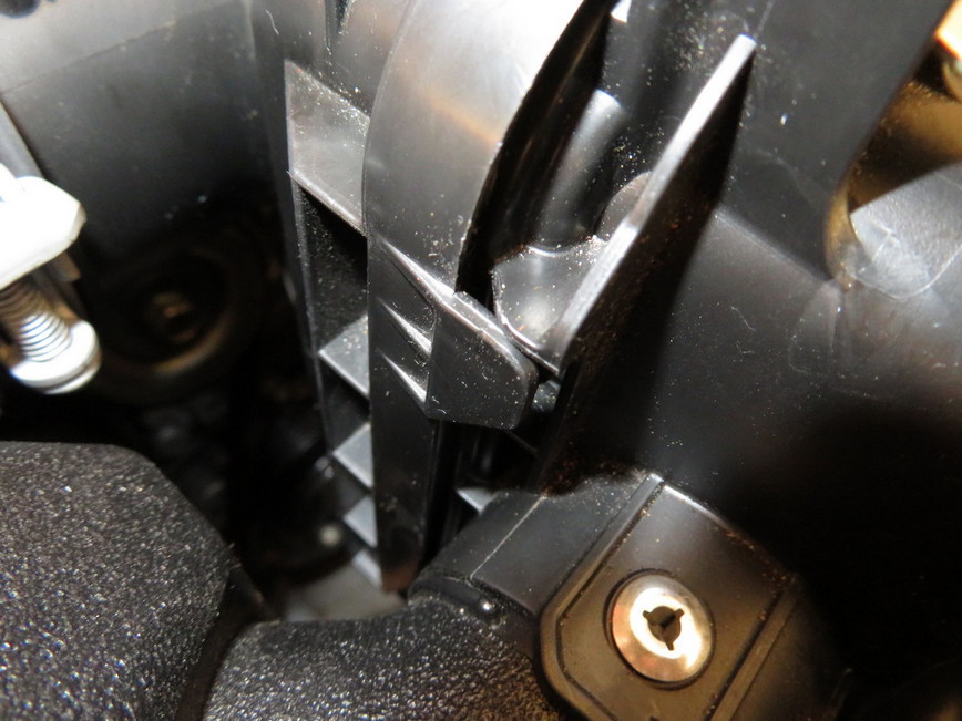

Closer look at left side tab after installation

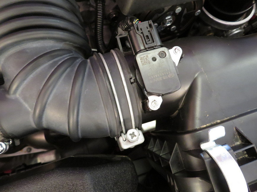

Check that the main intake air hose is secure. After installing the air filter mine had slipped off ~1/2".
