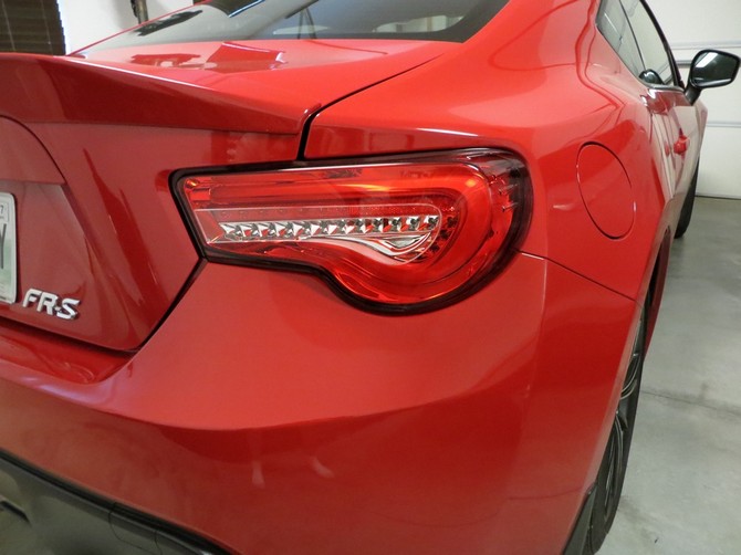

Installed my Valenti Red/chrome Sequential signal mode tail lights.
Got them from TheSpeedLine, aka nabobery on eBay, for $245.99 shipped from Taiwan. Fast shipping, got them 7 days after I placed the order.
http://www.ebay.com/itm/151996754985...%3AMEBIDX%3AIT
There was some doubt whether TheSpeedLine was selling authentic Valentis. IMO, I think they are genuine but gray market since TheSpeedLine provides their own warranty.
Install instructions, took me about 1 hour to install them. Only took the 3 push pin fastners off the rear side panel and bent the panel back enough to access the bolts.
My cheapo Harbor Freight in. lb torque wrench. Used a 1/4" to 3/8" adapter and a deep well 8mm socket. Torqued bolts to 39 in. lb.
Red on red with a little chrome, IMO, looks good.
