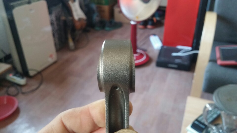

One thing I have missed is thr tapered small end of stock rods and matched stock piston pin area.

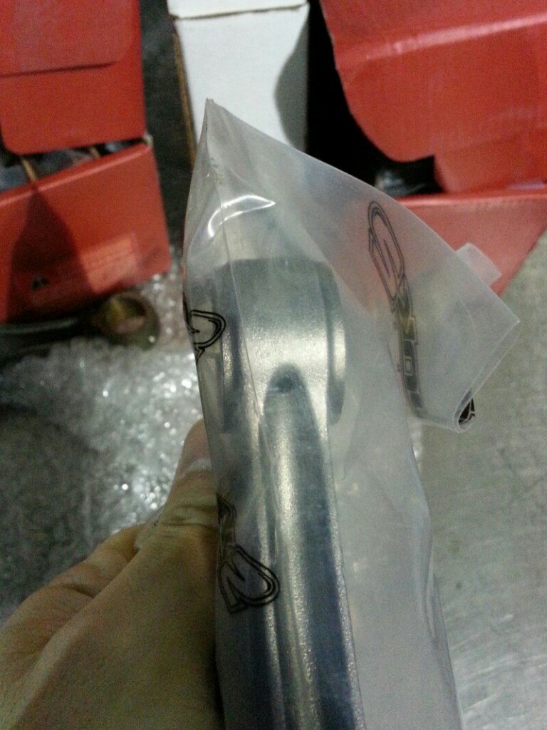

But Skunk2 rods have this shape.
So I have to go to the machine shop to match the stock pistons.
