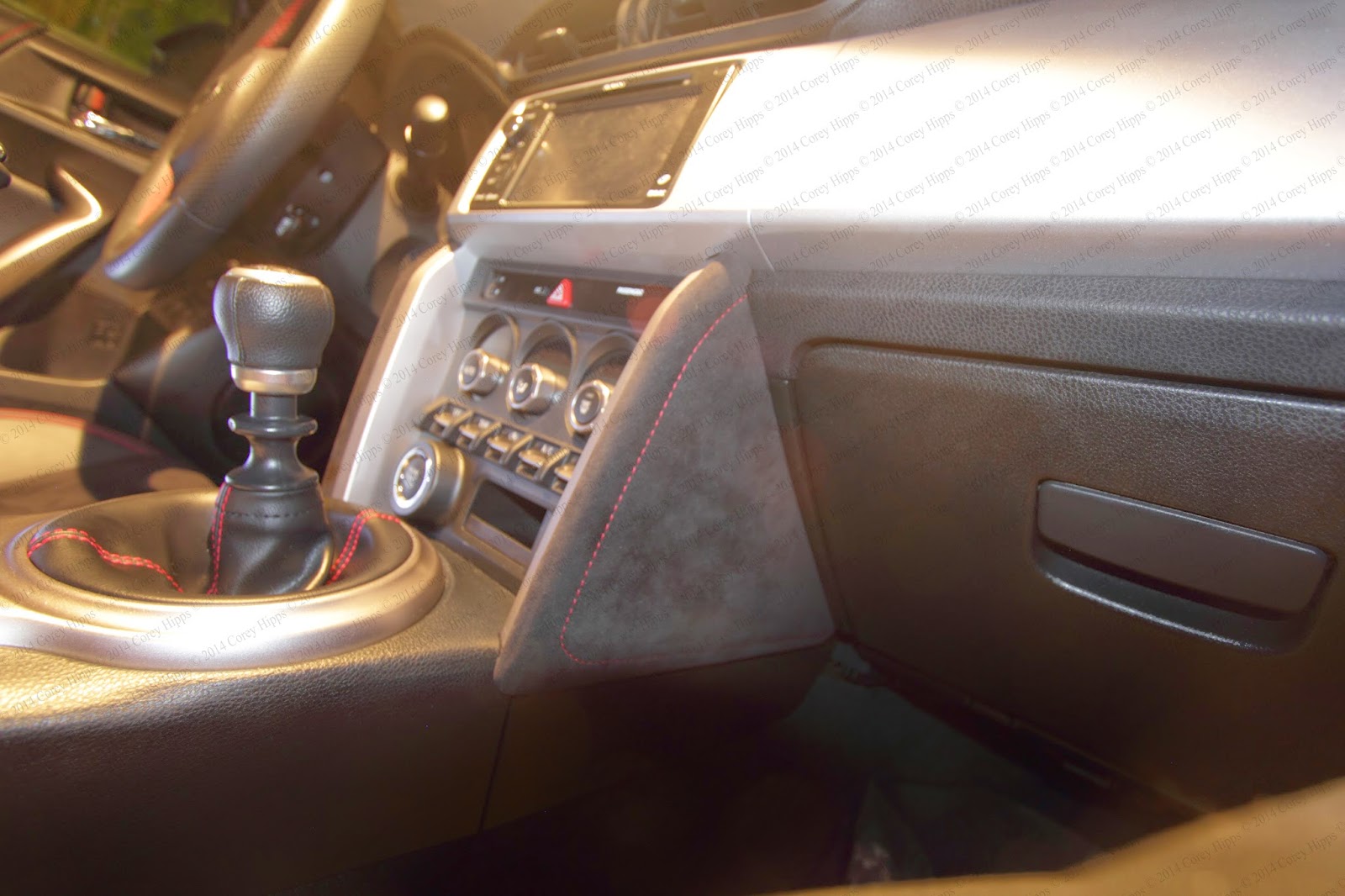

Cagalli Yula, my 2014 Subaru BRZ Limited, has one really annoying feature when you drive for long distances, especially if using cruise control. The knee pads where the dash and center console meet are hard plastic with very little give. If you're like me and you rest you knee against it, especially on long road trips while using cruise control, this is very uncomfortable.
Enter JPM Coachworks. They produce knee pads for the Subaru BRZ / Scion FR-S / Toyota GT86 that are padded and come in optional leather or Alcantara with red stitching (which matches the seats). Also, apparently padded leather knee pads are either an option or standard in Japan.

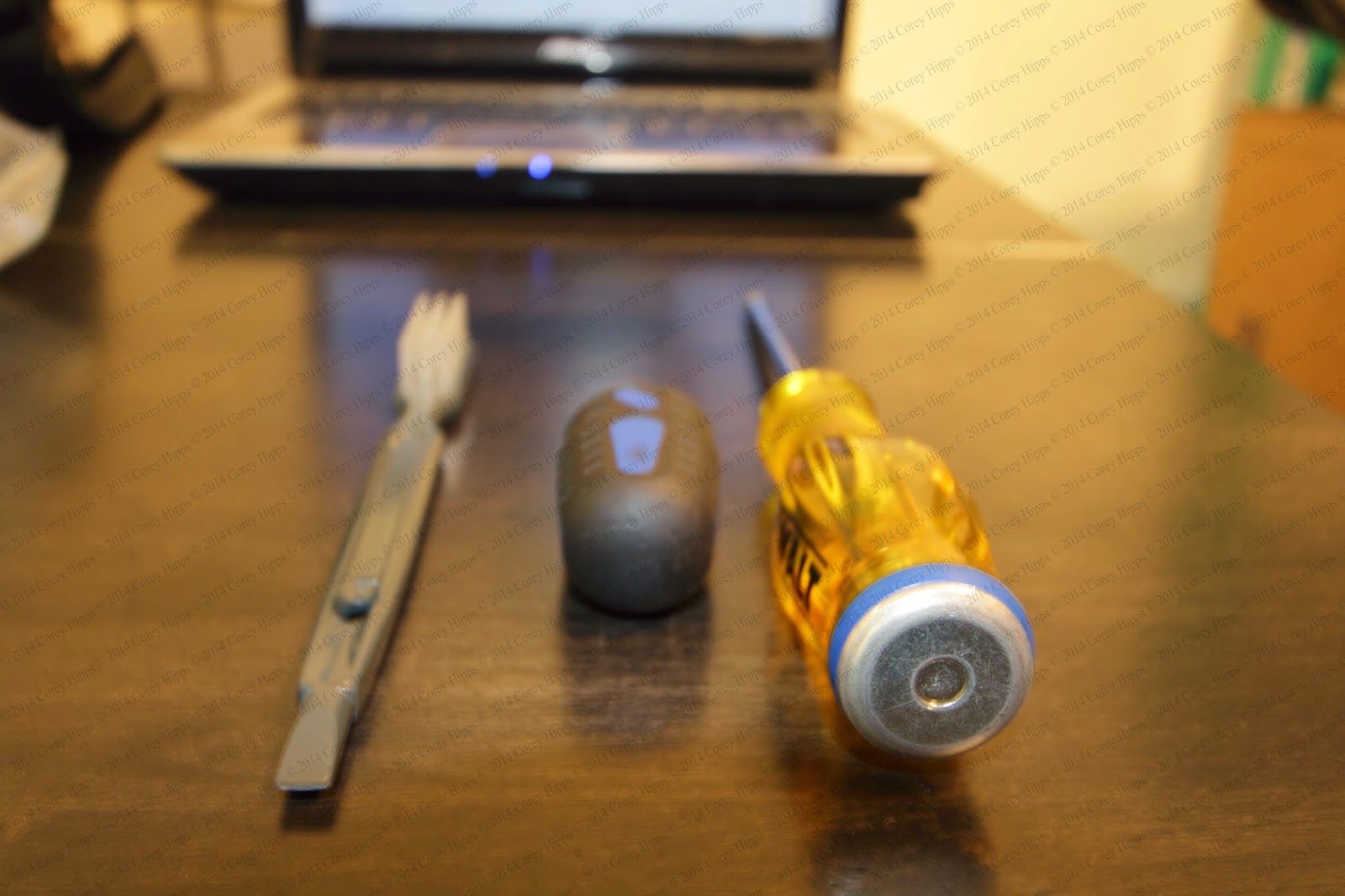

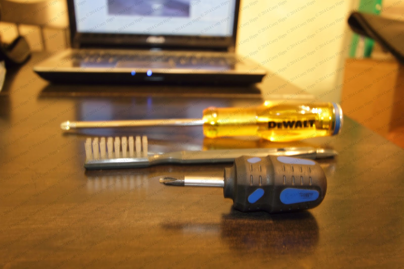

First, tools:
1) Long Philips screwdriver
2) Short Philips screwdriver (with magnetic tip)
3) Tough plastic wedge (this will be important for some plastic removal)

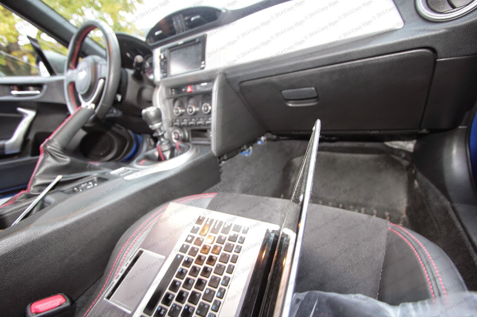

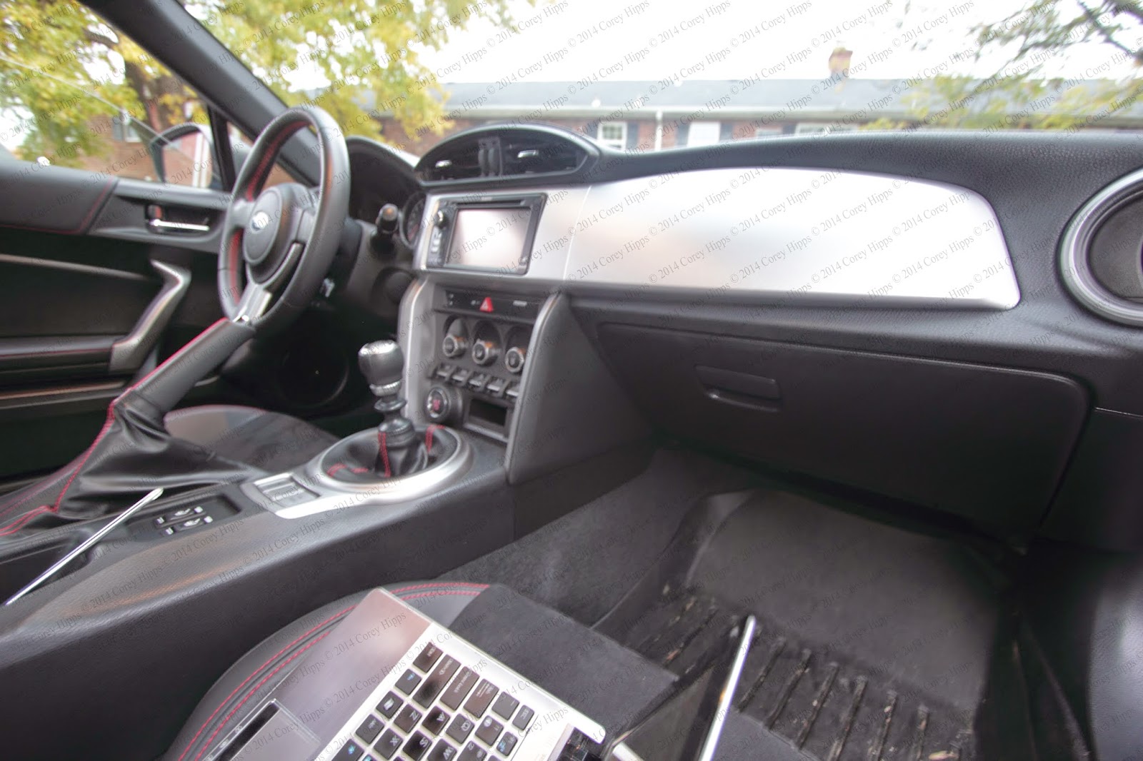

Here's what it looks like when you start.

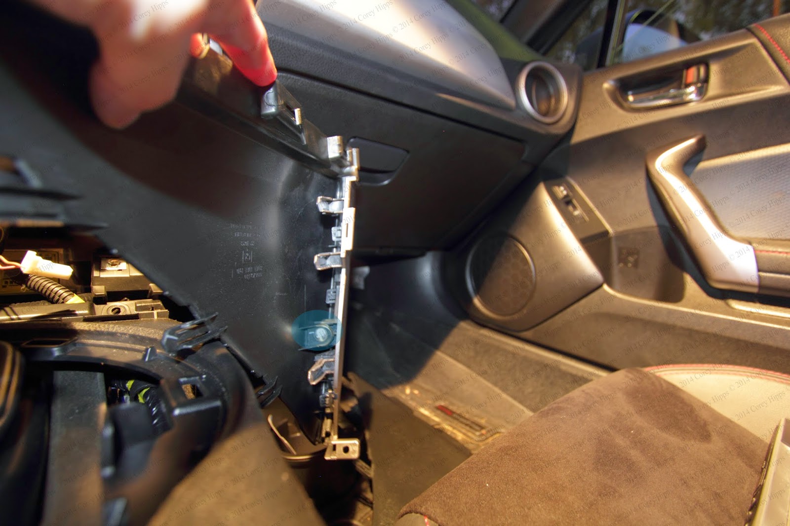

The first panel you remove is the plastic panel underneath the knee pad.
Put your finger beneath the panel and gently pull, the plastic clips should pop right out.
Repeat the process on the passenger side.

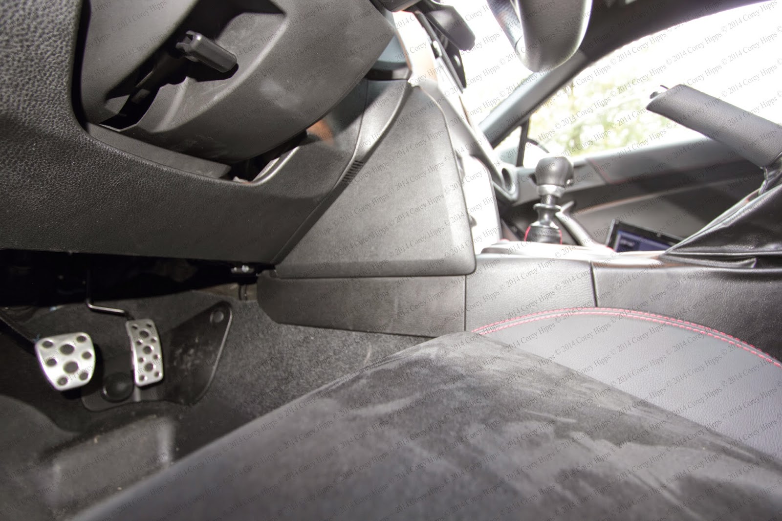

Plastic panels removed.
This is what you're left with on the driver side.
This is the passenger side.

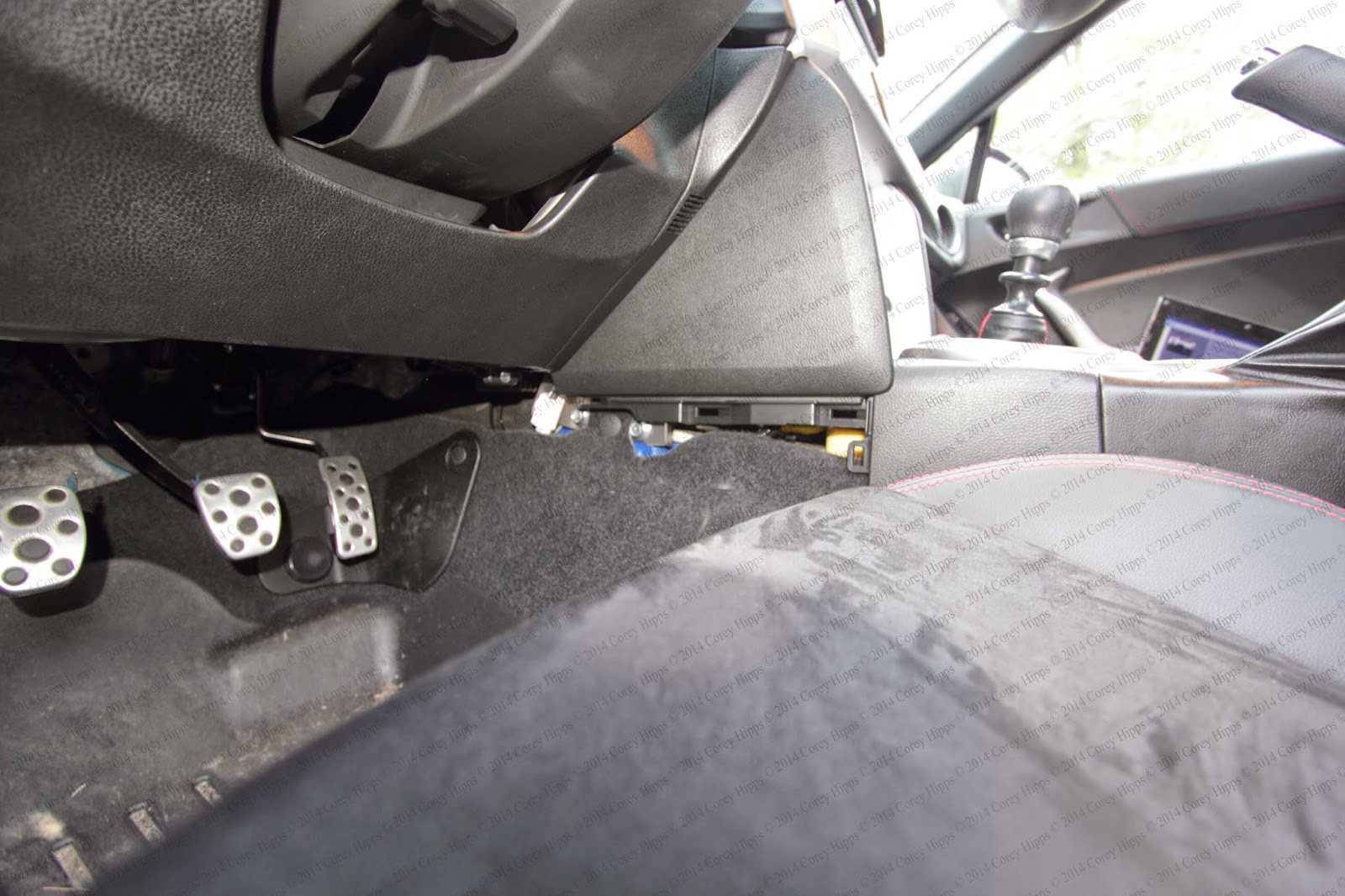

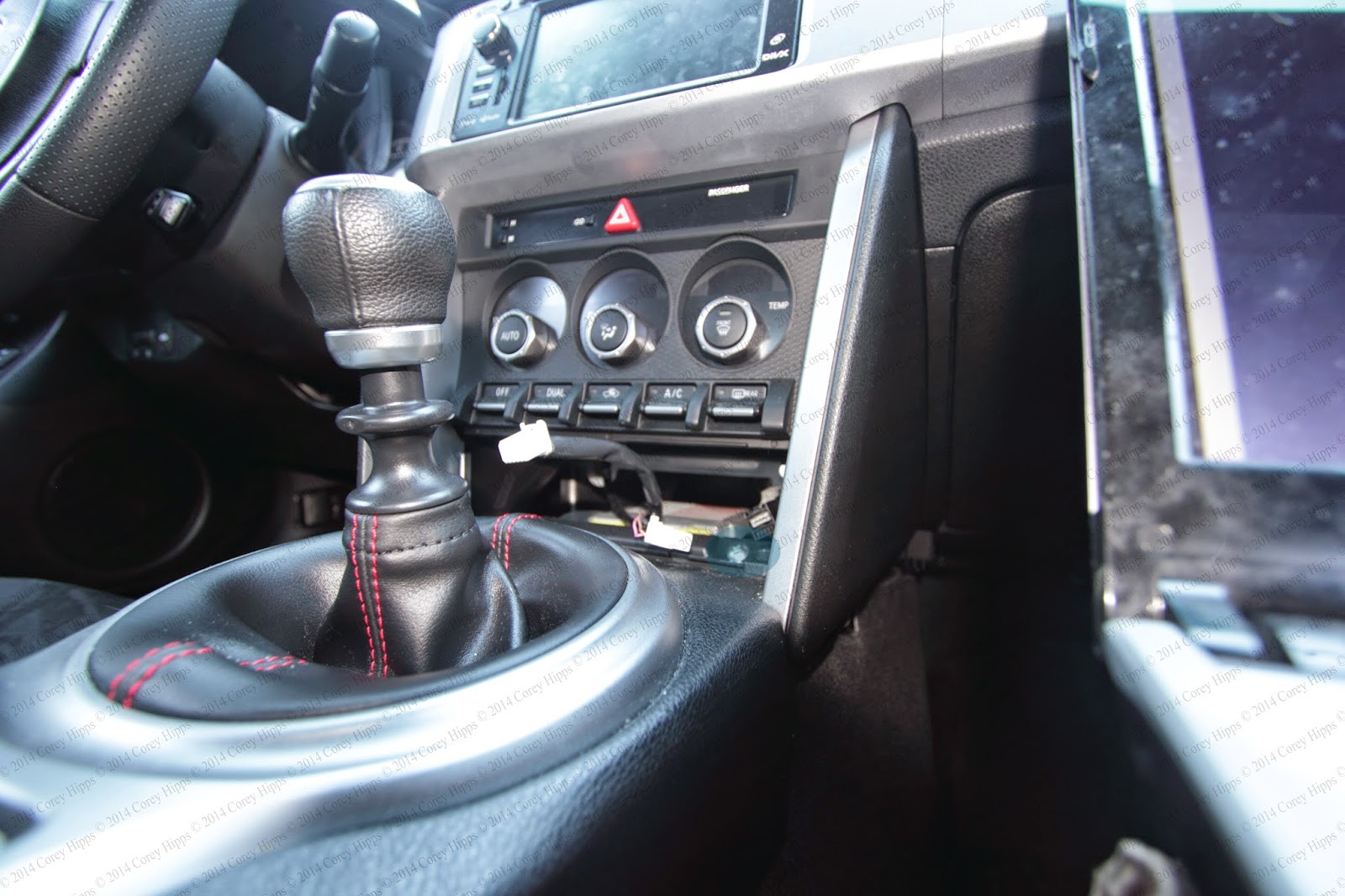

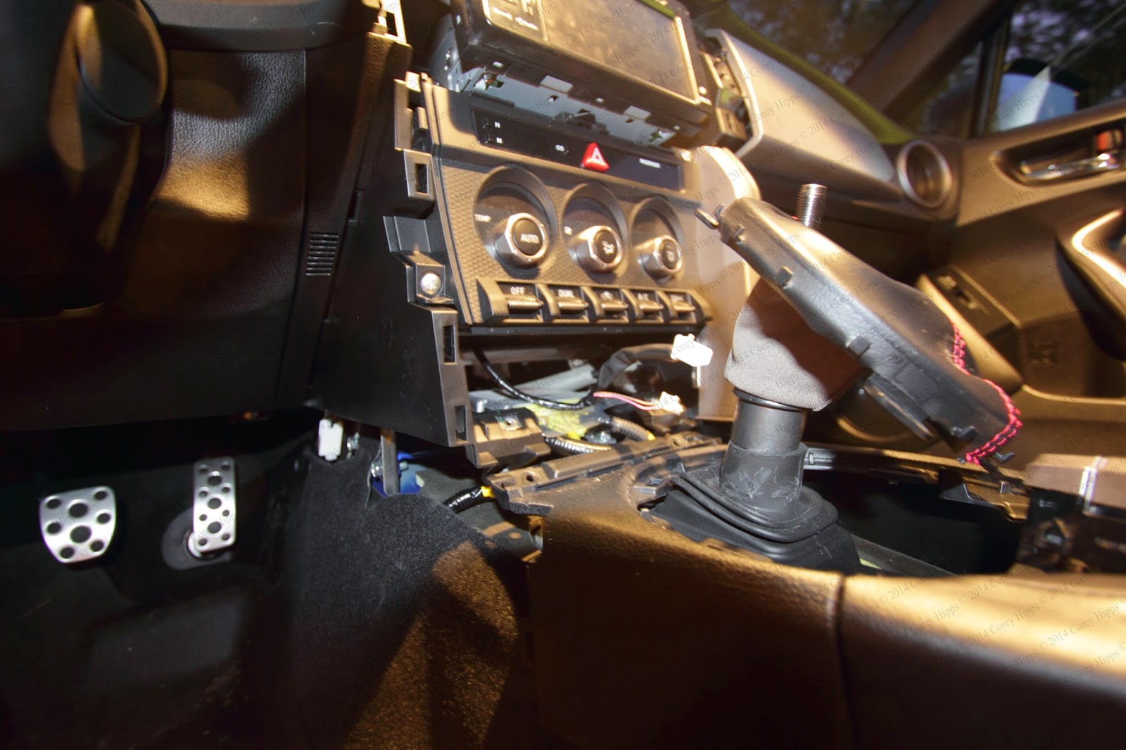

Next you need to remove the bottom panel (below the HVAC controls).
To do so I found it easiest to reach in from the passenger side where the plastic panel used to be and to push the USB / AUX connector out, then disconnect the electrical connector.
I then used my long screwdriver through the hole to pry the right side clips undone.
Once I had it partially unclipped I just worked my way right to left by hand.
It took some force, not too much, and no clips damaged.
Once you have it out you'll need to unplug both the start button and the antenna.
The antenna is mounted on the back of the pocket.
You can skip this step if you don't have keyless entry / push button start.

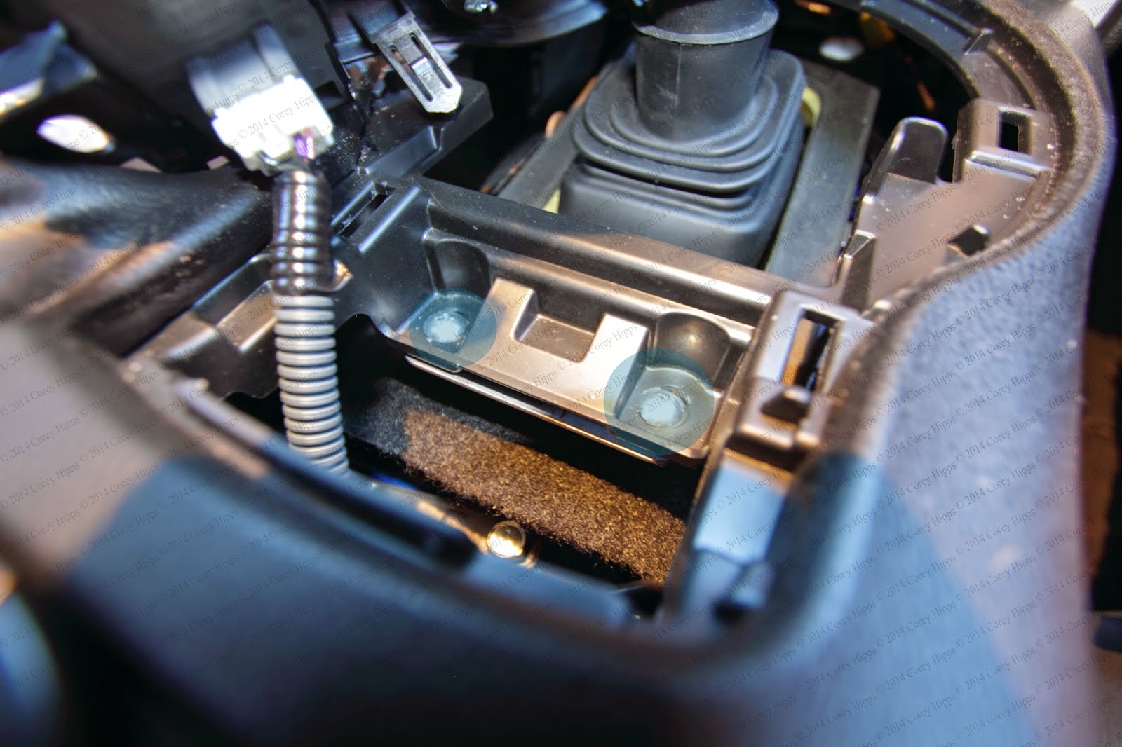

Removing the bottom section reveals two screws.
One on each side.
The screw is highlighted in blue below.
I also suggest using the cup holder tray as a screw sorter while you work.

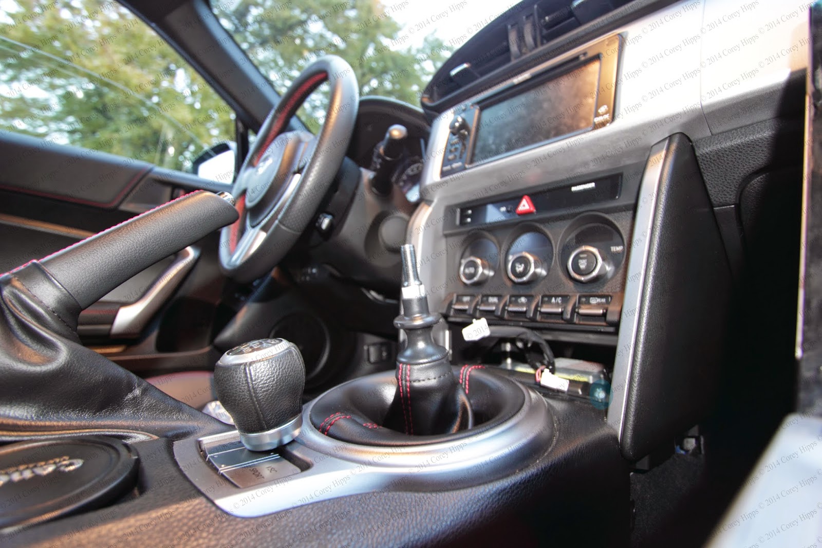

I removed the shift knob, this was probably not necessary.
Again, screw to remove highlighted in blue, also there is a corresponding one on the driver side.
You do need to at least lift up the shift boot and its plastic molding.
Two do so I suggest hooking your thumb under the plastic molding closest to the dash and then pulling up to undo the front clip. Then work your way around.
Keep in mind that the rear of the trim (behind the buttons) has a tongue on it and needs to be slid forwards.
Removing the shift boot trip piece reveals two more screws that need to be removed (highlighted in blue).
Also while some articles I read suggested unscrewing the shift boot retainer from the trim I think this was unnecessary, though it is convenient in getting the plastic our of the way.
More importantly I would unscrew the VSC Sport and Traction Control Off buttons from the trim which will allow you to lift the whole thing up and invert the shift boot.

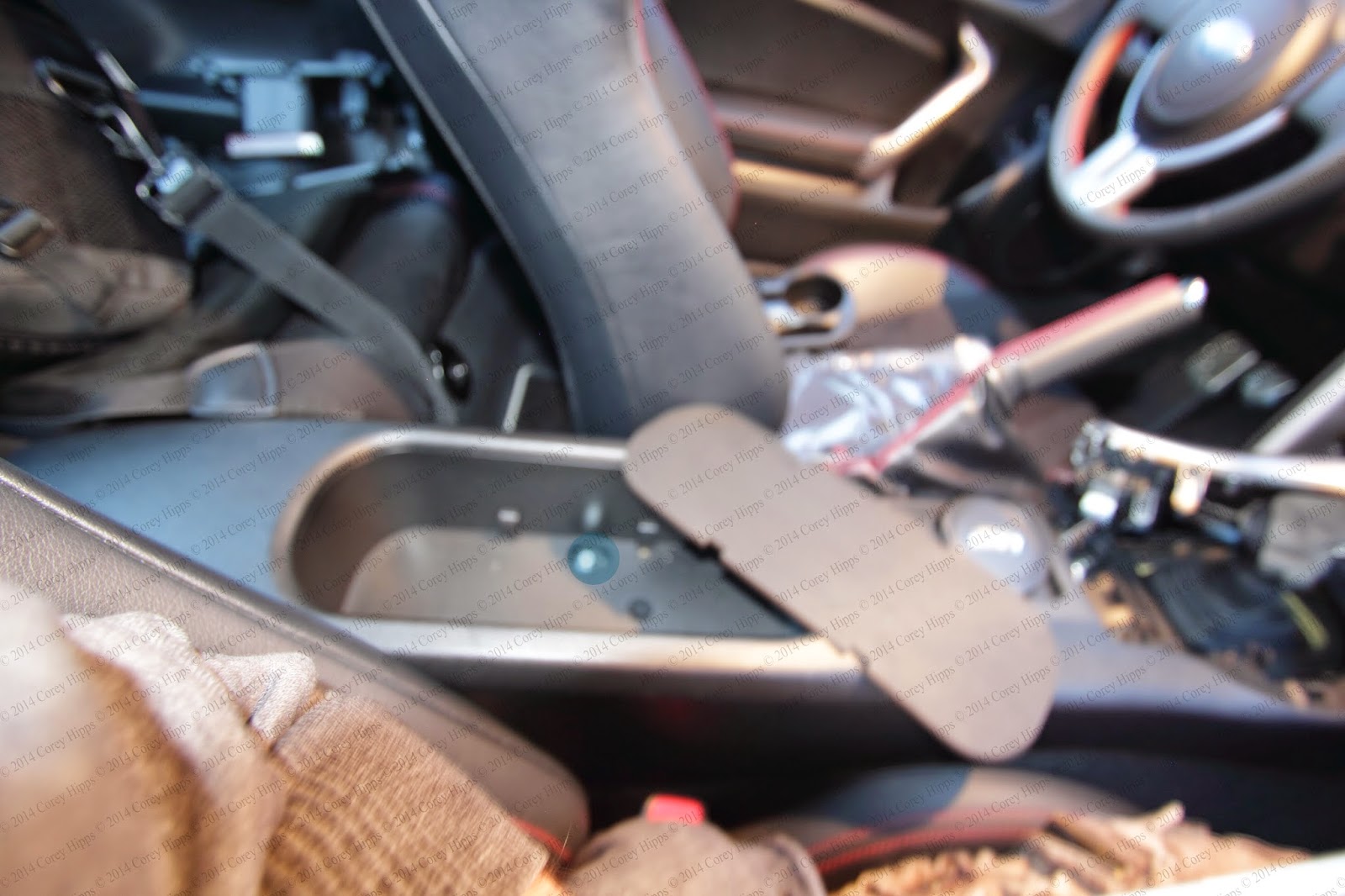

Next you will want to use your plastic wedge to remove the rubber pad from the center console revealing another two screws (one driver side highlighted in blue, one passenger side not shown).

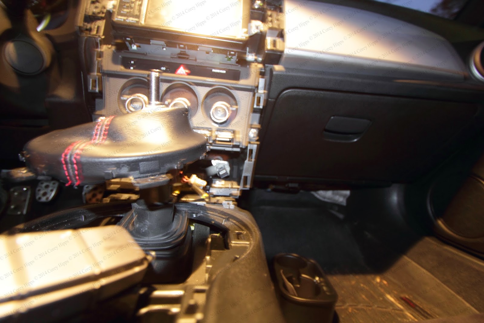

Once all six screws are undone (two by the dash, two by the shifter, and two by the cup holder section of the center console) you can now lift and push the center console back.

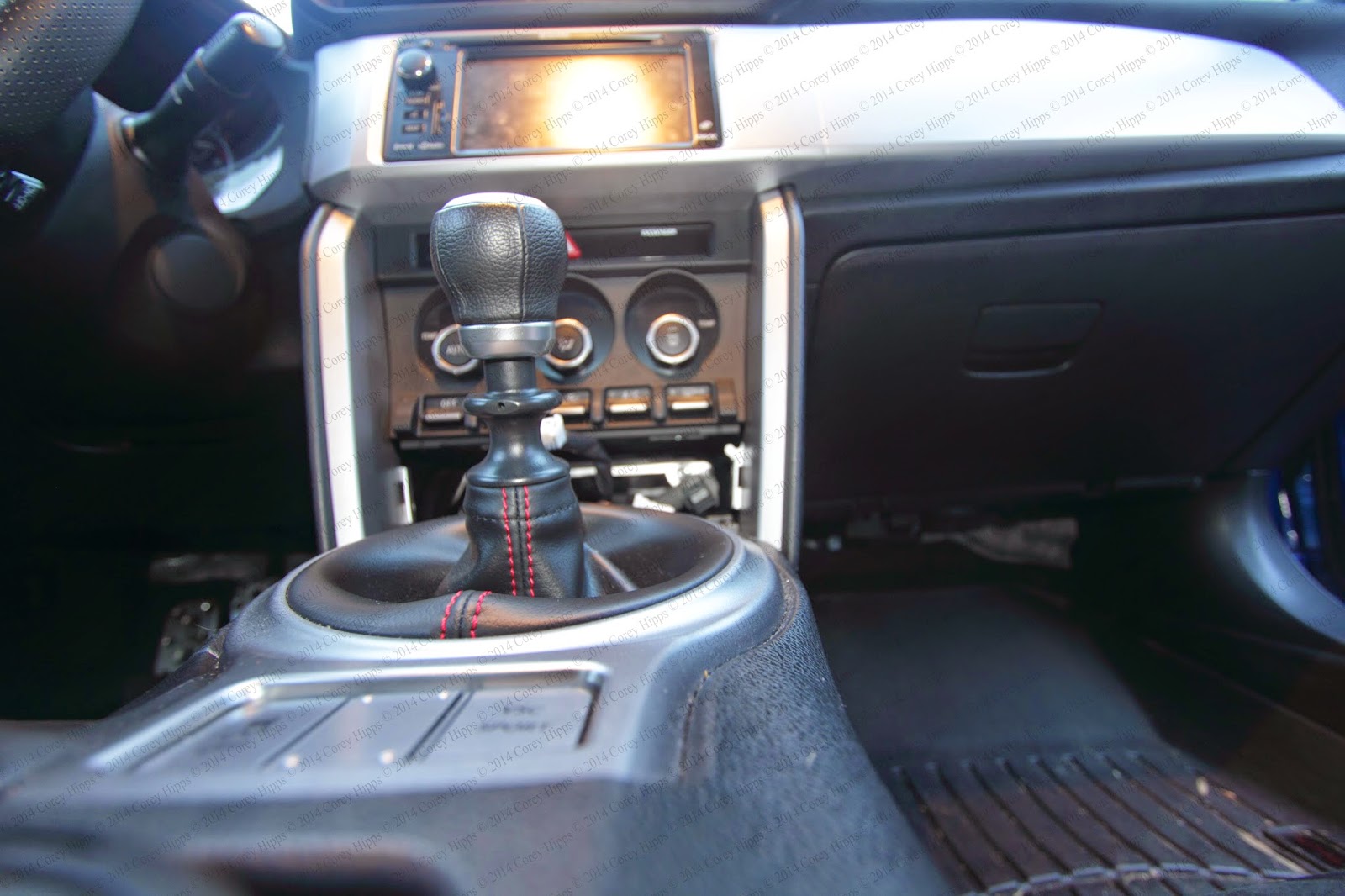

Next you need to remove the bezel around your infotainment system.
I suggest inserting your tough plastic wedge on the passenger side where the two panels and the knee pad meet.
Pop the first clip then go around the bezel gently pulling the other the clips out.
This reveals the final two screw (highlighted in blue) that you need to remove.

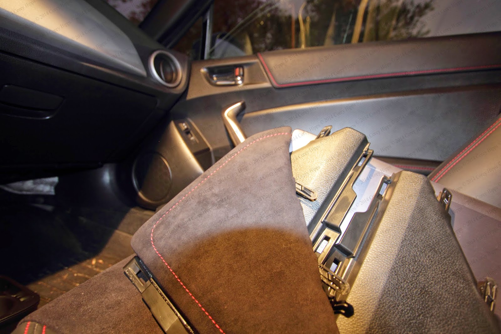

Undo the screw at the top of the knee pad.
I suggest pulling with one hand at about the center of the knee pad grey / silver piece and using a hand at the bottom to pull and disengage the clips.
Remember to keep the center console slid back so that the overhangs on the knee pads do not catch on the center console.
Once the knee pad is out you need to undo the screw (highlighted in blue) behind the grey / silver plastic piece.
Then unclip the three clips holding the grey / silver piece and the knee pad together.
Now clip the new knee pad tot he grey / silver plastic piece.
Screw the screw back in.
The assembled knee pad has three black clips that go into notches in the foot wells and has three clips that go in notches on the columns next to the HVAC and infotainment system.
It takes a bit of force to get back in, don't use too much though as you might damage a clip.
The reinstall is a bit awkward because you need to push it toward the center in order to get the clips on the grey / silver part pushed in.
Also you NEED to keep the center console pushed back while you do this or the bottom of the knee pad and the center console will push against other making your life difficult.
Another option is, before you unscrew the center console to pull the parking brake boot off from the center console which may allow more movement of the center console, or its complete removal with a few additional electrical disconnects (for the heated seat controls).
